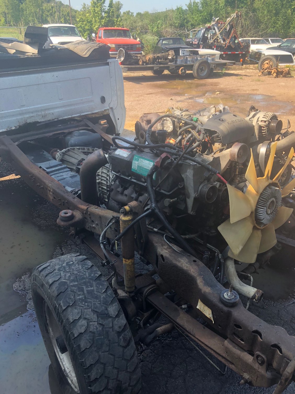

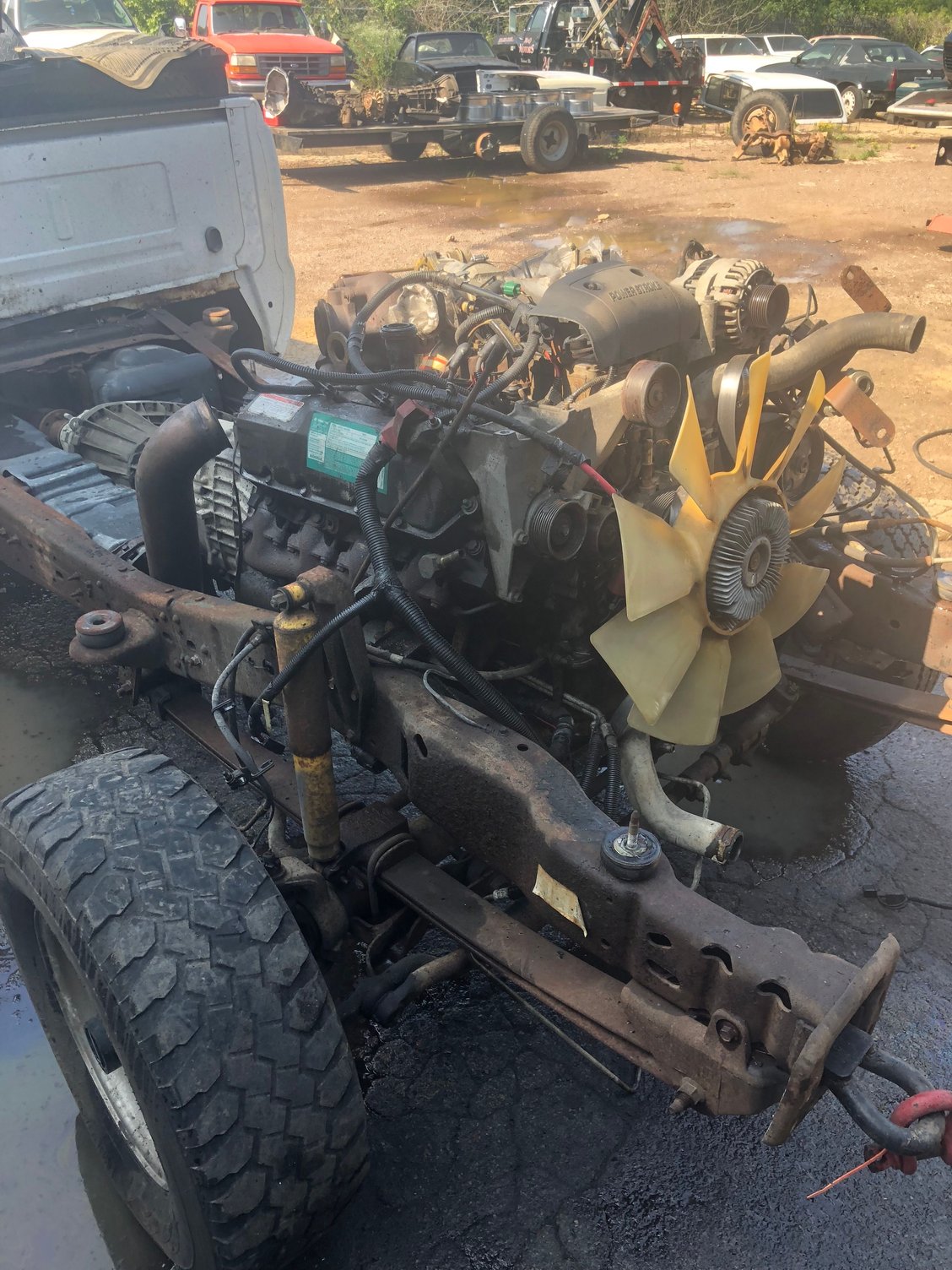

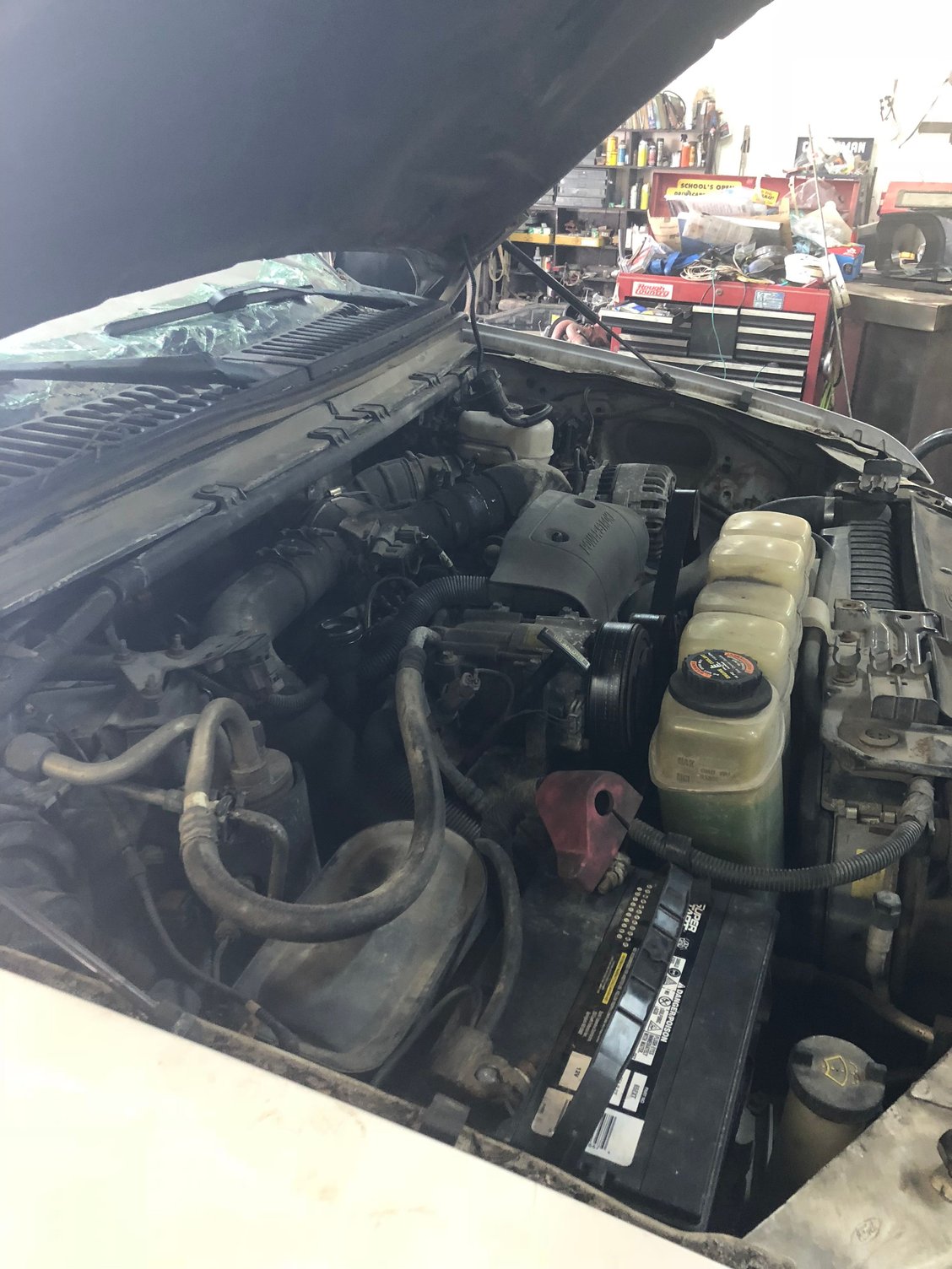

Yeah the rest of the windshield is as clear as air lol. But we did get cab pulled last night I’ll get some pics posted soon and give some directions on how atleast I go about lifting a cab.

Now as far as removing cab how I like to do it is remove radiator and fan shroud then disconnect batterie cables from body and lay them over the motor. Then I disconnect the abs module and unbolt it and the hydro booster and master cylinder and lay them over motor. Then disconnect map sensor lay on top of Motor also don’t forget heater hoses. Then the steering shaft from steering box. Don’t forget the cab and core support bolts along with the ebrake cable and trans wires and depending on if it’s manual or auto the shifter or shifter cable. I’m sure it seems like a lot but it’s very simple with a lift also don’t forget the intercooler tubes. But to me way simpler than pulling out front but guess that’s personal preference. But I’ll try to get better pics when I pull the rollback apart. I’ll definitely get pics of installing parts on motor when they come in.

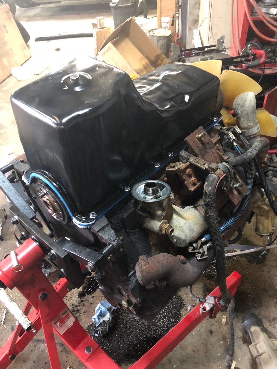

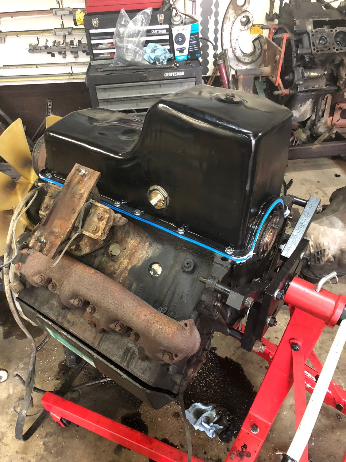

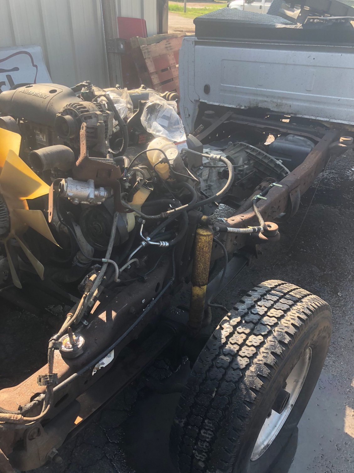

W​​​​​​ell I know I’ve been scrase but I’ve been busy which is a good thing but the oil pan was on back order. So I just pulled one off one of my parts motors and bought new dipstick adapter. Got it all painted up and installed on the motor. Also got the turbo rebuilt half to plug up ebpv hole in turbo outlets and gut and tap and plug turbo pedestal. I’ll get pics of all that and removing cab on truck when we start

Halfway through reading I was like, "I should ask for pics.." then I finished. Haha. Can't wait to see it!

Old Aug 29, 2018 | 02:32 PM
  #45
Glowplugger's Avatar
Glowplugger
Joined: Jan 2015
Posts: 820
From: Central OK
Lookin' sharp!
