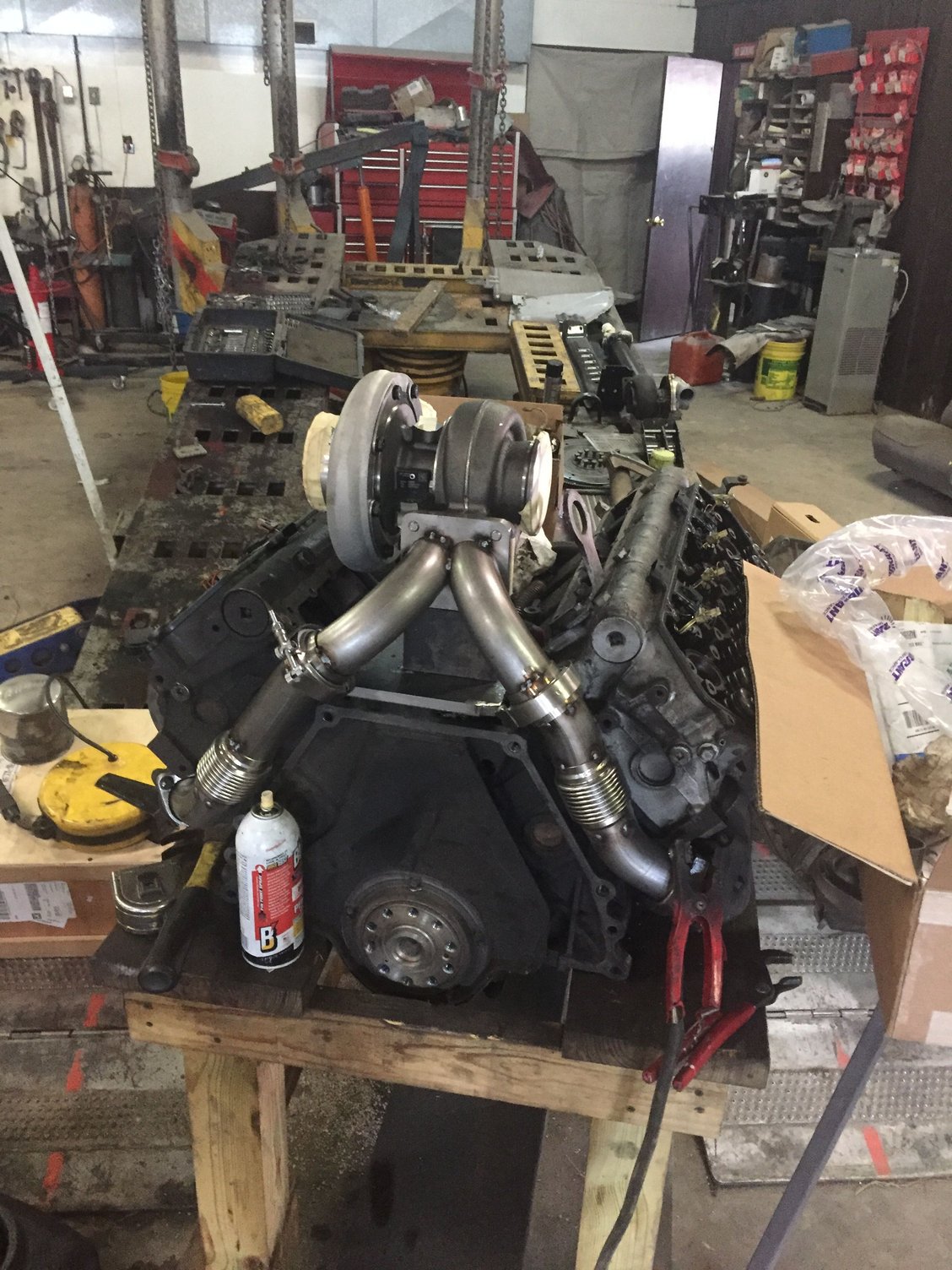

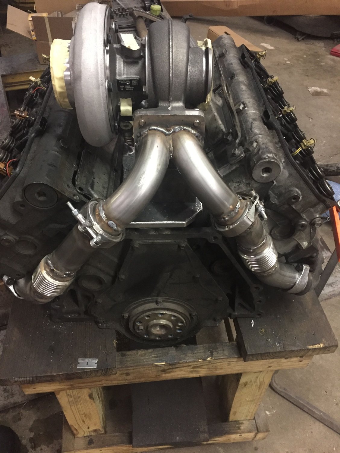

Well just thought I’d post some pics of the t4 mount I built the beginning of the year plan on building similar setup for this truck except where probably just gonna run a s366
