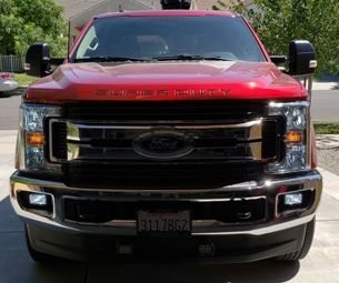

Did the full Beamtech treatment today. The fog lights took all of 10 minutes to swap out. Most of that was trying to figure out the indexing of the new bulb. The second one went a lot easier. I tried to remove the bulbs by pulling just the snorkel and windshield wiper fluid filler tube, but I couldn't, for the life of me, get the factory bulbs to break free. I ended up going the old school route and pulled the grille and the light housings. Still had to use a pair of channel locks to break the top one on the driver's side loose. Everything else went fairly easy. Took me a little over an hour to get it done, but I also did some cleaning while I had everything torn apart.
Now it looks like a modern truck. I'm happy with the outcome. Got the bulbs off of eBay for under $100 bucks, so that was even better! Thank you all for figuring this out and finding decent, economical bulbs.
