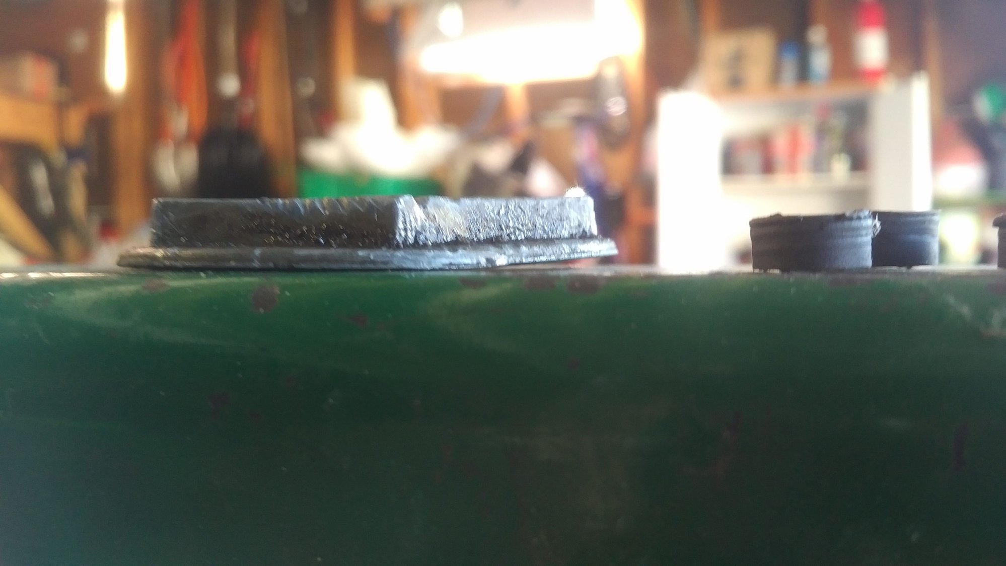

Originally Posted by brandon_oma#692
yep. Just got back from taking my truck to get oil for her van. Not leaking. Added rtv because it can't hurt and thought it might help it from ever coming loose. My dad put it together. Figured I'd let him since he was offering. Also pictures of my old fuel sleeves I replaced. Big time pucker factor pulling out the dipstick tube with no nut on the flange.
