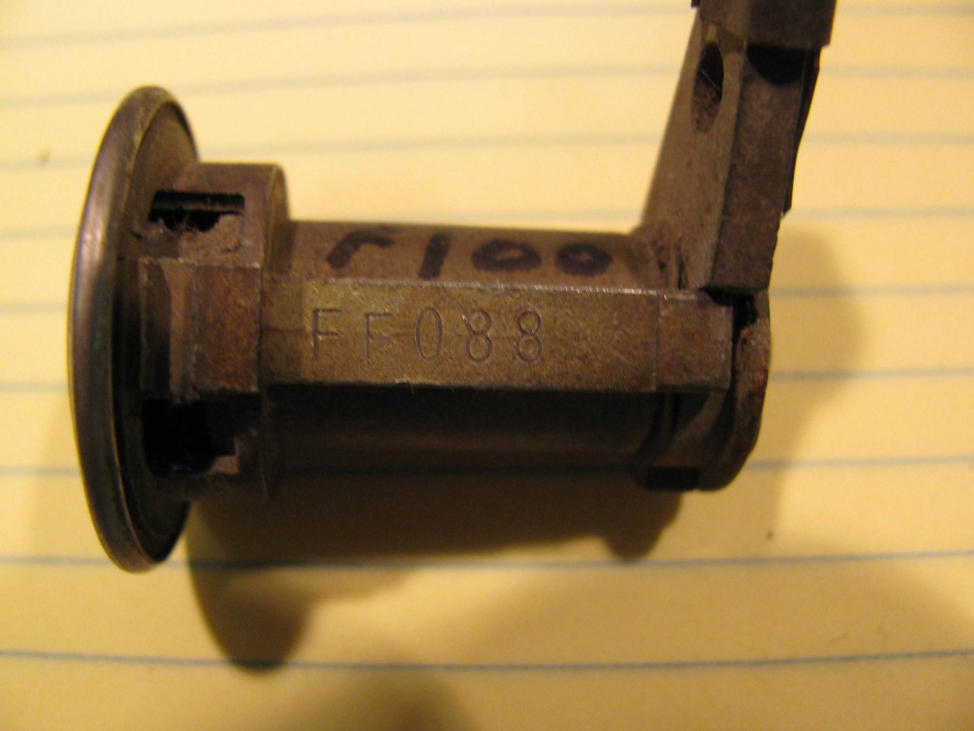

Or...give your old doorlock to a locksmith and ask him to make a key.

Lock cylinder
Absolutely the best way to do that if the locks still match. There is a number on the door lock that the locksmith can use to make a key. Take the one from the passenger side because that side doesn't get used much and is usually in good shape.
