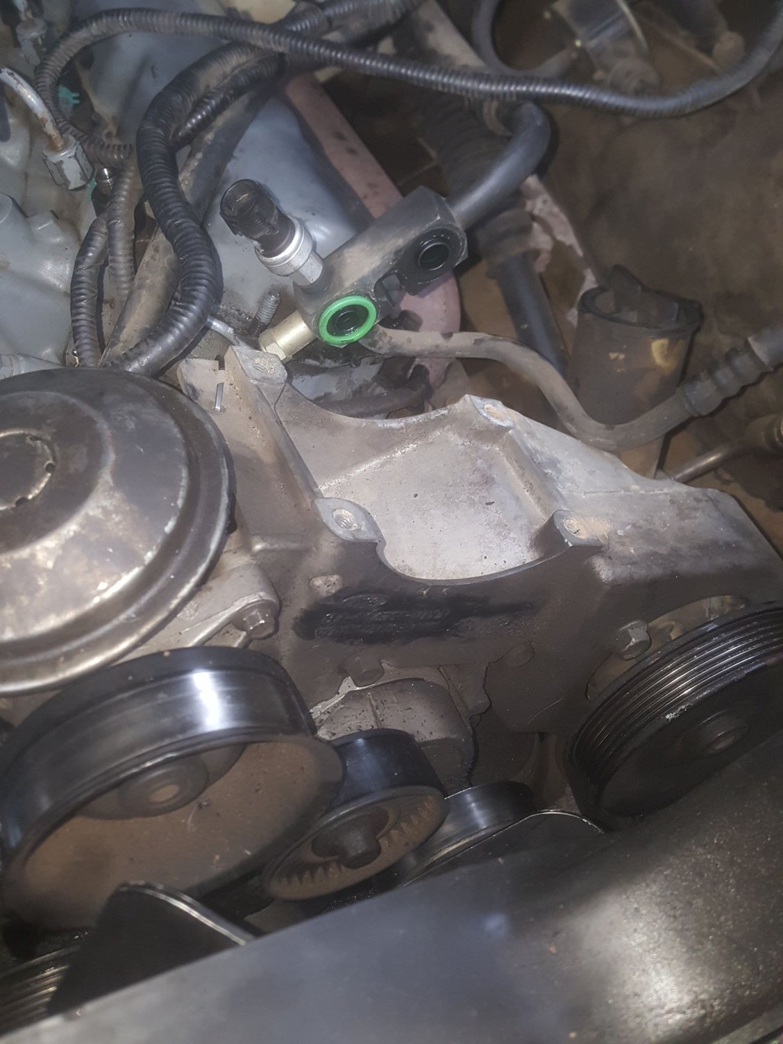

Started the tear down today got the altinator out the compressor out gpr and wiring harness cdr valve
tried to get the vacuum assembly?? Out but I don' have the right socket size I guess lol a question in have is do I need to take it off to get the heads out what about the pulley bracket that there all on?? ... just want to get this done as easy as possible lol
and about the injector pump I got little front plate off and I see the 3 12sided bolts and I see the 3 bolts on the other side of the front cover that the ip has just take all six off?? Or take front cover off and just Mark it since I am putting new heads on it
