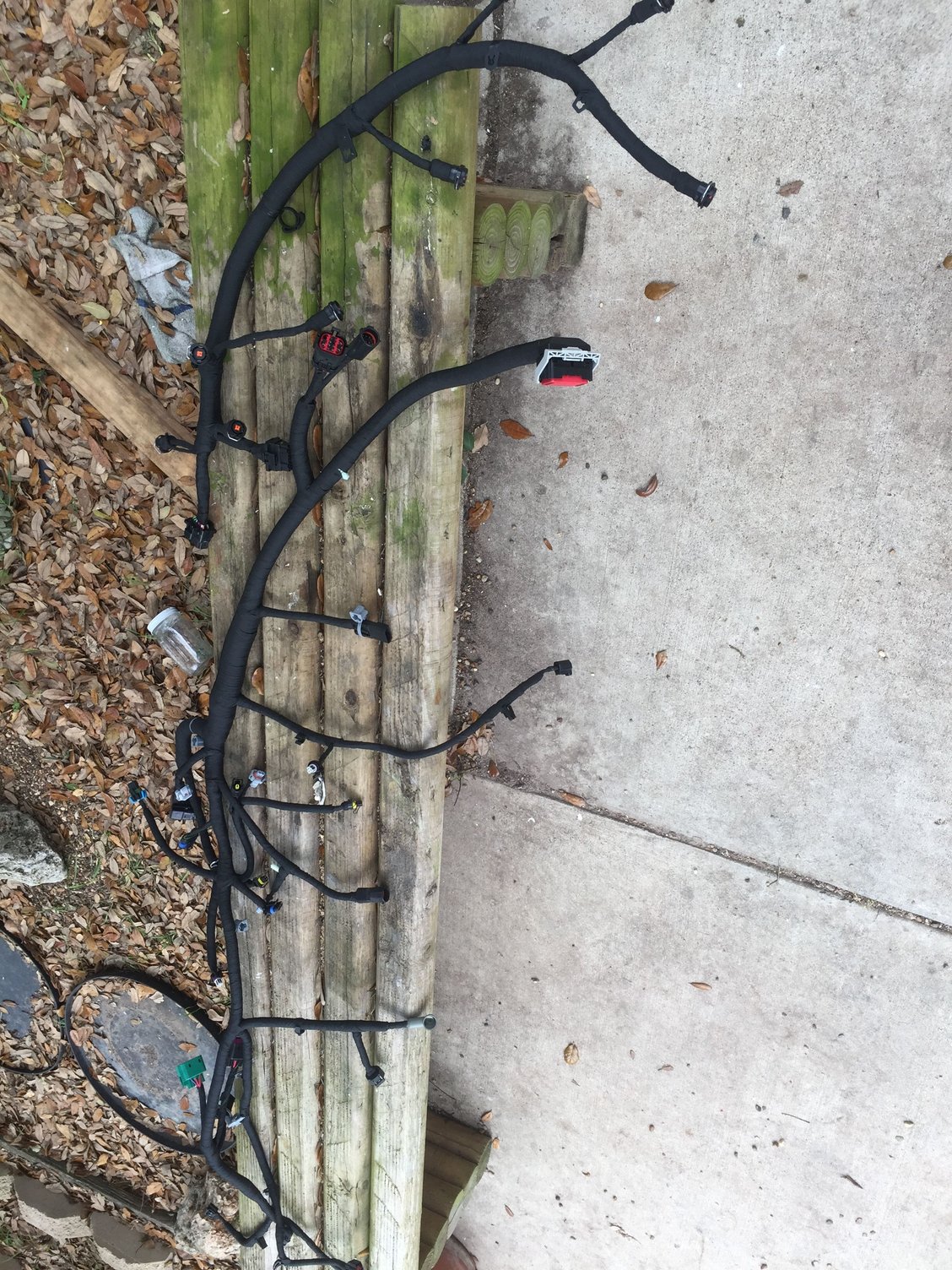

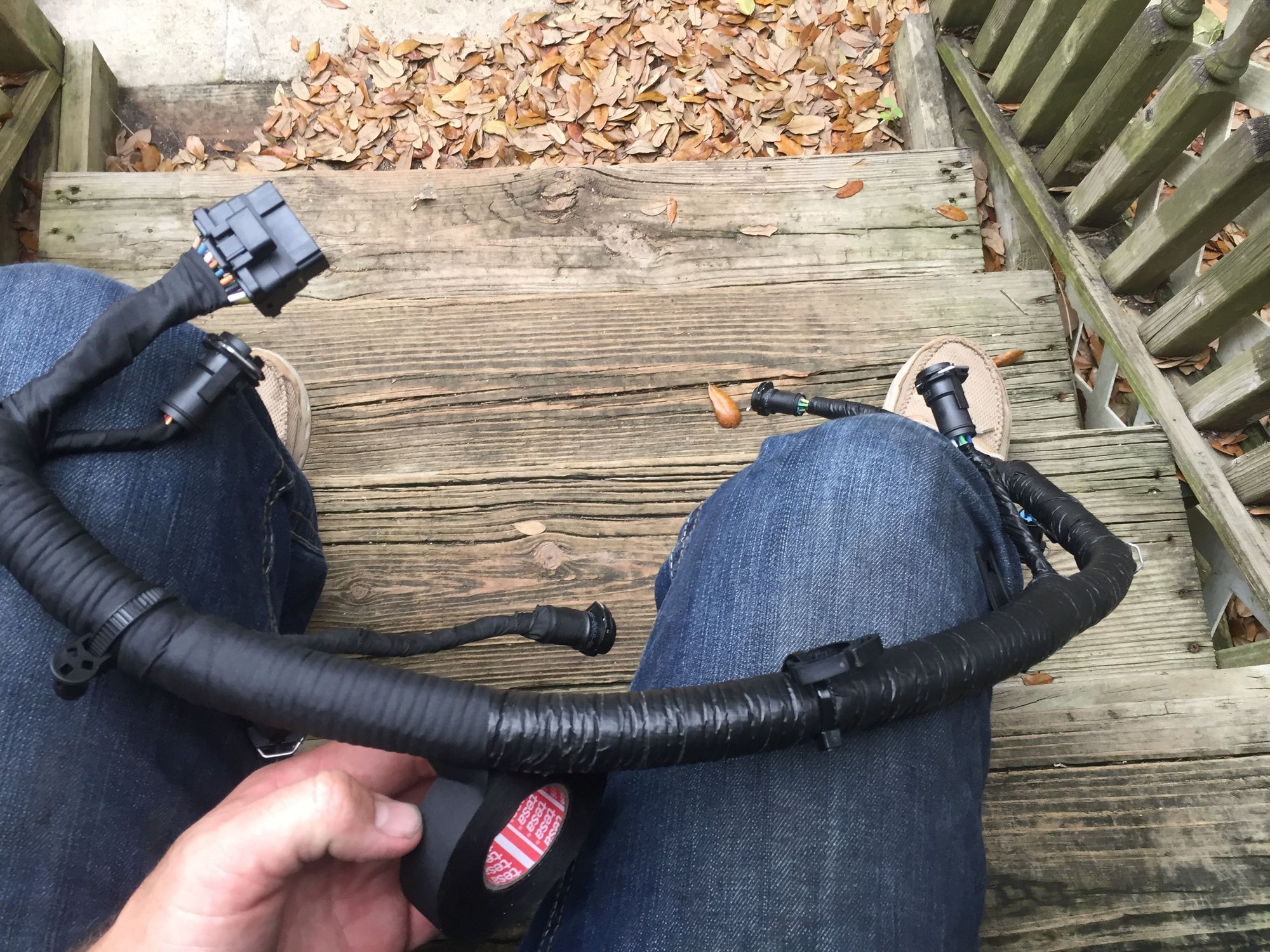

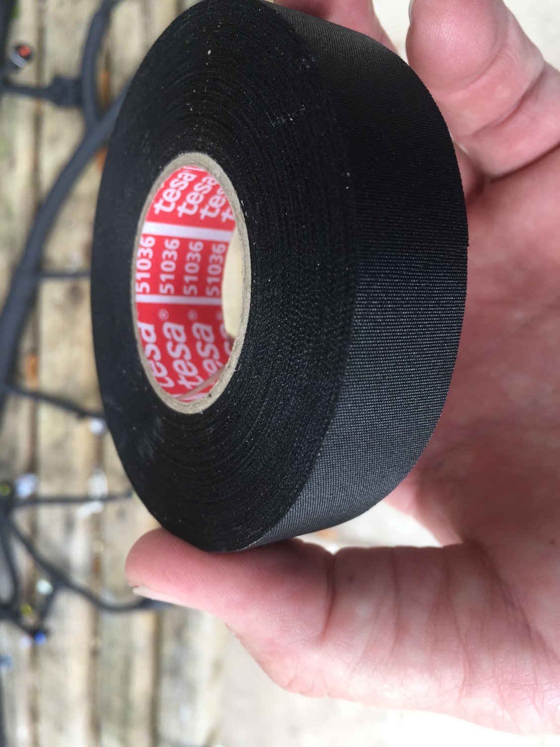

The tape I got off Amazon for about $4 per roll. I used three rolls.
I had some working room. I wasn’t about to put that ratty harness back in this pretty engine bay!
Wrap from the connectors inward and zip tie if you have to leave an end exposed so it won’t be able to start unravelling.
Engine harness done!

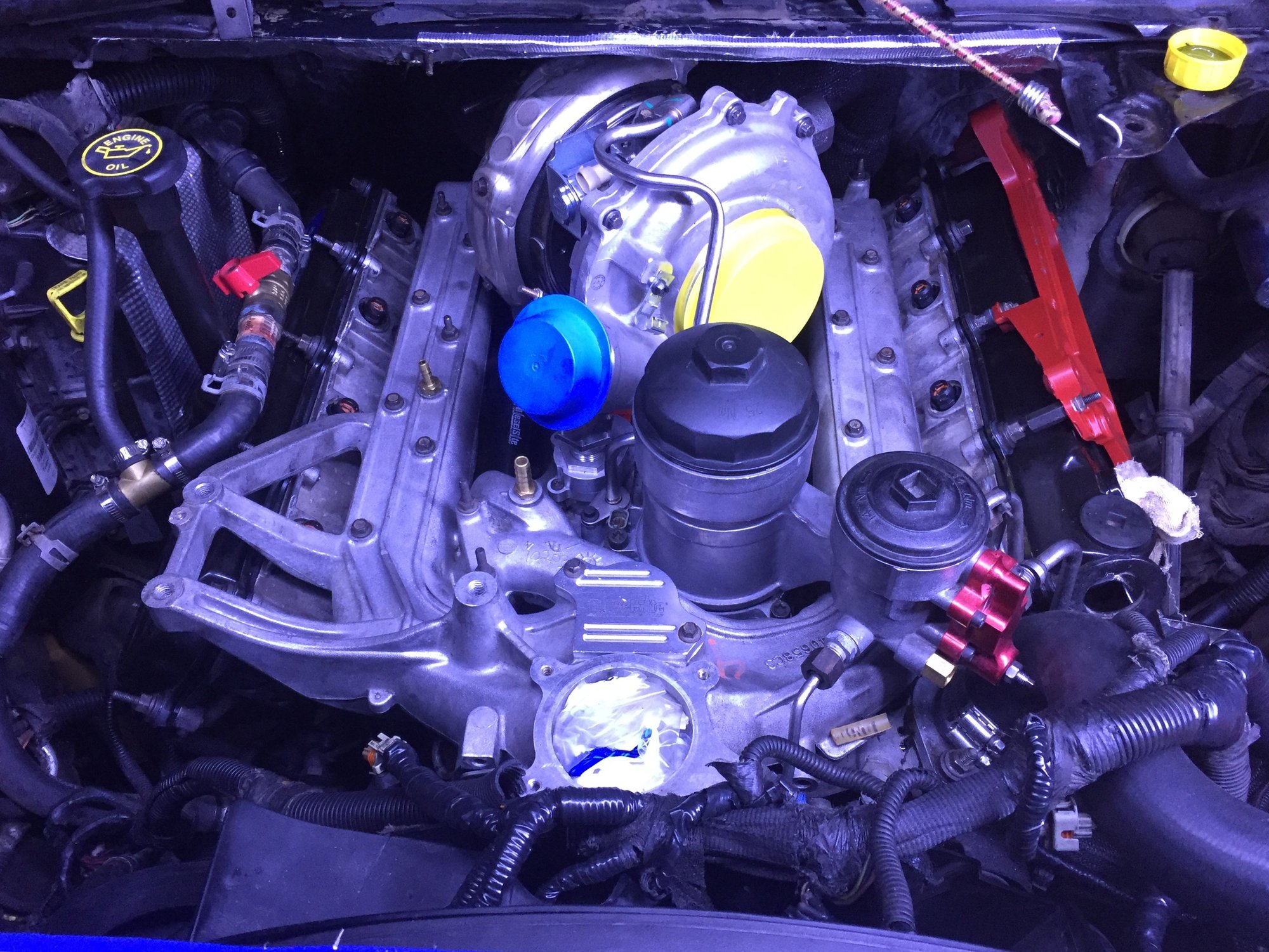

I got a new engine and injector harness last month from Tasca Ford for about $565 (mine is a 2003 so the ICP plug is on the branch with the IPR) and replaced both in one day. The hardest part was disconnecting and reconnecting the crank sensor. I cut the end off and routed it in front of the A/C compressor. The factory routing is ridiculous! To get it back where it was you have to remove the compressor which is just not worth it.
I test fit both harnesses and moved some of the clips and fasteners where they really needed to be to work right. I then wrapped both harnesses with Tesa heat resistant harness tape then installed them.
