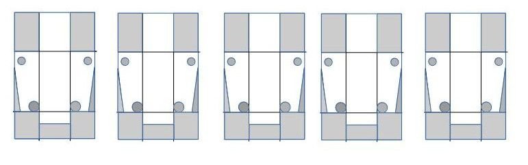

I needed the clips quickly, so instead of buying them, I printed out the attached PDF document, then just painter taped to the metal piece, center punched, drilled and using metal shear to cut out the gray area and two tiny outside corners of the bottom 2 circles. Trimming those circles made the bottom piece wrap around the circle nicely. The drill bit depends on the wire size you got. The two small holes uses 2 mm I think. The larger one is 3 mm for me. Find a strong wire and bend it as pictured, really easy to do.
I was so busy that I didn't have time (or maybe lazy?) to debur the edges.
The clips I made are not exact duplicate of the original, but worked very well for me.
