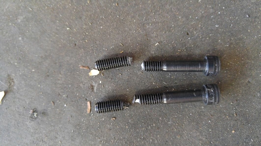

I would also recommend buying some M6 bolts that hold Riffraff's cup tools in place. They receive a good amount of stress when removing and installing cups. There's no telling how close they are to thier end of life. I had two break off in the head while I was doing my cups. Next time I will buy my own bolts so that I know I'm using a fresh set. Just my .02

FTE Emeritus
Brian, were there any marks or stamps on the bolts to indicate grade?
USA Made 12.9
Originally Posted by Riffraff Performance
USA Made 12.9
^^^ What Clay said.
Luckily the bolts don't bottom out so I was able to back them out with a pick tool (it took me about an hour to figure that out and it was by blind luck).
The kit comes with 4 bolts so I was able to finish the job. When I told Clay he said not to worry about it, the bolts get old and he would replace them.
