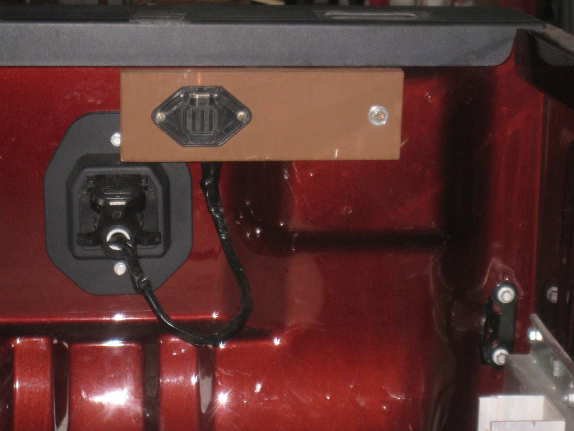

2015
Hi Zar
This is my setup
Old May 13, 2018 | 03:43 PM
RZAR's Avatar
RZAR
Joined: Oct 2010
Posts: 258
From: California
Originally Posted by pack4tag
2015
Hi Zar
This is my setup
Hey pack4tag,

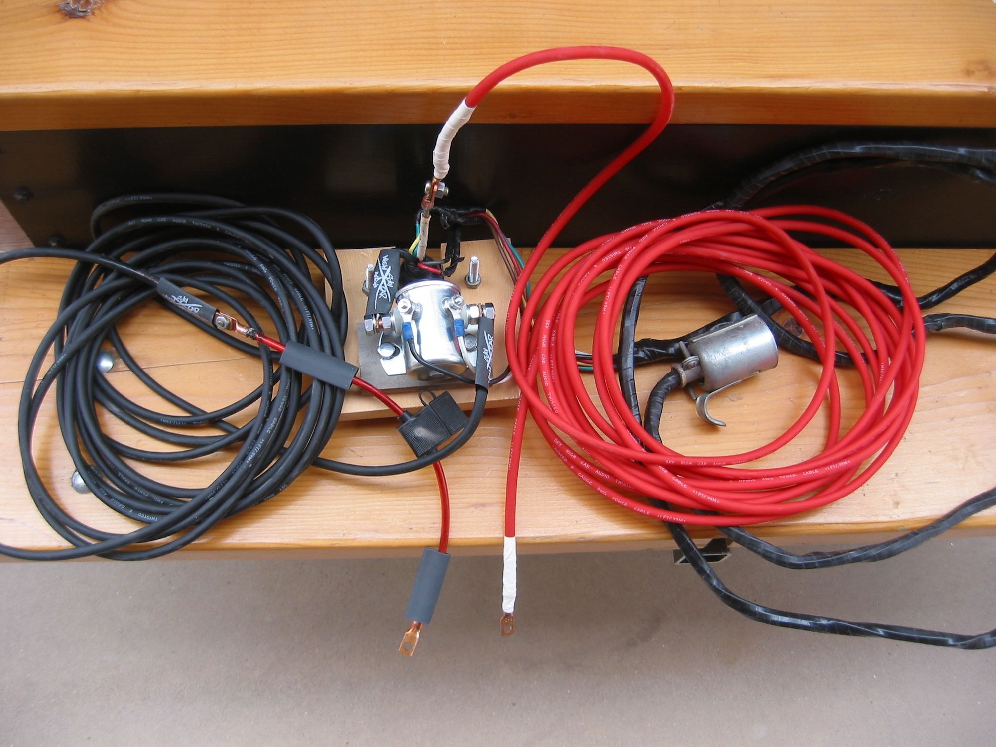

I know you from the Lance forums and a rally or 2. Thanks for the picture. I like that set up. What did you do about the 8 gauge 12 volt wire?

I did this for about a year. My frig is a manual three way that works better (colder) on LP than on 12 volt. So now I only do 120 or LP.The way we travel and stop,seemed like we were always switching LP to 12 or back.

Yeah it's a pain switching between 12v and propane when traveling, especially if you have to open the slide to get in. I will probably just use the trucks charging circuit and not run a separate charge wire. Thanks.
