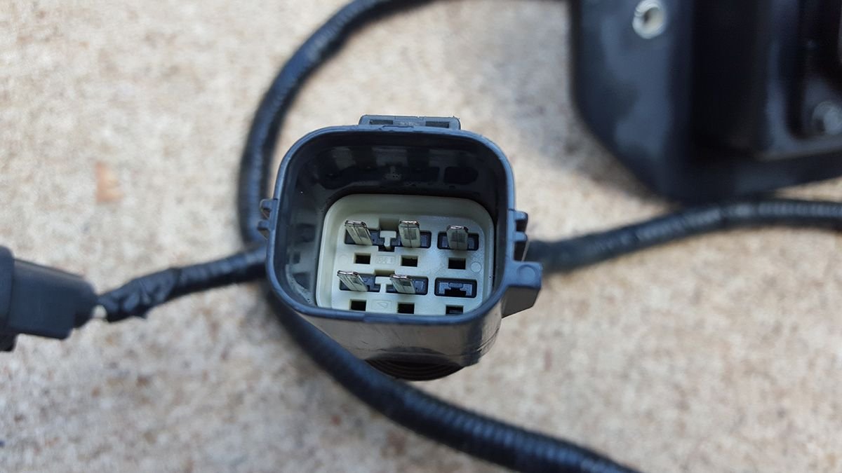

Trying to put a 7 way plug in the bed of my new 2015. My truck does not have the 5th prep package. It only has the 7-way 4 way combo by the bumper receiver hitch.
I found a 2013 F350 in a junk yard with the 5th prep package that has the 7 way in the driver side of the bed. I have not looked closely at it yet though. So I dont know how it wires up.
I'm thinking about grabbing it, but not sure if or where it will plug and play into my truck.
I do not want to cut and tap and splice to make it work. I want plug and play.
I found these plugs under my truck. Driver side by spare tire. Is this where it may plug into?
If this factory part wont plug and play, I'm thinking it may be easier to grab ones of these aftermarket ones that do claim to be plug and play...
Pollak 7way

After looking at the dual plug setup on my truck - one had two pins, the other had 5 - I went back to the junkyard to look at that donor truck.
It had the same plugs by the spare tire. I unplugged them, followed the wires which led to the 7way mounted inside the bed.
Removed 2 10mm bolts and $20 later was the proud owner of a junkyard 7way connector and harness.
Got home, plugged into my plugs, tested... everything worked as it should.
Drilled a 2" hole in the side of the inner bed, fed everything thru, routed wires neatly, plugged up mounted up and tested working as it should.
Not bad for a morning's work.

Thanks for posting. I am thinking about going the same route with my truck if I have those plugs back near the spare. The pictures are especially helpful.

I got rid of the Hopkins in bed I had put in and went with the factory in bed 7-way just as picture above. I never liked having to tie-wrap the connectors on the Hopkins together and the 7-way always seemed loose.
The Ford harness is the way to go, less extra wires to tie up, solid connections on both ends. Wish i had done this the first time.
