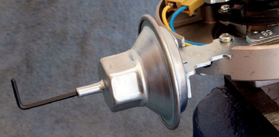

Not all vac advance units are adjustable the factor ones are not for the most part almost all after market ones are, IIRC it is a 7/32 Allan key that is used to adjust them.
Crane sells a nice kit for rec-urving and adjusting your total and vac advance.

To save me from typing a book and taking a bunch of pictures I did a google search and found this. This is exactly what I've been doing to the Durasparks for years now. Same principle on your distributor except you may have to slot the holes in the rotor button and move it, if it is off. But again a timing light and a hole in the cap is the only way to know if the phasing is off. Junk Yard Genius.com Rotor Phasing For Motorcraft Distributors Page
As far as adjustable advance canisters go, the only thing you can adjust is amount of vacuum it takes to pull in all the advance that the canister is capable of. If you have a 10 degree can it's always going to pull in 10 degrees at the distributor, "20 crankshaft degrees". The only thing you can change is the amount of vacuum it takes to make it do that. For Durasparks, something I know about, you can buy vacuum cans that pull in different amounts of advance, 4,8,10, 12 camshaft degrees etc. then adjust them to pull that amount in at the best time for your engine combination. And that requires a lot of driving around with a vacuum gauge on the engine and listing for pinging or noticing if it's surging.
