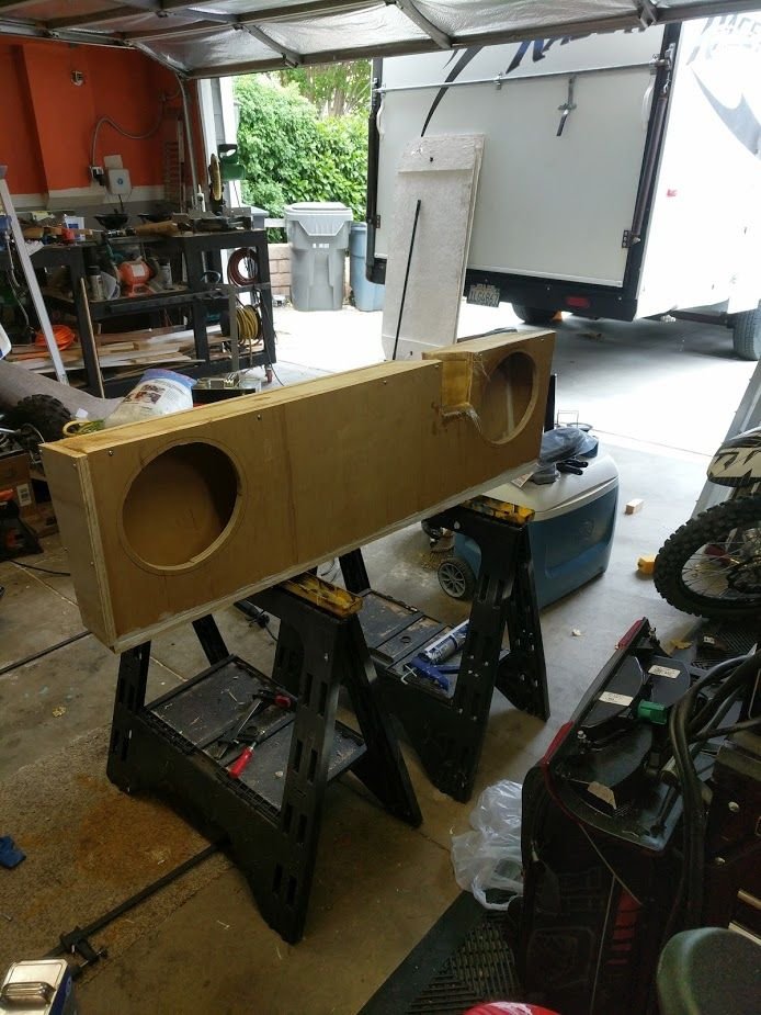

I'd love to see the sub setup. Curious if universal or custom box (es).

Custom box. Fiberglassed the bottom humps that traverse the rear seat mounts, maple ply for the top/sides. It sounds amazing, one of the best boxes I've built (not saying much) for the space available. Came out to about 1 cu ft. Cost was nothing really since I had the materials laying around from another wood working project.

Can you share the dimensions and/or plans for the sub box? Where'd you mount the amp? It normally sits on that back wall.

I installed my Sub amp under the rear seat, and my front Class D amp in the dash, under the Sync system. Its such a small amp and puts out 191w x2 RMS....crazy how efficient amps have gotten over the years. I also designed the box so I can still raise the seats.
For box dimensions. I'll have to see if I still have my drawings on my work bench somewhere. The box basically spans the entire back width, is about 5-6" ID deep at the bottom and 3.5-4" deep at the top, IIRC. The sounds is just amazing. I have plans to install a MiniDSP C-DSP6x8 this summer to play with the time alignment and eq for each speaker....but I might actually forego that as it sounds pretty perfect to me as is.

Did you do any sound modeling on the box dimensions to optimize the box or did you just go with whatever fit the available space?

Since I knew I had to go with a sealed enclosure because of space constraints, I just tried to get as close to 1 cu ft. as possible since my Infinity 10's recommended 0.5 cu ft as the optimal sealed enclosure. Once I had measurements that would work, I plugged my dimensions and sub specs into WinISD and figured out that the response curve was pretty dang good. These slim subs are designed with this type of enclosure in mind, so it wasn't that mind blowing that it turned out so well, but I was super happy that I got 2 x 10's back there and the seats could still be pushed up to access the storage area. The fact that the response curve, SPL, etc. were all optimal was just a happy coincidence after the fact!
