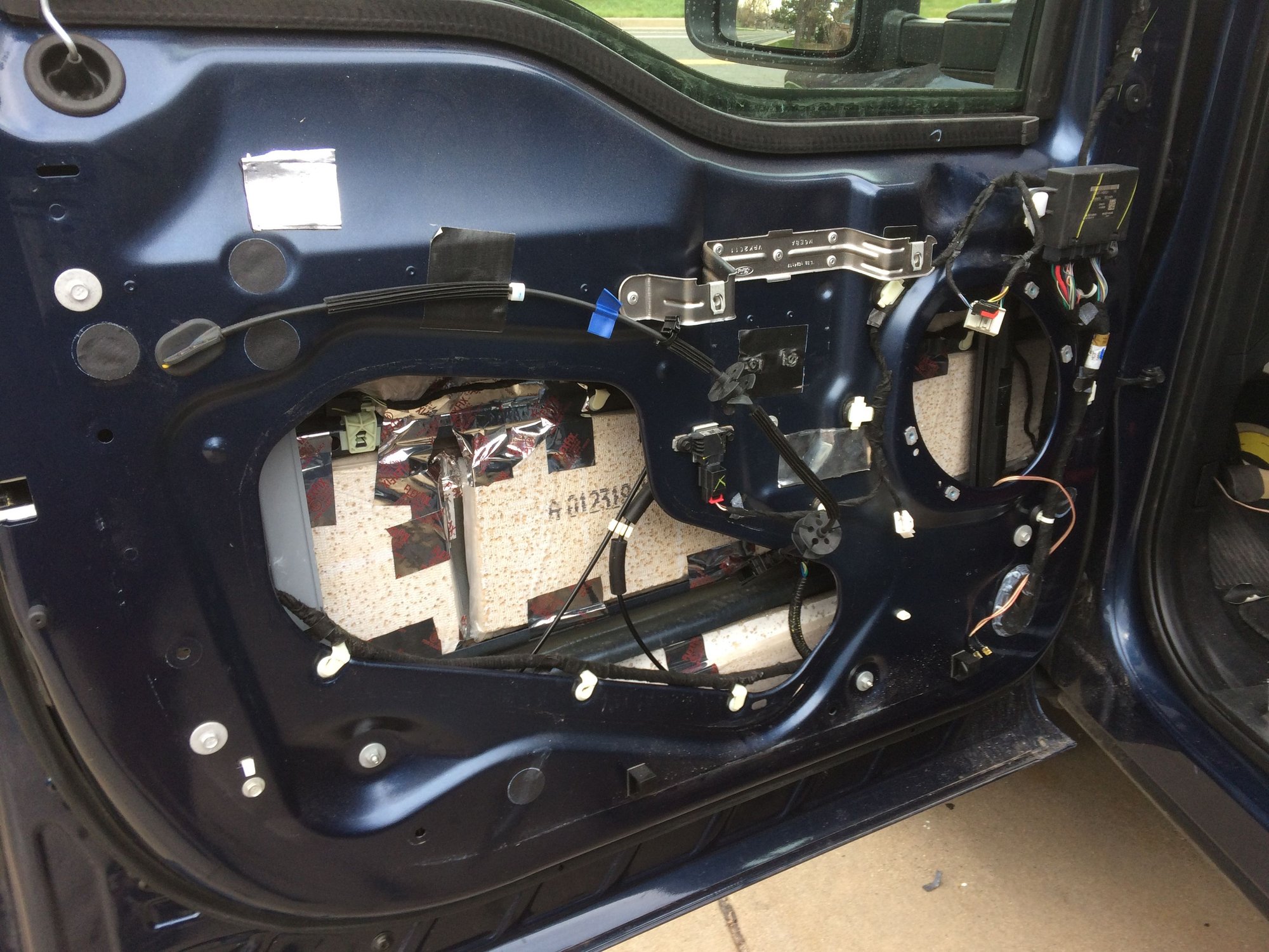

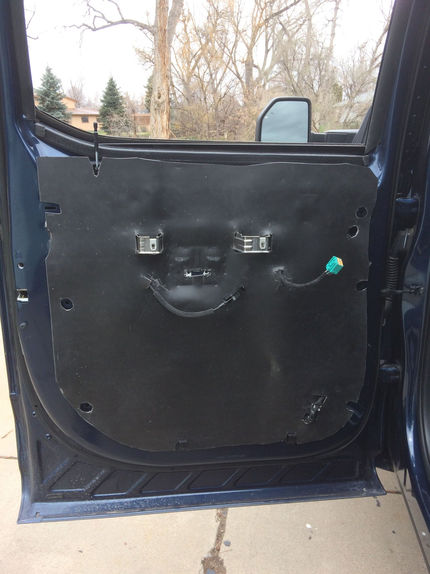

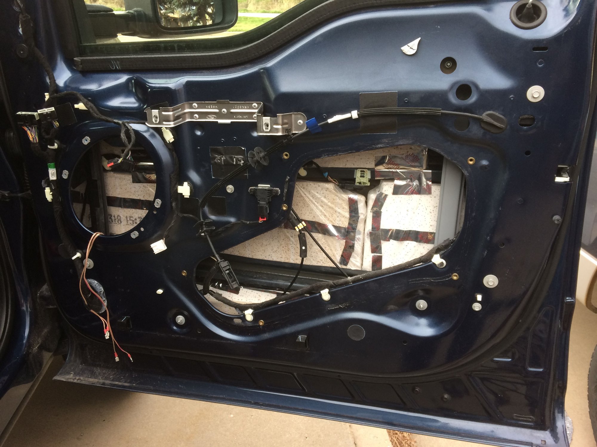

Took all weekend to do both front doors. Most of my time was trying to figure out how run wire through the molex connector and how to cut and install the acoustic panels. That said the second door went a lot faster.
Posting two pics at a time because I'm having a terrible experience trying to upload pics on this forum. Here's the acoustic panels:

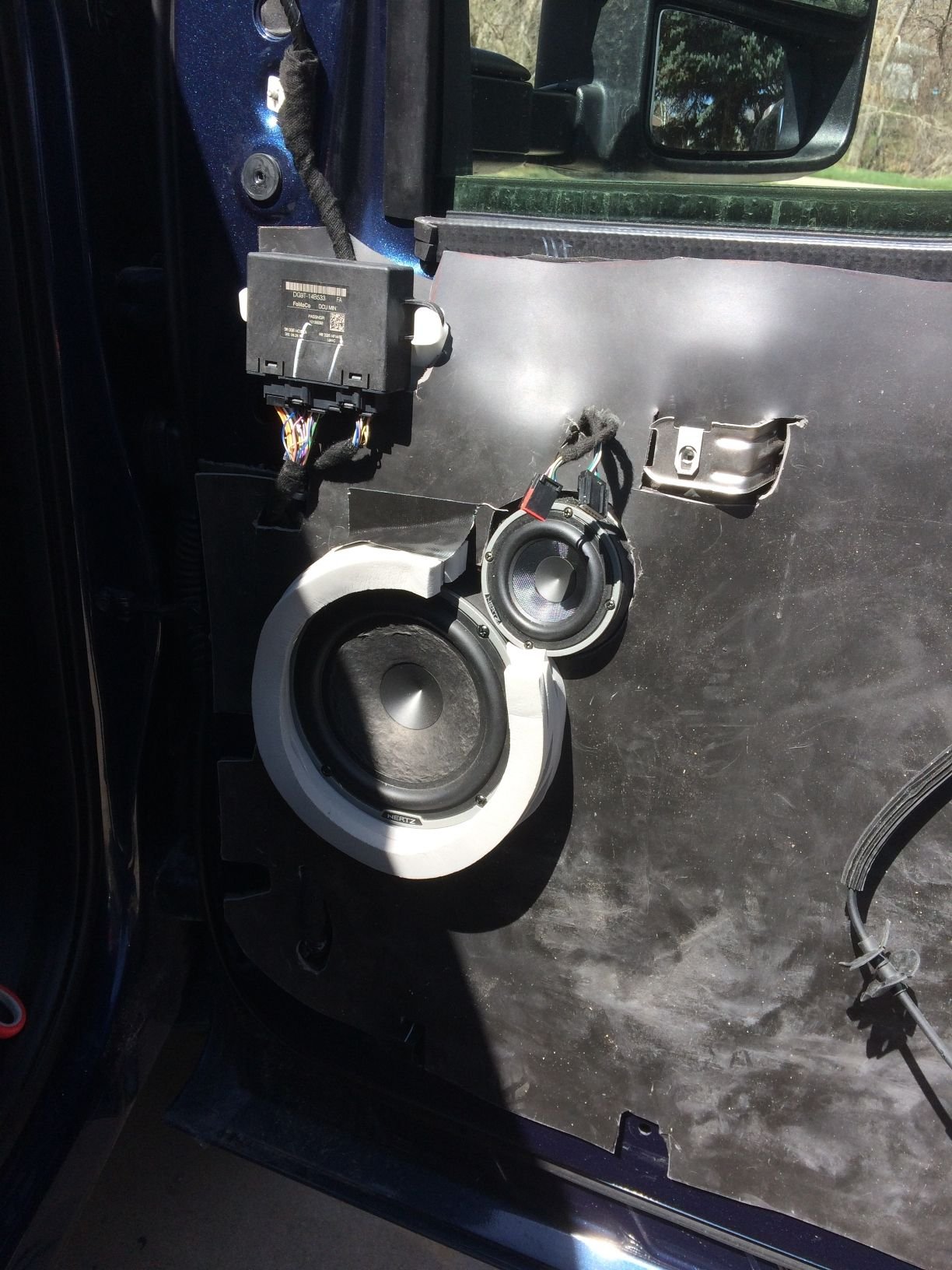

Here's the door closeout and speaker plate for the woofer and mid. Second pic is test fitting the MLV

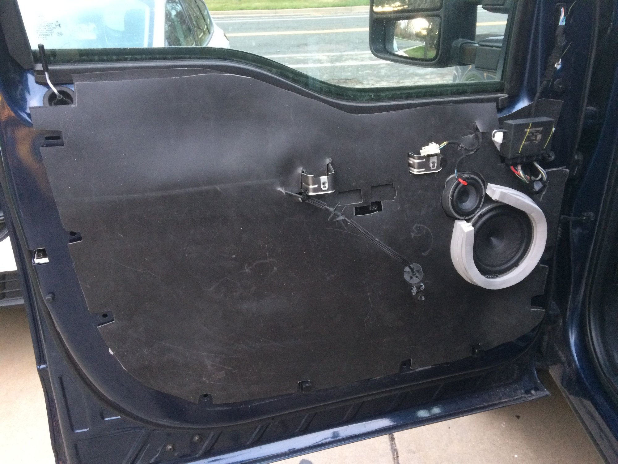

Final product after lining the inside of the MLV with foam and surrounding the woofer with some closed cell weather stripping.
It's like you're a mind reader, this is the direction I'm leaning towards as well except with AudioFrog mids.
Which speakers are those? Could you please repost the mounting plate for the woofer and mid? What did you make the mounting bracket out of? What did you use for the acoustic panels? Did you add pins to the Molex connectors, or drill through them? Sorry for all the questions!
Old Apr 16, 2018 | 11:45 AM
  #45
ehahn's Avatar
ehahn
Joined: Mar 2018
Posts: 11
Hertz HSK 163.3 components. Bought the mounting brackets here: https://store.audiodesignscg.com/pro...aker-adapters/ Acoustic panels are the 2x4 foot ceiling tiles made of mineral wool, my local home depot doesn't carry the fiberglass ceiling tile. I poked a bunch of extra holes in the panels with a bunch of wood screws sticking out of a piece of plywood. Each panel is covered in 0.7mil plastic sheet to protect from water.
I have a basic XLT so the molex connector had a nice big round empty 1/4" hole in the middle. It had some extra webbing inside so I just drilled it out clean to make it a nice smooth hole so the wires pushed through easily. I'd imagine this hole is already used in higher option levels.
