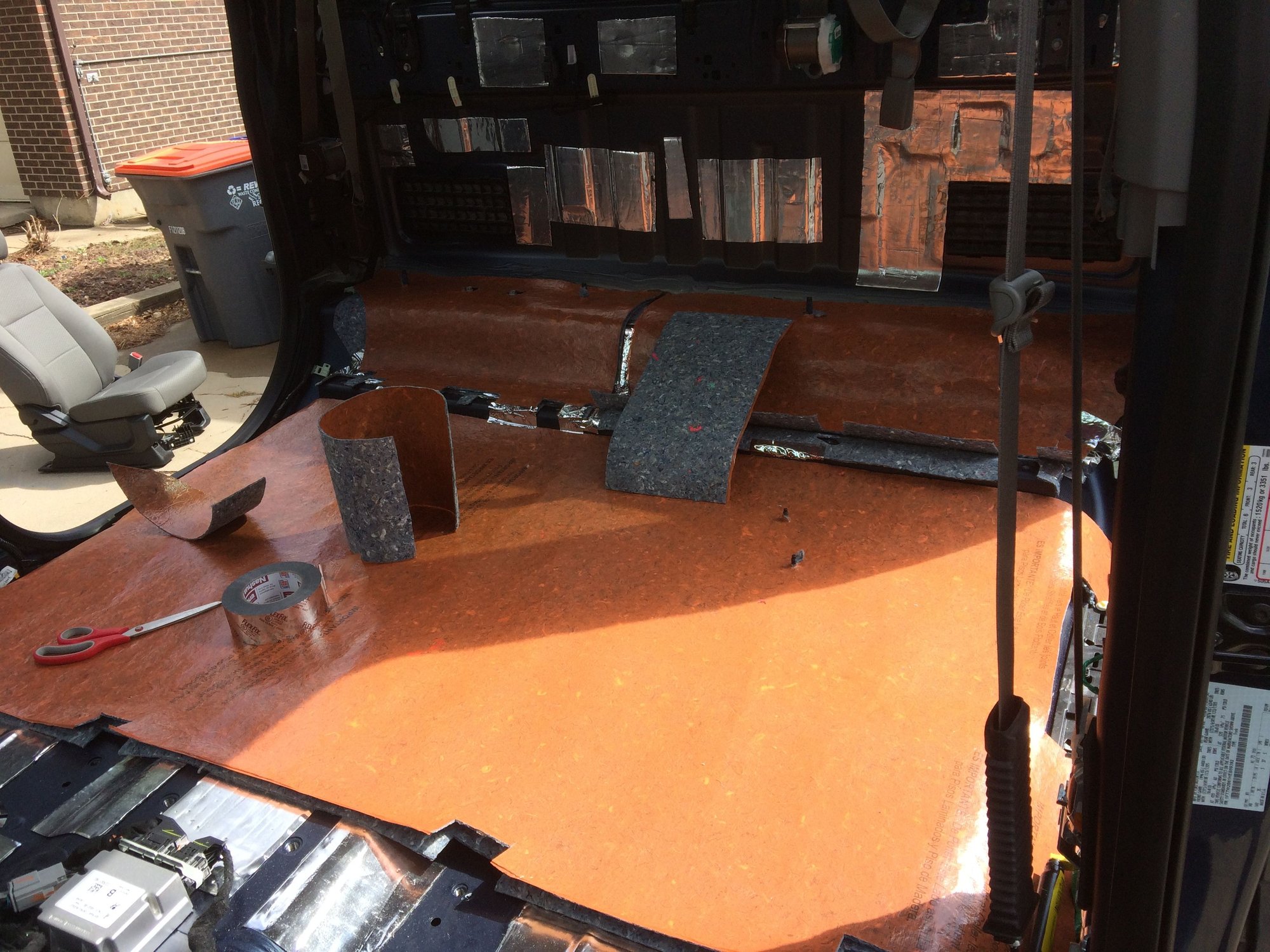

A little further last night!
Finished the back wall and the C-pillars last night. Stuffed all the cavities with denim insulation. Had a total of 3-4 layers when we were finished. Tons of time but no dead space for sound.

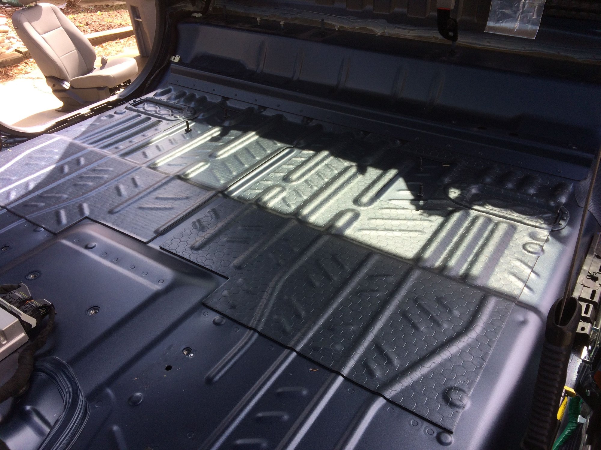

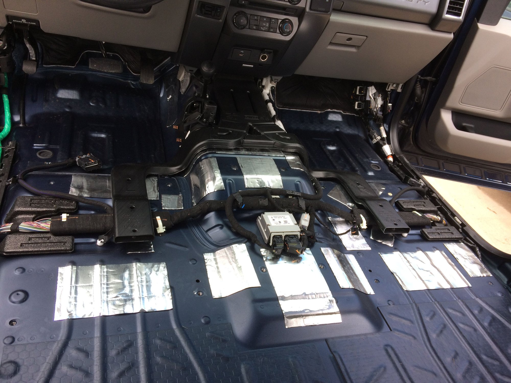

Just bought this truck a couple weeks ago. Going to transfer the stereo from my old F150 into this one. Figured I'd do it right this time. I'm planning on keeping it for a long time anyway.
Today was tiles and MLV on the floor. Took all day. Going to finish the rear wall tomorrow. Planning on doing the same to the doors when I get the time. Still waiting on parts to come in to install the stereo, but at least the hard work is done by running the wiring. The stock floor was actually mostly covered in OEM deadener so I didn't need to used as many tiles as I anticipated. It's called FAIST if anyone knows what it is.
