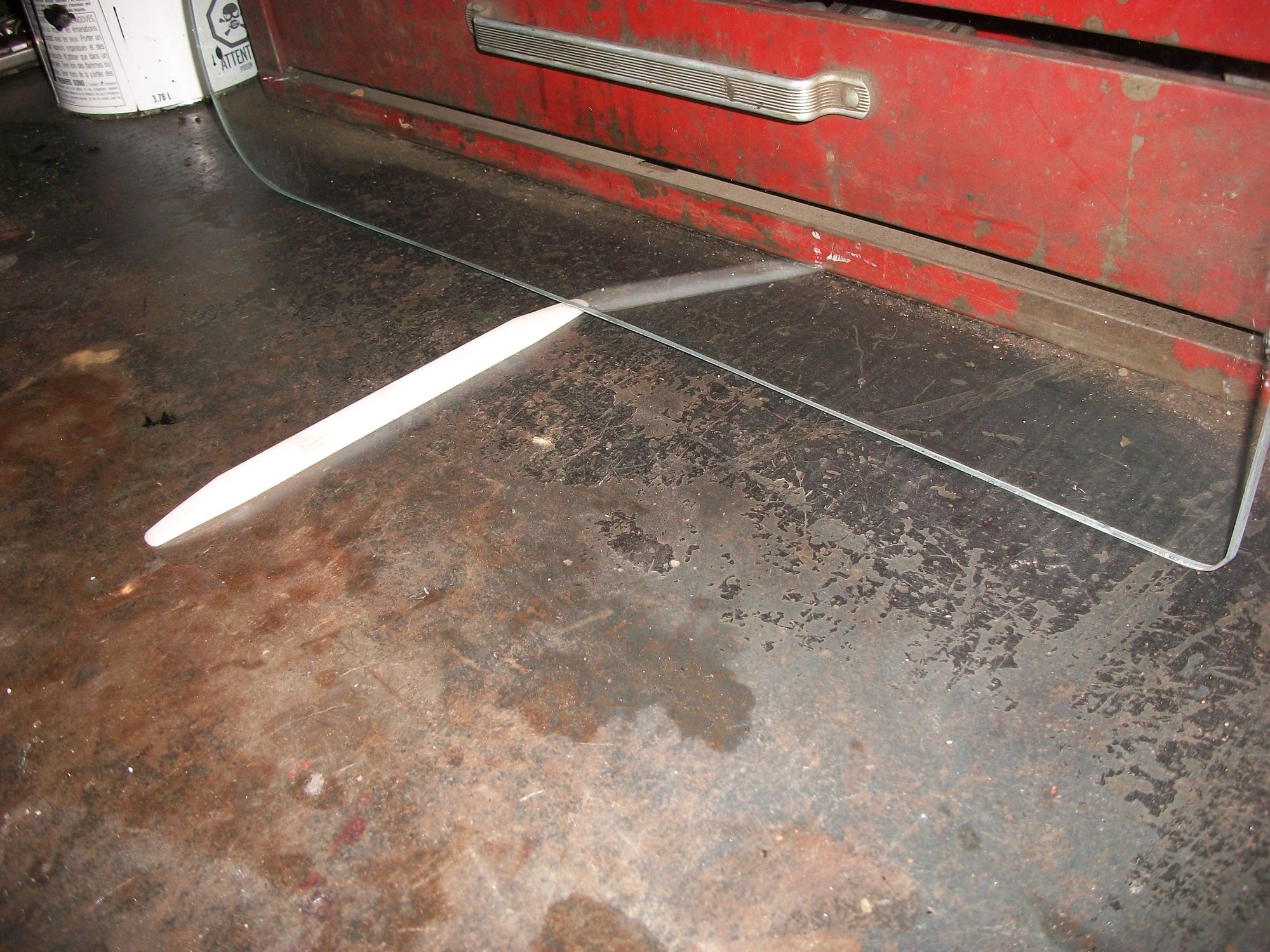

thanks catimann! i phone the glass shop twice today, they have a answering machine. i left a messaged the second time,they didn,t phone back yet. i think its important to be there. i didn,t use a straight edge but the bottom pinch weld seems curved. hope to get answers tommorrow.
Old Mar 22, 2018 | 07:42 PM
bernette's Avatar
bernette
Joined: Nov 2012
Posts: 3,157
Likes: 198
got the glass fixed this morning! they buffed or grinded them,didn,t charge anything. i put a straight edge on the bottom lip of the windsheild frame,and there,s a bow in it. now to set up another time to installed them. probably that a straight windsheild will lift the exterior corner ! thanks lew! i hope anybody getting Windows cut make sure its curved. i will post a picture example this weekend.
Old Mar 24, 2018 | 08:38 PM
bernette's Avatar
bernette
Joined: Nov 2012
Posts: 3,157
Likes: 198
here,s what it should be like!
