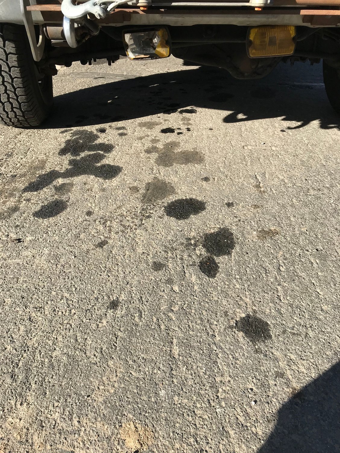

Due to it sitting for so long, and me driving 500 miles a week, it's needless to say it is leaking oil pretty bad. It looks like most of the oil is coming from the oil pan, on the passenger side of the engine. It was 4 qts low after I topped it off less than 2 weeks ago. I do trim work in multi-million dollar homes, and oil leaks are forbidden. I am wanting to pull the motor, and clean up and reseal it. But am unsure just how far I should go with it. Can I just do gaskets and assume I can put another 100,000+ miles? Or do I need to blow it completely apart, and machine it, bearings and rings? The lady kept up with oil changes, and would go out at least once a month and start it, and run it for a while to keep things moving. I do not see any noticeable blue smoke.

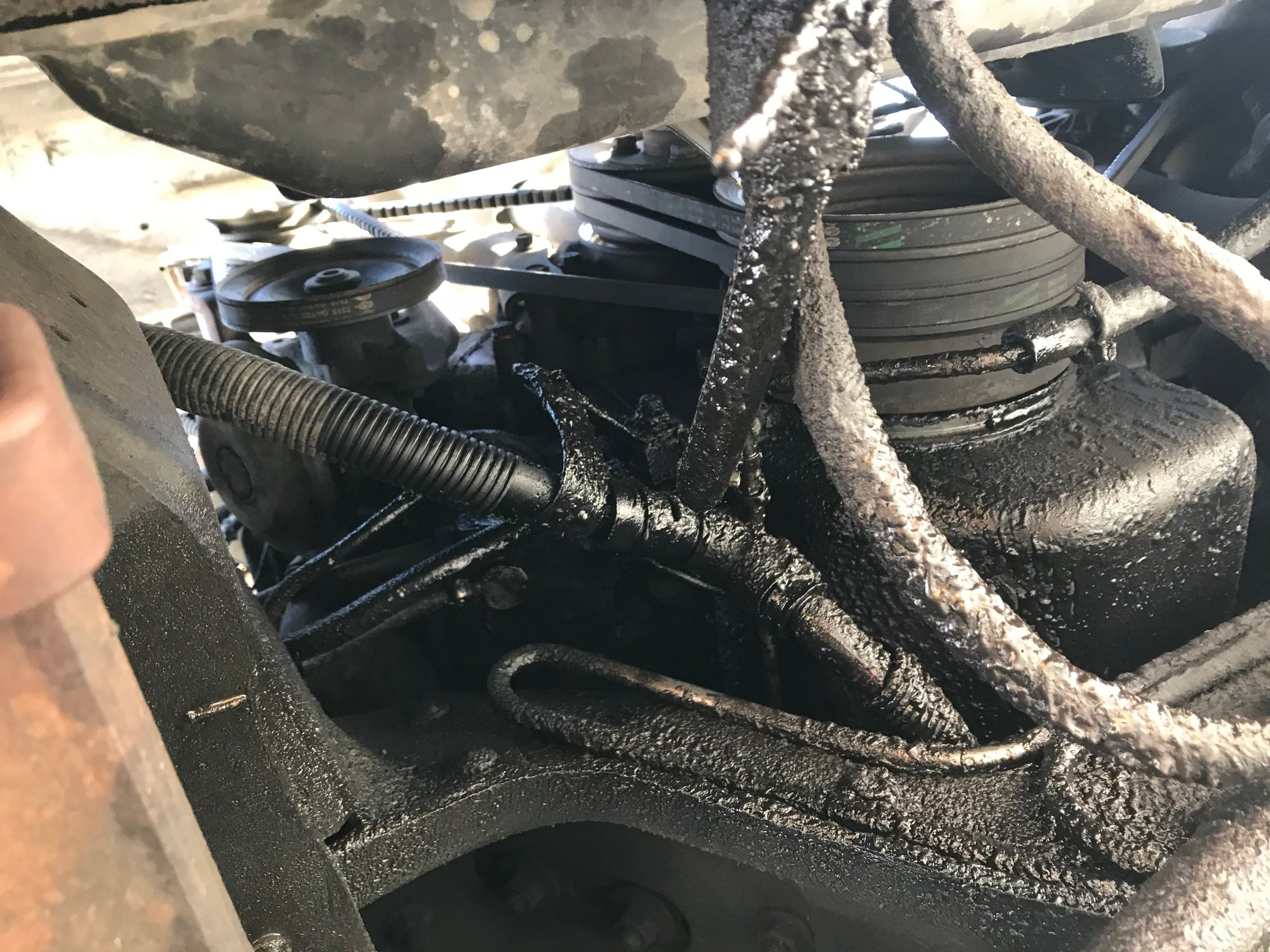

I would first off take it to a car wash. Use engine cleaner (or cans of foamy or gel engine brite) to get all the grease deposits well soaked, give it a few minutes(while washing the back half of the truck) and then use high pressure soap to get as much as you can off; rinse it and see what you get.
Depending on the depth of some deposits, you might have to do it twice. Either way, once you have it clean, you can see what 'current' oil leaks are coming from, and not just old deposits or weep spots.
Losing 4 quarts in a few hundred miles to leaks would be... well, a huge leak. It might also be burning it; this is why you want to clean everything and see how much you are actually losing and from where.
Assuming you pull the motor to re-seal the oil pan, that would be a good time to look everything over on the under side. You should be able to wiggle the connecting rods, looking for excessive play, look at the bottom half of each cylinder etc.
Seal wise, if you are that far into it, replace the front and rear main seals at the same time. The rear is /easy/, the front requires removing some accessories and taking the water pump bolts off... though you might look into a puller tool to pull the seal with the plate in place. That would be the easiest option, as removing the harmonic balancer will give you clearance.
Valve covers need replacement, and you also want to look at the valley pan - if you are getting oil down it, it could be coming from the IP gear cover, or the front of the valley pan.
If it's only near the back, the CDR tube might be the failure point.

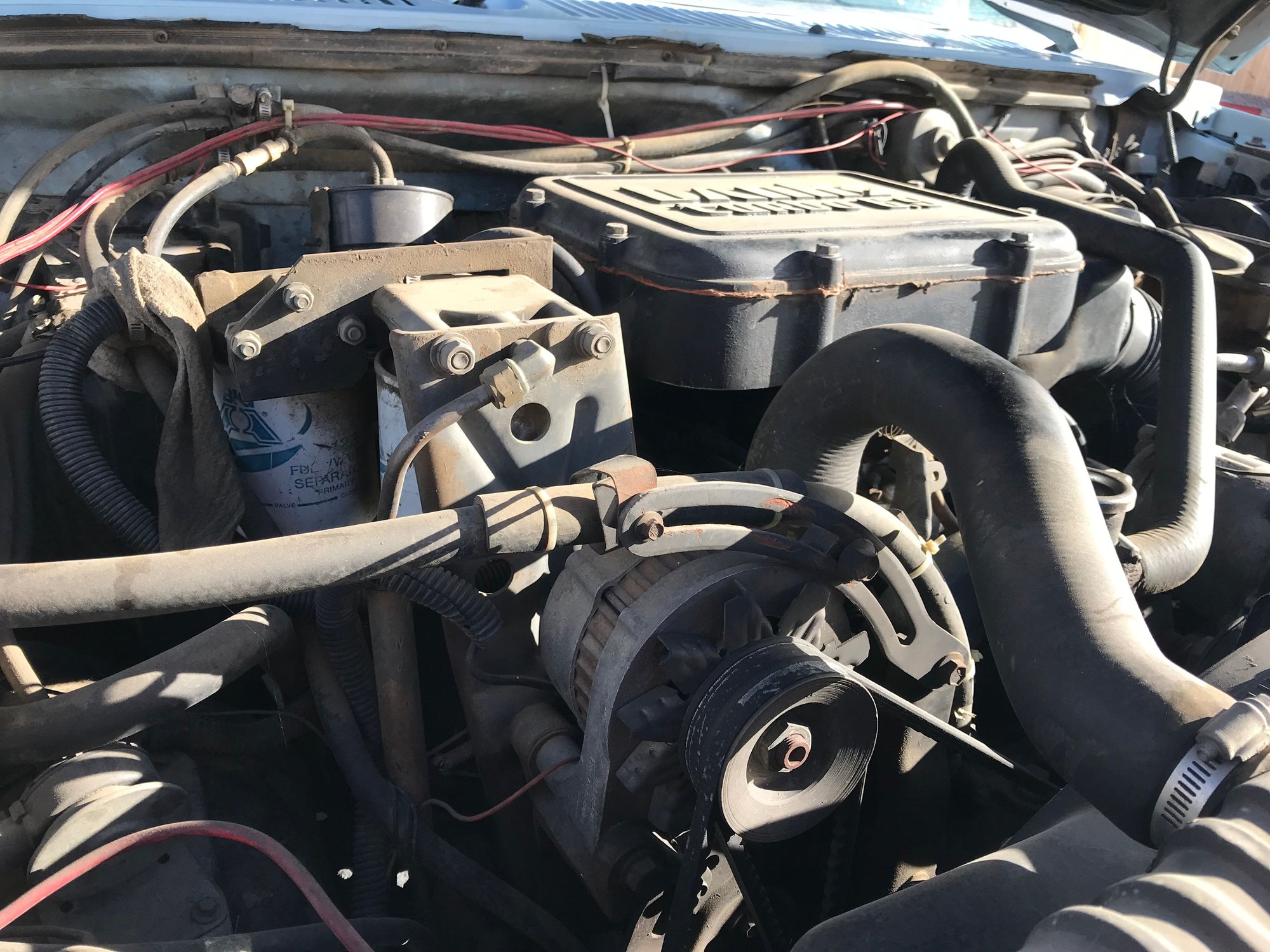

I was thinking while I had it out, I would do head studs. Another big reason to pull it, is to clean the frame rails, because they are caked with grease.
I redid the injector return lines after buying it, and did not see any oil on top. Really, the top of the motor is pretty clean. When I crawl under it, the engine cradle is covered and dripping oil everywhere, and the whole passenger side of the pan is wet, with fresh oil. I need to get over and get my dad's pressure washer workimg, cause the carwash's are not power pull enough to clean the underside of it.

You mean pic # 2 is not normal for an IDI
Old Feb 5, 2018 | 10:57 AM
Chevy_Eater's Avatar
Chevy_Eater
Joined: Apr 2005
Posts: 4,221
Likes: 17
You'll never get a rusty K-member on our trucks.
