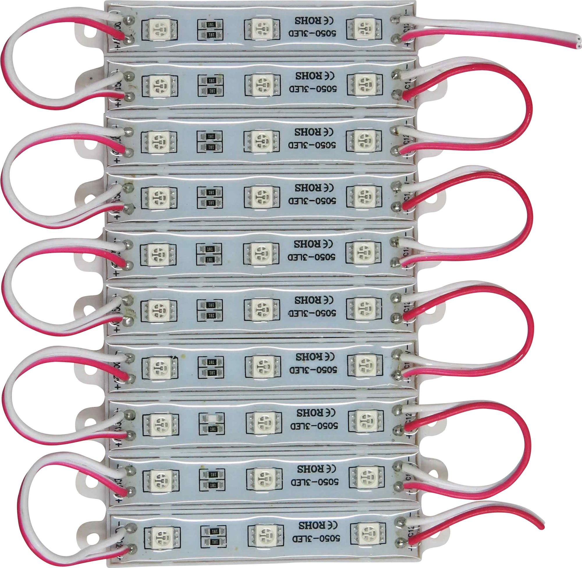

I bought these for $25 on amazon and tied them into the stock bed LEDs. They seem to work well.

i added these from princess auto cheap. if you live in canada dunno if there in the u.s.a

There is something very similar available from Oznium.com and they are relatively inexpensive also at $2.49/each.
https://www.oznium.com/premium-led-module

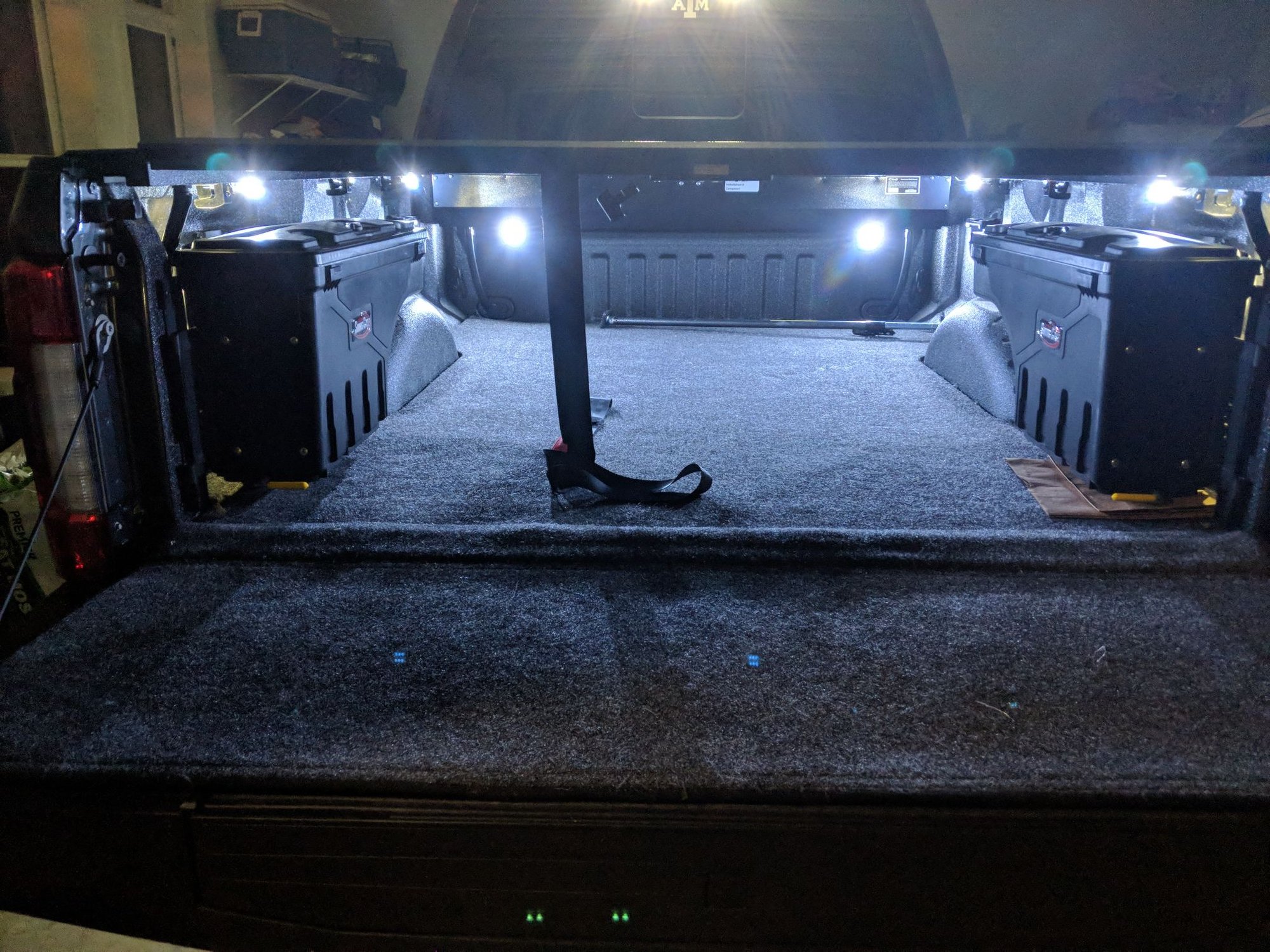

Heres how they block the current LEDs.
https://photos.app.goo.gl/95PThe247wgiUqFv1
Originally Posted by Mack3006
Can u post some pic of the boxes installed and how they cover up. I was planning on these boxes too

Bed LEDs
Amazon Amazon

Anyone actually hook the bed lights they added to the Led center high mount light switch on the dash? Had that idea this morning leaving for work and turned on the light using the existing switch......
