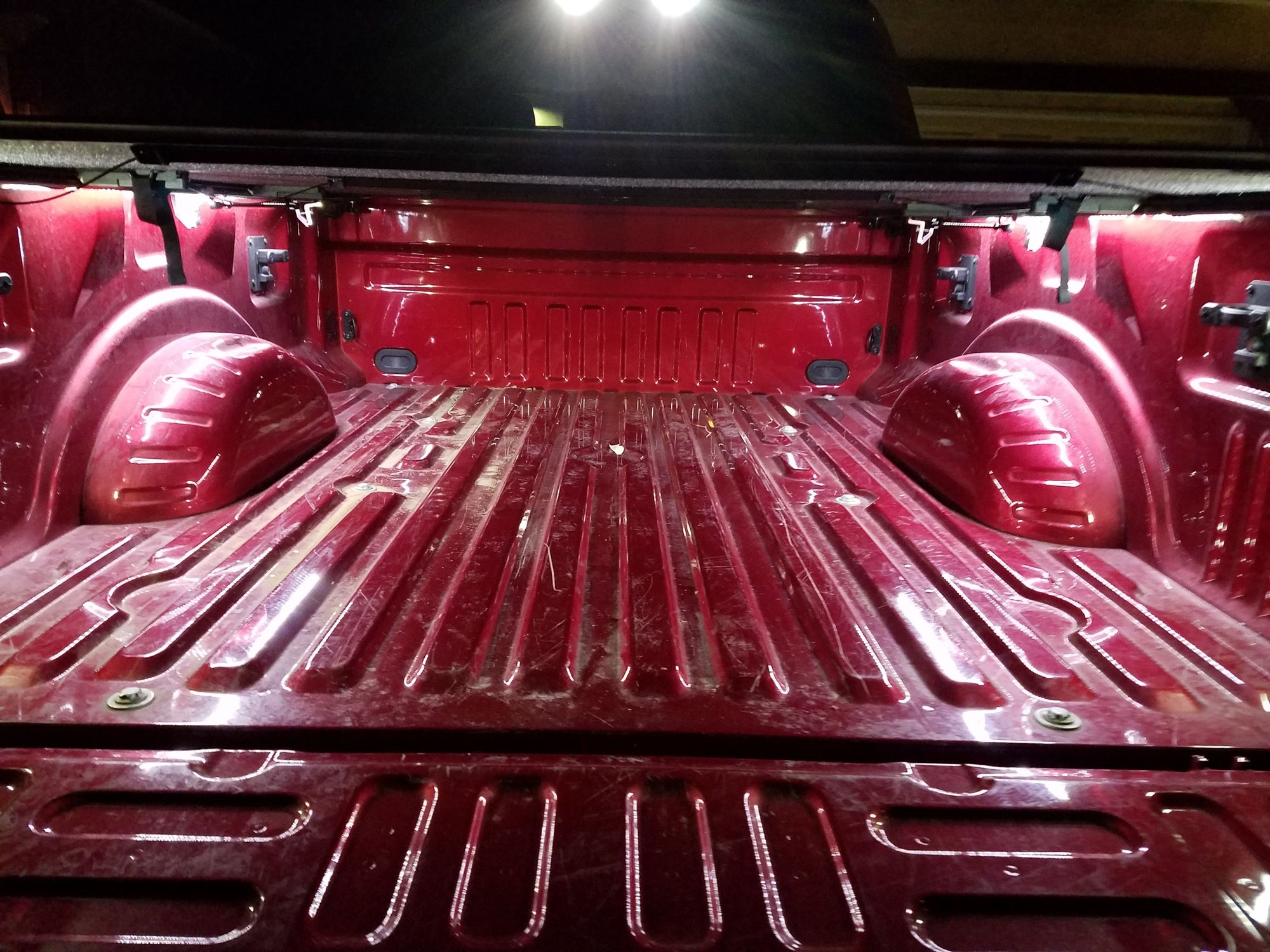

I finished adding some light strips today. Purchased two 39 in long strips from Superbrightleds.com. Tapped into the box LED light switch so I can turn it on/off from the stock switch. Now I can get light at the front of my bed with my tonneau partially closed and if one of the stock lights are blocked.
