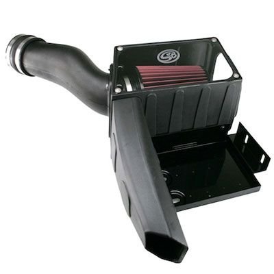

It doesn’t have any whistle inside the truck but I don’t think I’d mind it. I have a 4” down from the turb to a 5”-6” tip. I have the s&b intake in a box.

This is my set up

I would not pull out that S&B for anything. It's a great breather and it keeps the turbo noise under the hood to a tolerable level. I say that with a 38R, though.
