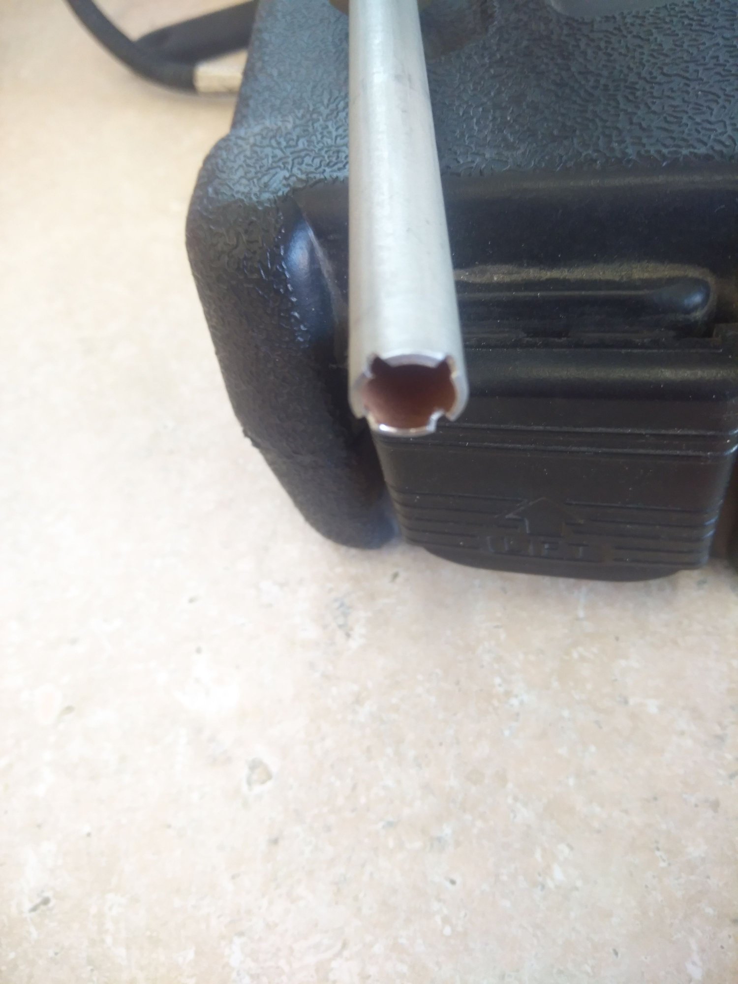

Right in the middle of the hutch mod and my pick up foot is in pieces. Is it needed? Are the new ones holding up long term?
Im half tempted to ditch it. Thoughts suggestions?

I wrapped up the Hutch mod. I ran a 3/8 line down to the bottom of the tank and left a 3/8 gap. I also notched the tube.
99 percent of the time, I fill the main tank with my auxiliary tank that also has a filter. I'm not to concerned with debris at this point. Worst case I can drop the tank and add a foot if need be.
