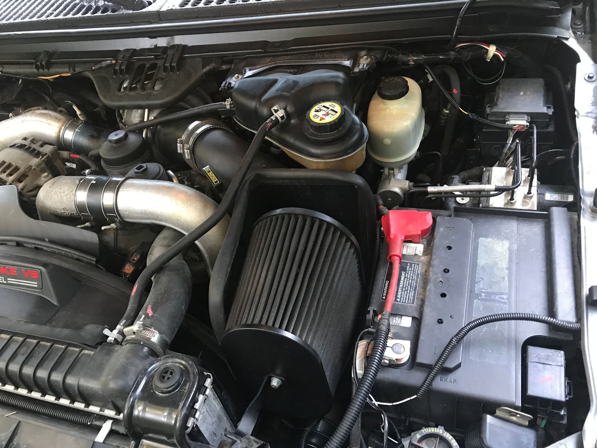

Pretty stoked, super tight truck with only 76k clean carfax, local and all that. Gonna bite the bullet and get it studded, deleted and all that asap since i plan on keeping it for a long time. It absolutely drives and turns 10 times better than my 02.
it does have an after market air filter I may swap for stock, 4" exhaust w/cat delete and a BD exhaust brake. Otherwise pretty stock. They said it had the camper package with heavy fronts and maybe bigger alternator? Bought from a dealer so not much to go by except oasis, carfax and such.

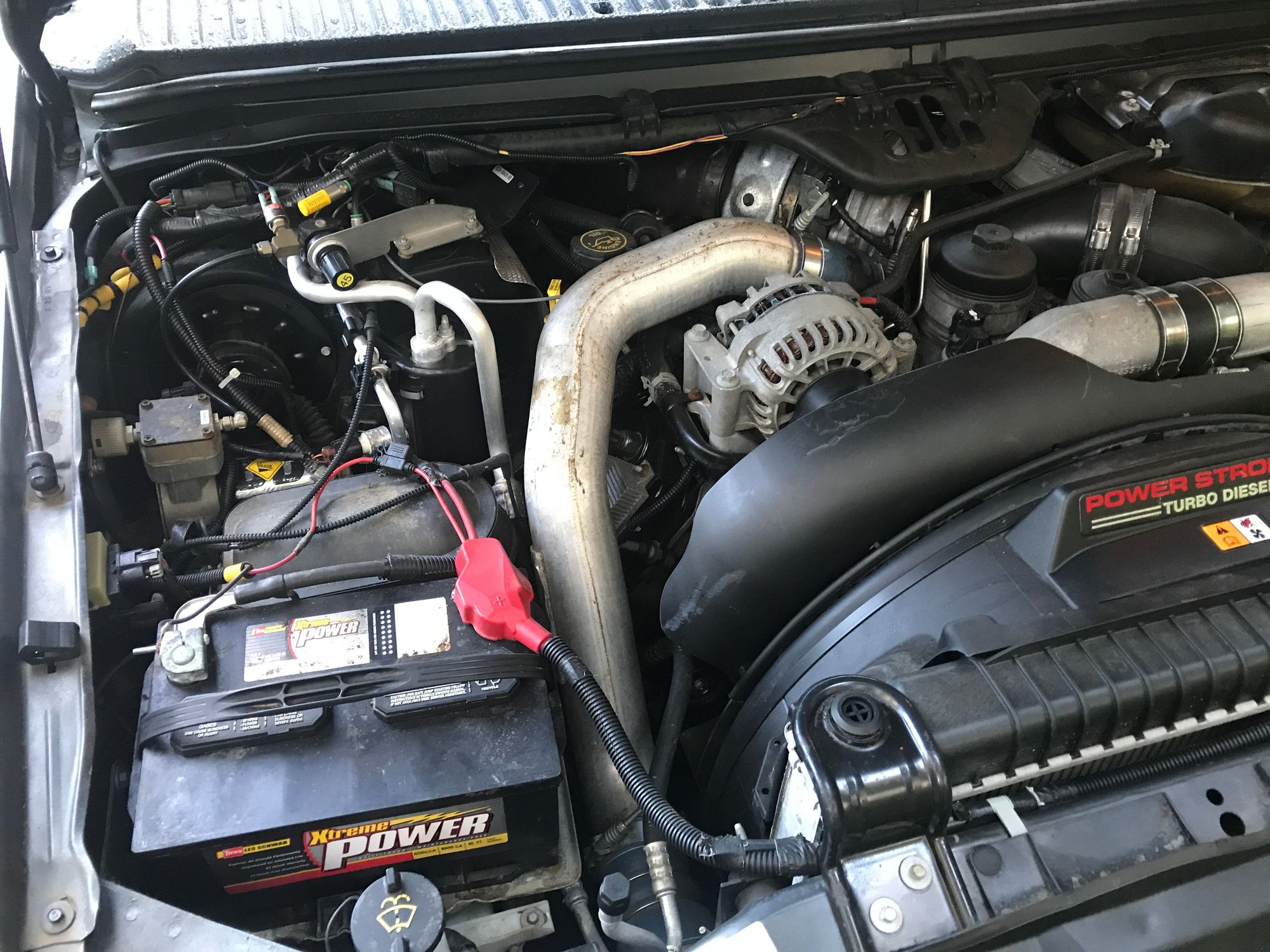

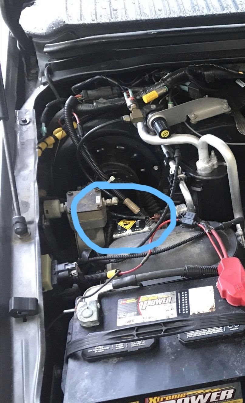

Not sure what is going on with the cut wires and black box velcroed in onthe drivers side close to the fire wall?

The "cut wires" may be the factory "pass-through" wires.

Do I see the wiring from the black box on driverside run all the way over to passenger side and hook into what might be labeled exhaust brake?
Not sure, will look in the morning. Figured out the exhaust brake earlier today, uplifter switch #1, sounds and woks awesome.
