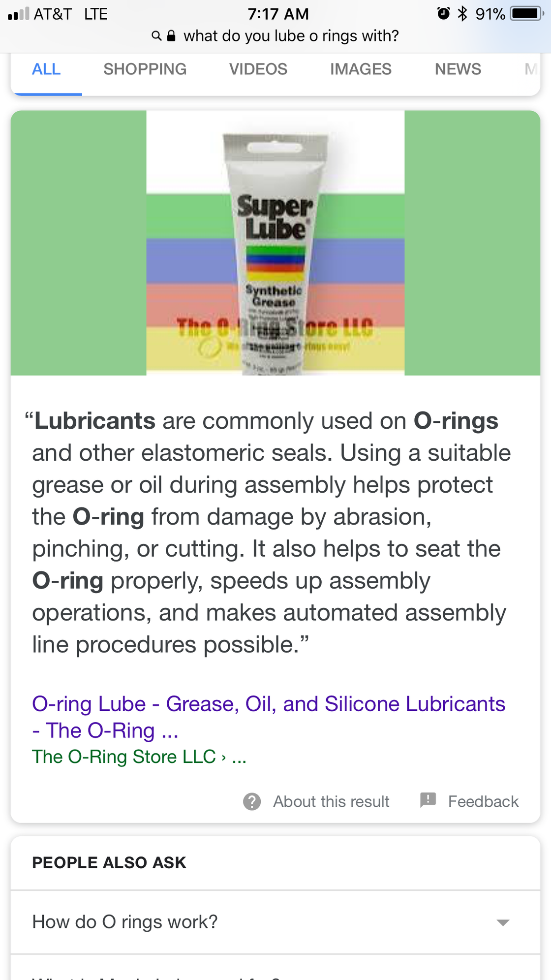

Well I am finally getting around to installed the second radiator.
Question. Is there a lubercation that is okay to use o-rings that I can put on the coolant hose connectors? I bought the hoses I posted. Great quality just were super tough getting them on the radiator. Didn’t know if I could use a little WD-40 or oil or something to get them to slide on the radiator fittings easier. Last time I had to use a soft blow hammer.

Would something like this work?
Did you remove and reinstall the snap rings

Firefighter 1406's Avatar
Firefighter 1406
Joined: Mar 2004
Posts: 5,372
Likes: 108
From: Northern Indiana
No. Not the first time. Should I just do that instead of some type of lubercation.
