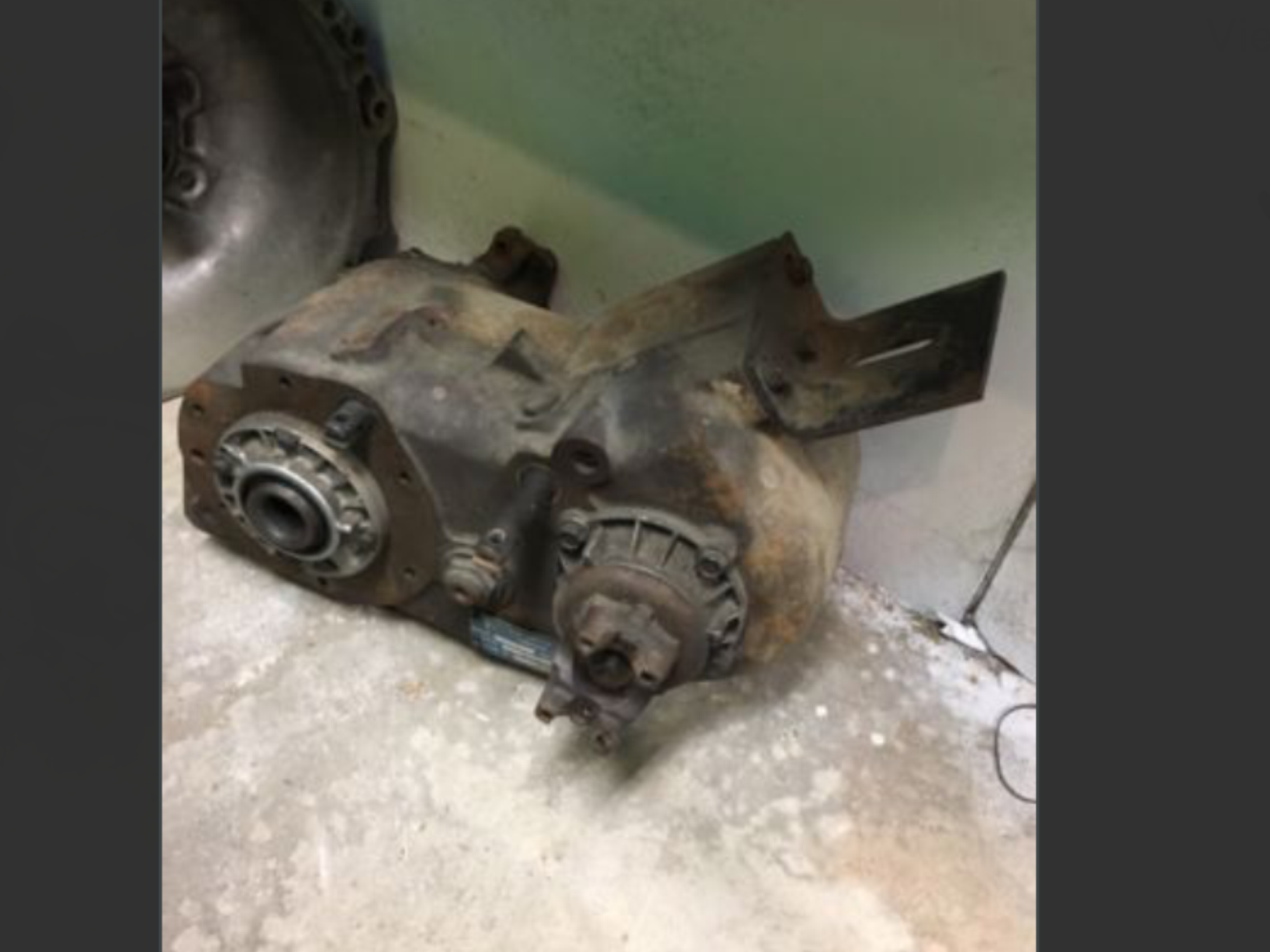

In my 62 F100 the shifter linkage is completely unhooked. Can someone tell me which position the 2 plungers which determine 4L N 2H or 4L should be in for 2 Hi? Like should the passenger side one be all the way in for 2 wheel drive or the driver side one in or out or what? Need this info just into I get the linkage fixed next month so I can drive it right now. Thanks yall btw it's an NP205

If both shift rails are all the way in that would be 4 low, one click out on both rails is neutral, then another click out on both is 2 hi and the final click is 4 hi. There are interlocks so you have to move both shift rails at the same time to not hit any of them. If you try to move the rails independent of each other there are certain combinations that don't work.
If you look back at the picture you posted that is similar to yours you can see a flat horizontal bar that connects the shift rails together. That bar moves both shift rails in unison, taking any guess work out of it.

EXCELLENT!! Thank you Chad. You are an immense help.
