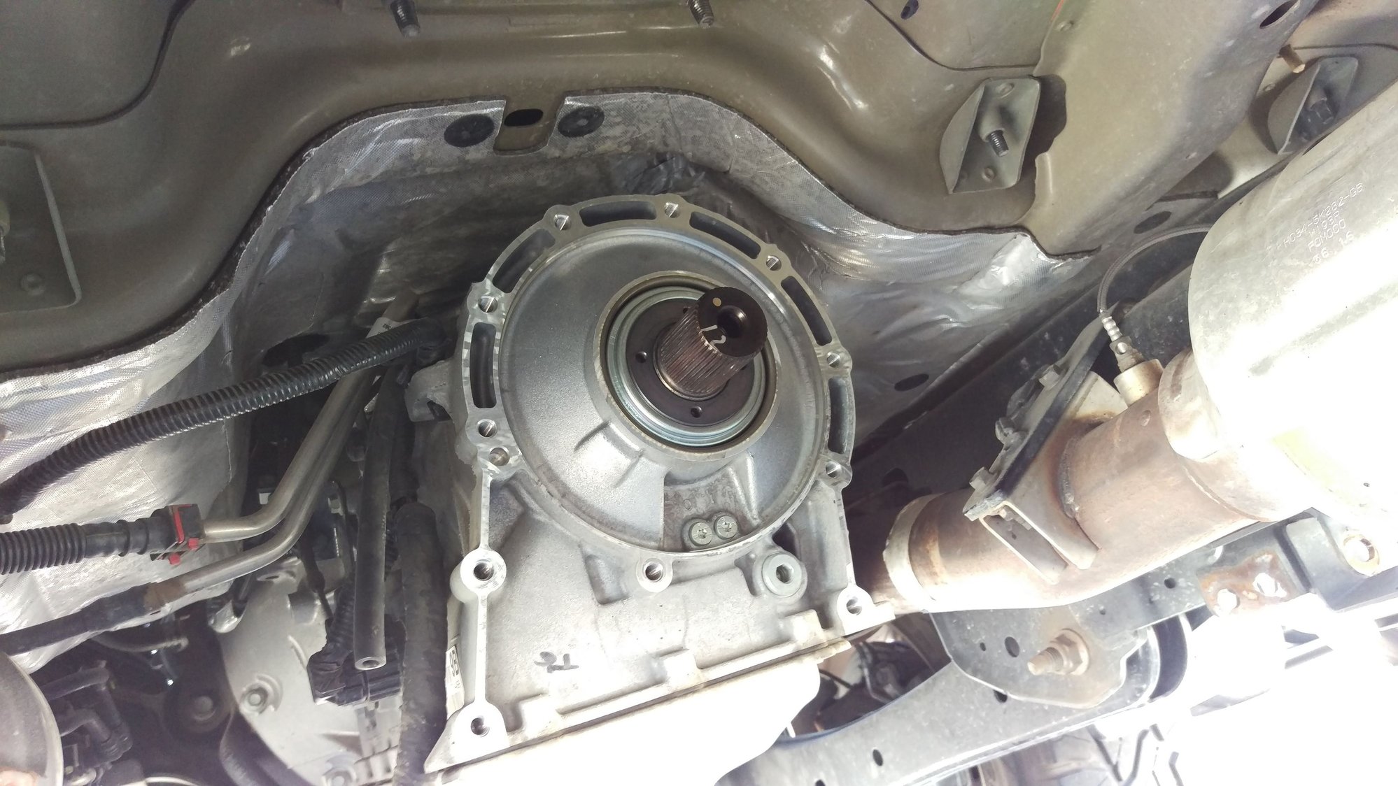

Stopped by the dealer to pickup a loaner and talk to the service writer who is in charge of my truck. He was gone when I was there so i didn't get to talk about the damaged parts. Another writer pitched in and gave me a look at the service order. It showed that they're waiting on about 10 parts including a synchro gear, seals, a pump (which I didn't know is in the t-case) another gear and a couple other things. I didn't see anything about a chain. Maybe there is no chain in the BW transfer case? I was hoping to see the innards but will have to see them at another time.
He did set me up with a nice new F150 though. First time I've driven a 2.7 ecoboost and I'm impressed. The little truck sure does feel small and the steering and suspension is super floaty. I want my F350 back.
See anything missing in this photo?

i dont think ford has used gear drive tcase since late 70's. far as i know every truck has used chain drives for alot of years

" See anything missing in this photo?"
DIRT, Any road grime ?

i feel for you, this is my first truck without a lever for 4wd, and i must say I feel helpless every time i am hopelessly waiting for 4x4 to engage at the turn of a ****, no way to "feel" if something is not engaged or "right", i do not understand, oh well.. progress
AFAIK these t-case's are chain driven with gear reduction low range, not sure of the model #, the old ones were np271???
LOL! This truck spends most of it's time on pavement for sure but it also wanders off onto gravel roads and the occasional sand wash, sand dune or slick rock. I guess that stuff leaves no trace. No significant mud yet.
