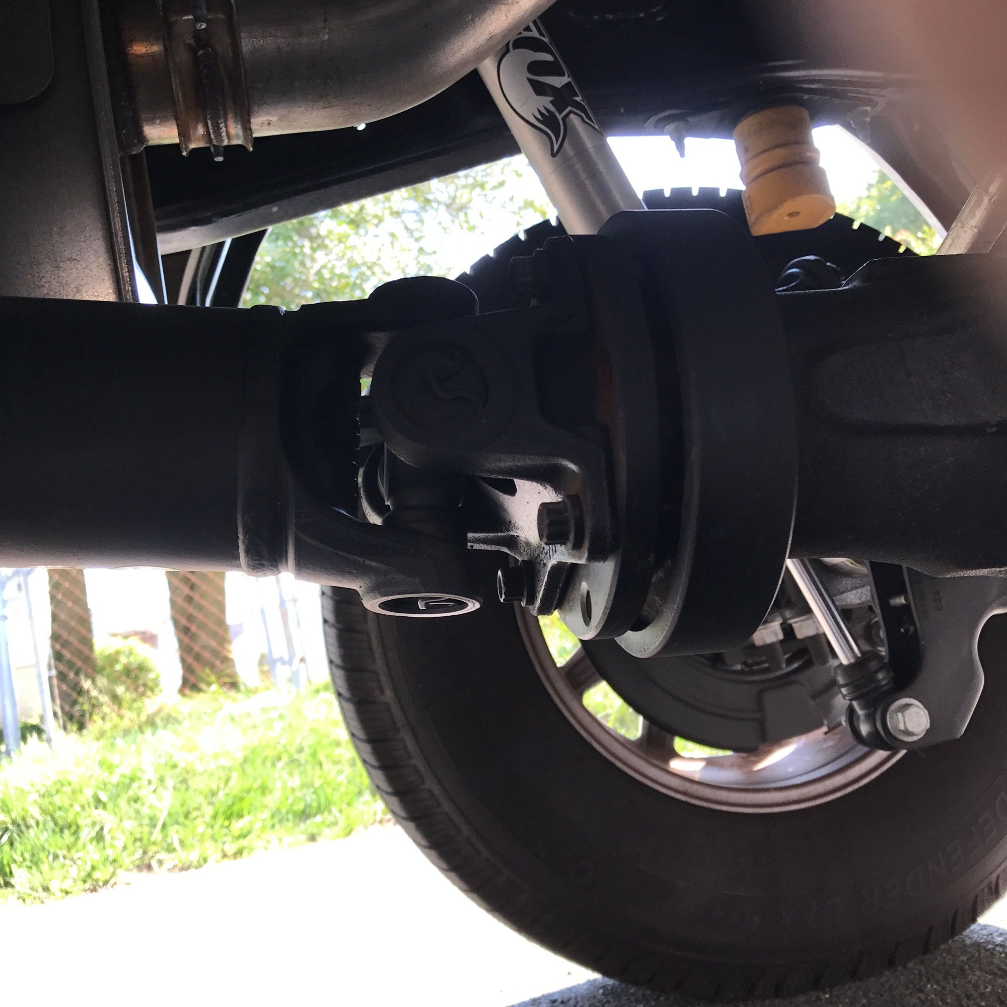

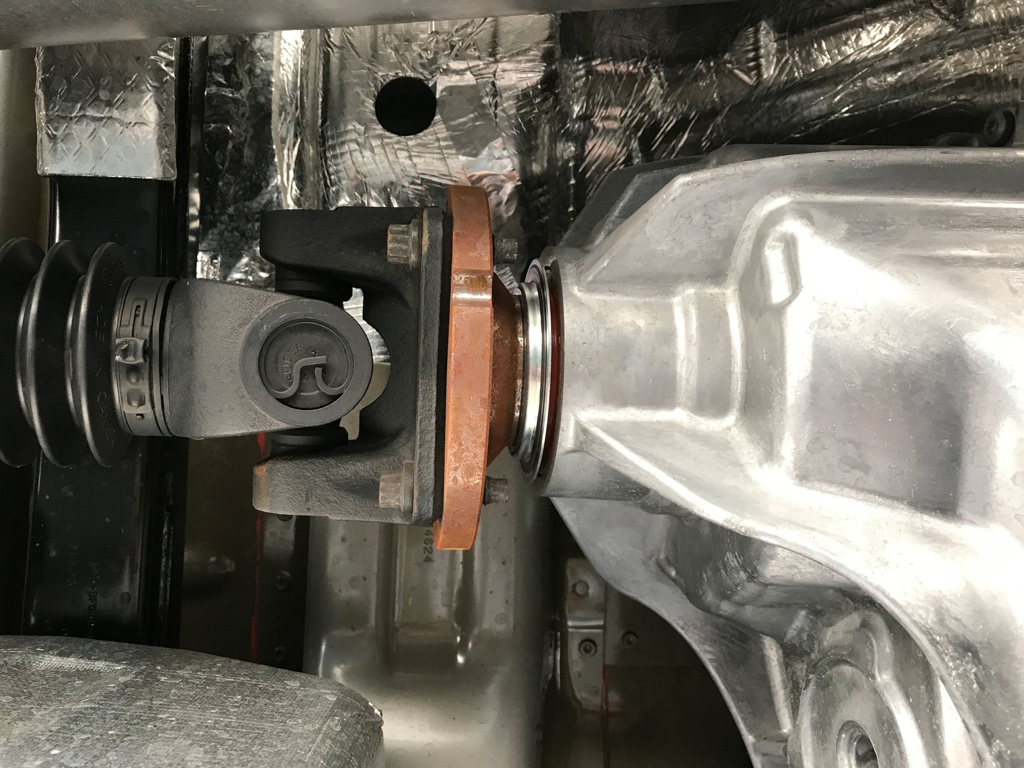

Originally Posted by Hackenbush
17 F-250
That is a proper t-case output.
Pull the drive shaft and the oil stays in the t-case.
17 F-250
I thought Ford would want to save on parts. So now the Reg Cabs get a flanged short tail shaft? Sweet, I have one on order.
So that makes three different output shaft designs?
