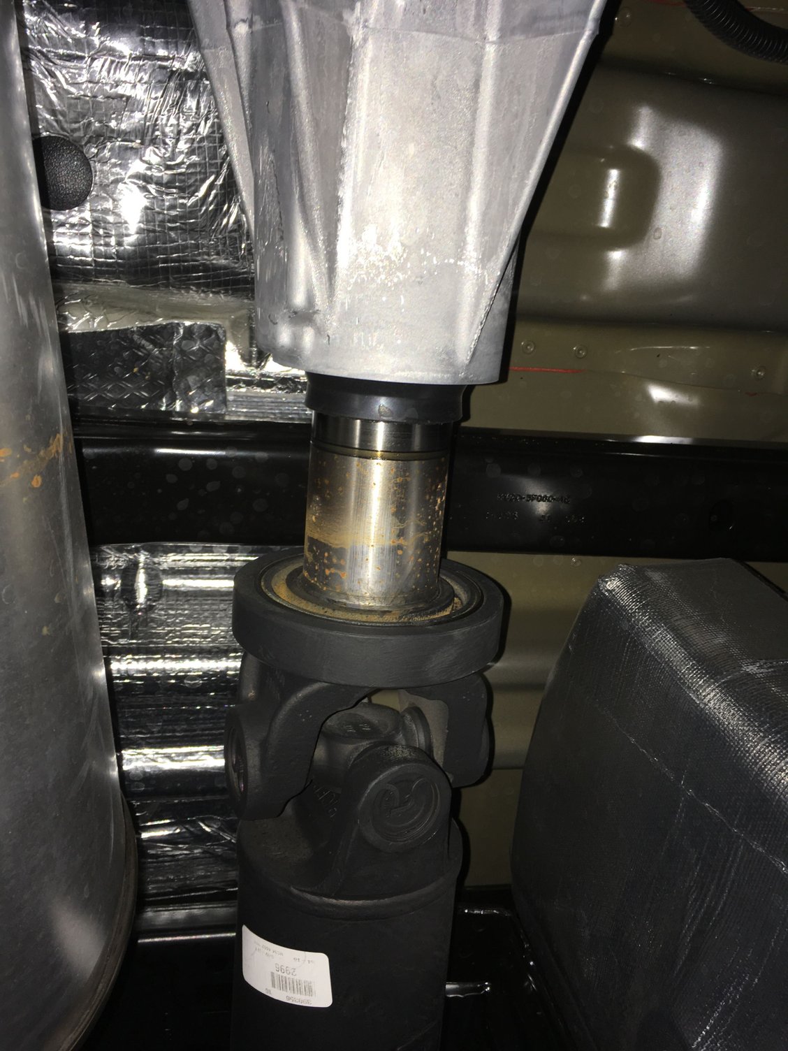

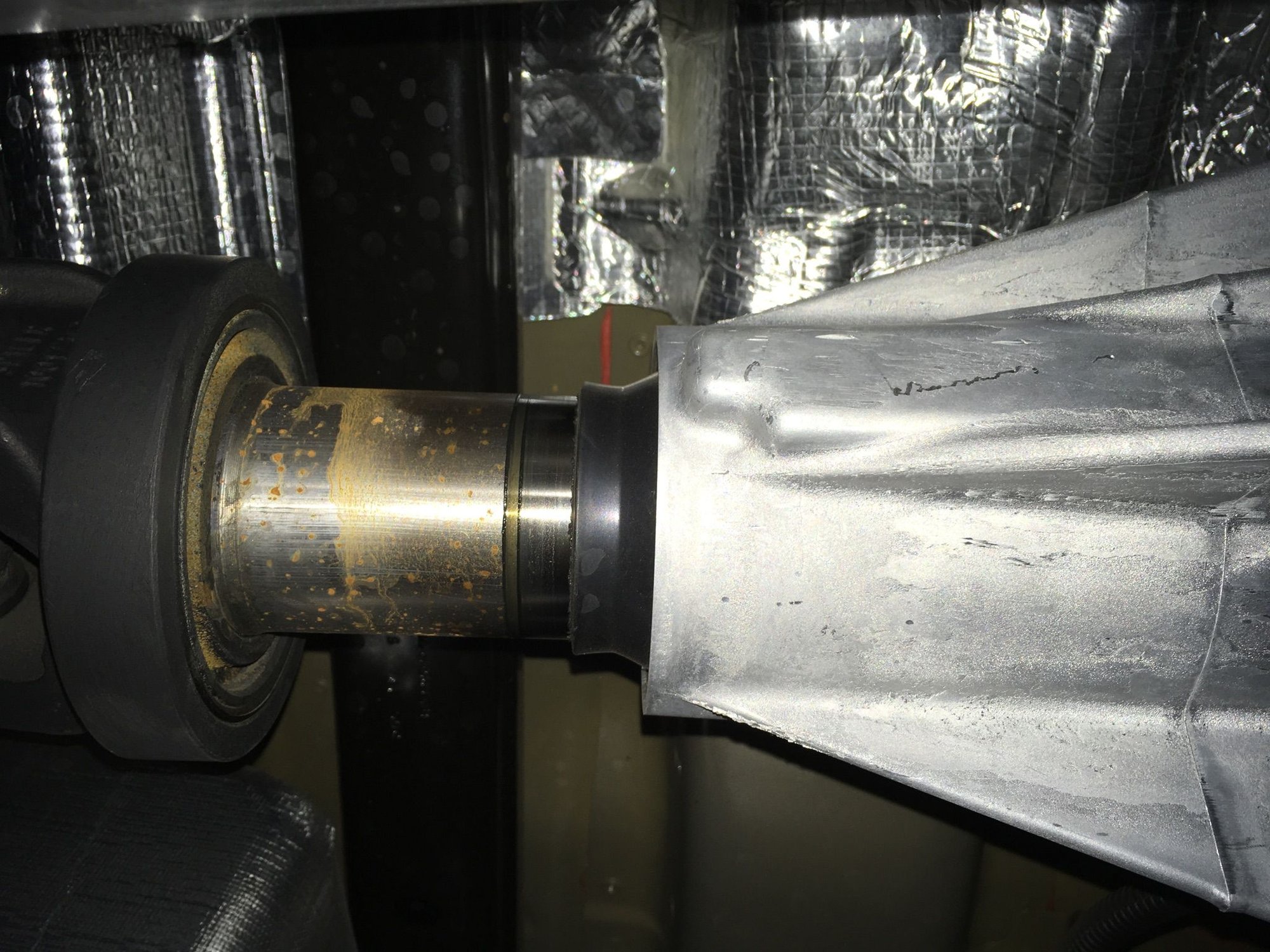

Originally Posted by EpicCowlick
That is interesting. Here's a full side view. The only way to remove the drive shaft is by disconnecting the U joint. I wonder what is different. Mine was built mid October last year.
Maybe the change in geometry of your front end lift affected your transfer case
I see clean metal on the shaft vs weathered metal. Did leveling the front end cause that or is that how it was from the factory/lot?

Any amount of level shortens the drive shaft. Same for the rear if the rear is raised. Also Crew Cab Long bed = 2 piece drive shaft ?
Reg Cab long bed = one piece drive shaft U-Joints both ends ( rear ), and U-Joint at front axle and looks like Constant Velocity joint @ Transfer Case but no slip joint.
Not sure about extended Cab don't own one.
That's completely normal. It slides in and out with suspension movement. They are all like that including mine which is not lifted or leveled.
AFAIK, long bed, crew cab trucks have a two piece shaft with a central joint and carrier bearing.
Yep! From my F250 Supercab, stock

What's weird is the tail ends on the transfer cases are different. The one like Epic's uses a slip shaft, and the other is a fixed bolted yoke with a shorter tail end housing.
I wonder if the F-250s get the longer tail end housing with the slip shaft?
Here is a better picture. F250 Supercab
Ok, I think I've figured it out. It depends on the wheelbase. The reg cabs, super cab short bed and CCLB get the short housing, while the CCSB and Super cab LB get the long nosed version.
