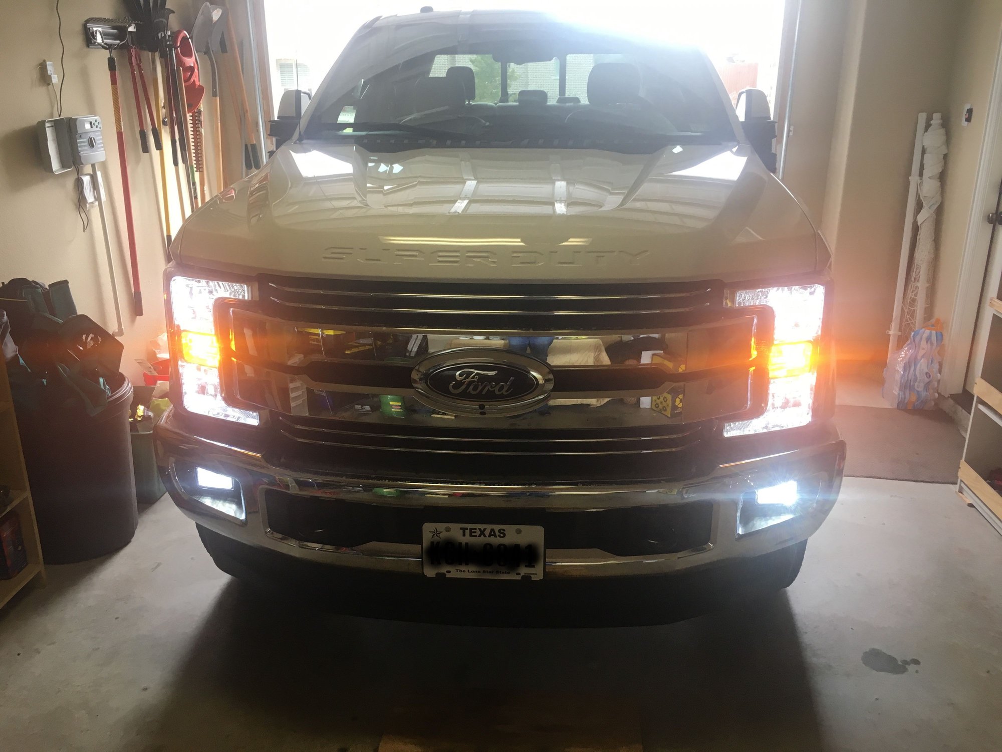

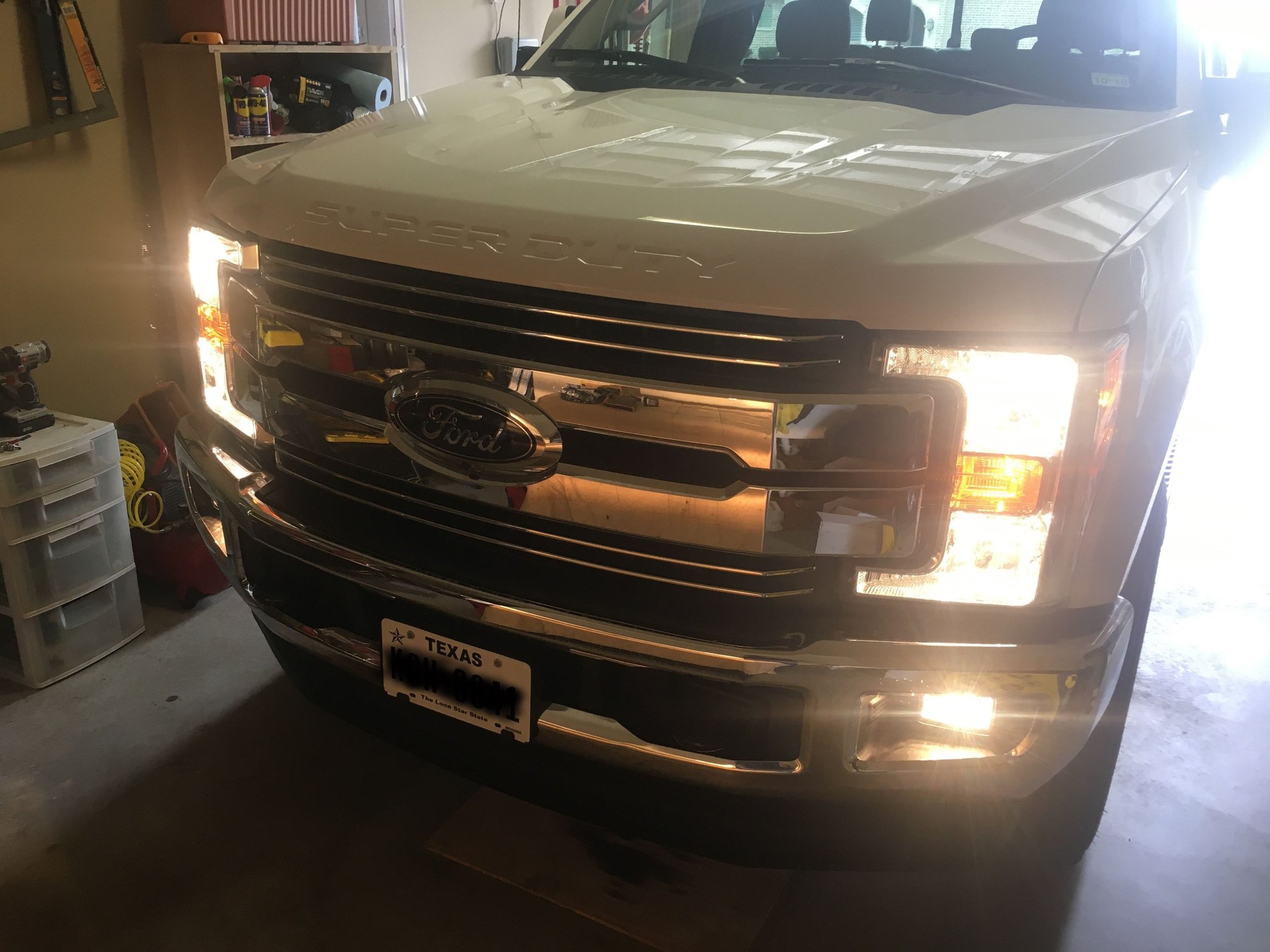

Did the entire conversion yesterday.
Headlights
Switchback front turn
Front Marker
Fog bulb replacement
Reverse
Brake/ Turn lights
License Plate
Came out real nice. The resistors are a bit of a pain, not hard, just a pain. I did strip the wire and solder them on so it took more time.
Tips for those who are going to do it.
1. If you have a camera in your Front Emblem. You can simply slide your removed grill off to opposite side to work on each headlight with camera cable still attached. I used a piece of wire to secure it so it was not just supported by the cable going to the camera. I spent about 10 seconds trying to figure out how to get the camera cable off and noticed I could move it to the side so I went that direction.
2. Find where you want it and predrill holes for you resistor screws
3. The resistor wires you want to connect to are the outside wires on all 6 plugs (2 front and 4 rear)
4. Access the fog light bulbs from the inside. I first tried to do it like the guy on the HR video from the outside wheel well and it sucked. I am a big guy with big hands...still more room coming from inside.
5. When doing taillight turn signal test make sure both resistors are connected or you will get hyper flash. I had a wire come loose and it hyper flashed on me when testing. I secured the wire and it takes a few seconds for the computer to decide it is good.
Before
After
