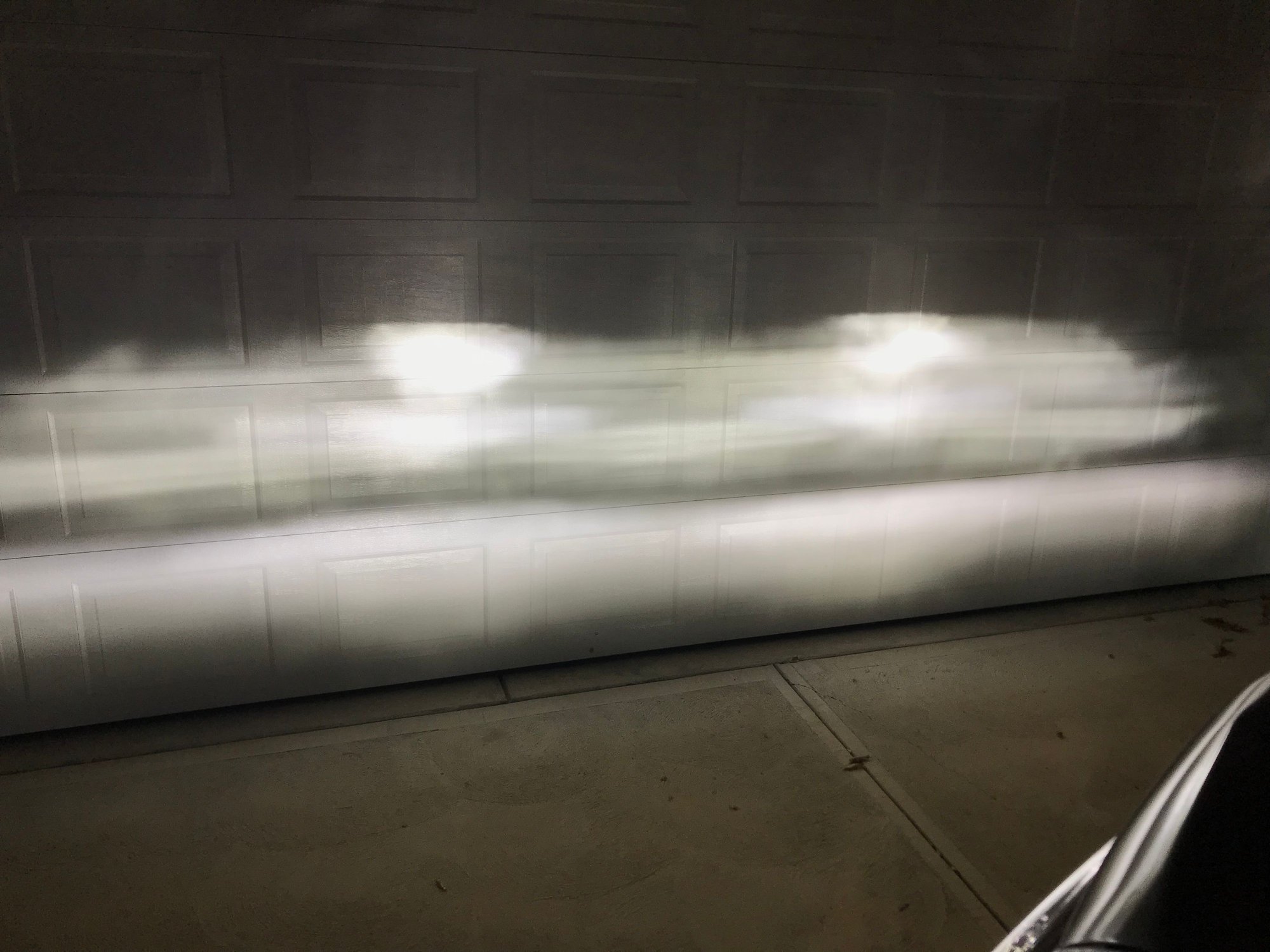

I installed my HR headlights and fogs tonight, and have included some terrible pics below. The first is after installing driver side, the second is after driver side fog was installed.
I went ahead and removed grill and headlight assembly, at least on the driver side. Super fast and easy...until I got to that 4th screw down by the bumper. I barely had enough room to force in a 1/4" drive 10mm socket, nowhere near as easy as the guy in the video shows. Even less room on the passenger side and I was never able to get the socket seated. I did what RedRocker recommended in the first place and took the air intake out. Swapping out that side was easy after having just done the other. One mistake I made was that the red factory gasket/o-ring on the upper lamp stayed behind. You're working blind, so no way to tell. Made it impossible to twist the replacement in until I finally discovered it.

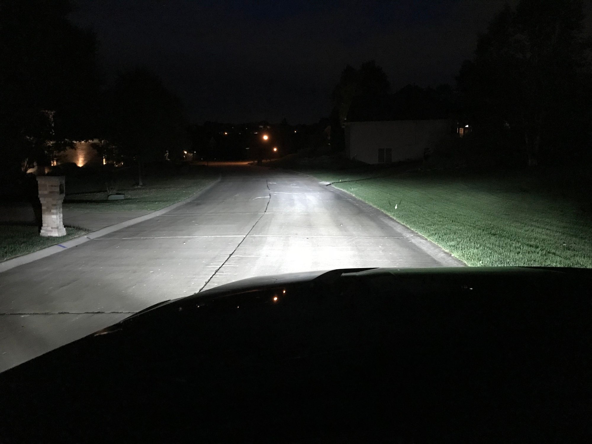

Hey Guys. I received the Supernova V3 LED fogs which match my Supernova V3 LED headlights. I took a few pictures for you but also captured a video to give you a better feel for what this set up can do for those with the stock incandescent bulbs.
I am highly satisfied with this set up. I needed a truck quickly and I had a hard time finding a Lariat Ultimate with a front bench AND factory LED's. I found one with all the features I wanted except the LED's. So my quest began to upgrade the headlight situation since the yellow incandescent bulbs are rather lacking, in my opinion, in light output and quality.
What I am probably most impressed with is how evenly the light is filled in between where the headlights hit the ground and the front bumper. Our headlights are pretty high up the ground and there is quite a bit of space to fill in. The Supernova's handle the job perfectly. Hope this helps others looking to upgrade their lighting situation.
Fog lights off.
Fog lights on.
Fog lights off.
Fog lights on.
Here is the video I made to give you a even better feel for what this set up is all about.
