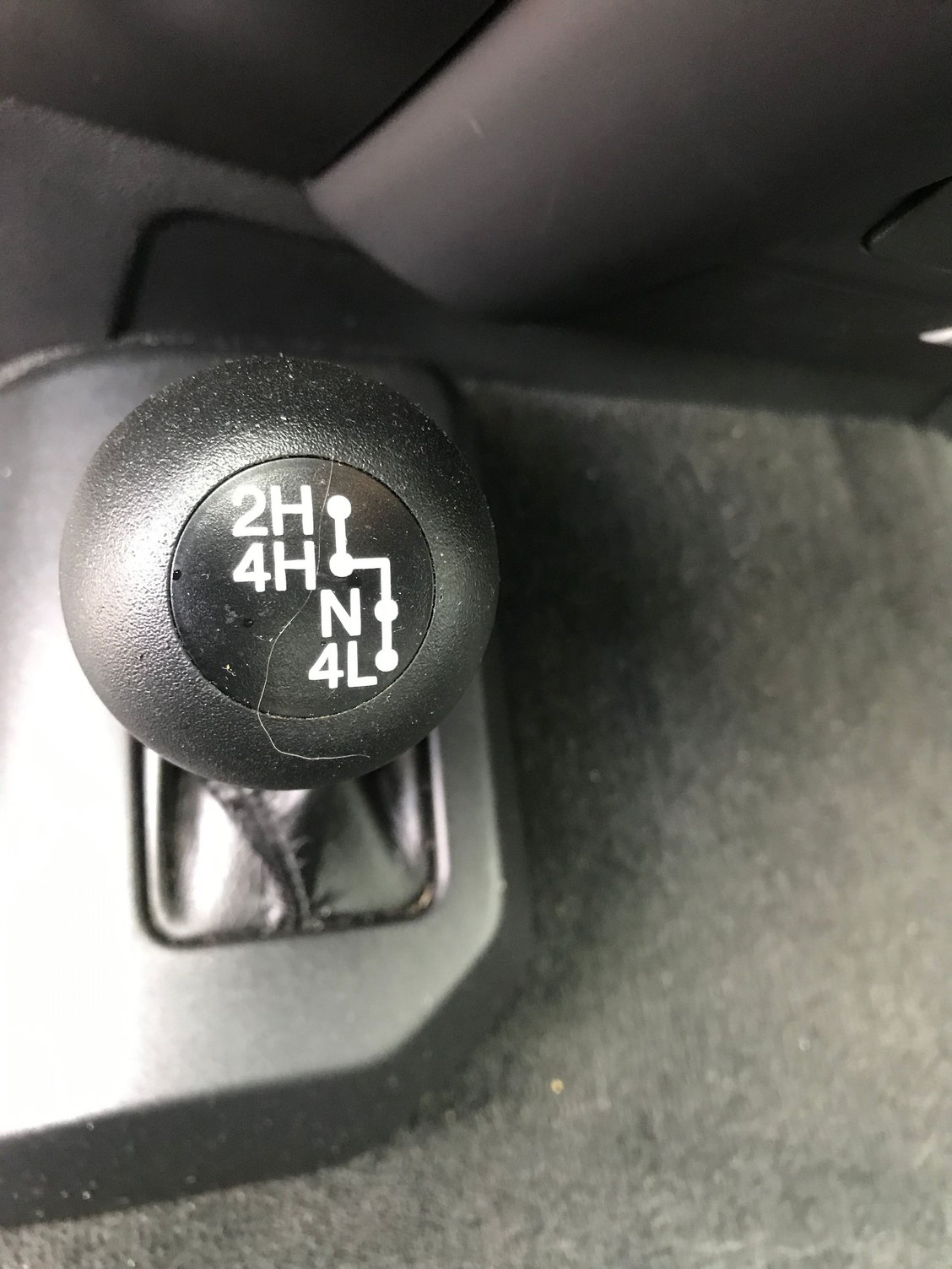

The transfer case for 2017 is definitely a new unit and unrelated to the old 271/273.
The workshop manual (thanks Habemus Quattro) indicates the ESOF now has an electronic clutch which allows smooth synchronization between the front axle which is not up to speed and the rear axle which is. It appears the hub design has changed from a pulse vacuum to a constant vacuum design.
The manual shift design still uses the new transfer case, but does not have the clutch. It still uses the same principles as the old case, meaning (despite warning against doing so) you can still shift on the fly when the hubs are already locked and the front and rear wheels are turning at the same rate. One noticeable difference is the floor shift lever is new, and uses a straight line pattern versus the old dog-leg pattern used forever. It also appears the manual floor shift uses a shift cable, much like the transmission shift cable, to change between 2H, 4H, 4L. The old design used a lever.
I think the electronic clutch design of the ESOF case is very interesting because 4x4 is engaged at least initially with a clutch...much like the "auto" position of the F-150 system. The manual then states once 4x4 is engaged, a mechanical "collar" slides into position, locking the two axles together and making the clutch irrelevant.
One last thing of interest on the new t-case. The electronic version apparently takes information from the steering angle sensor and uses it in some manner. It does not explain how, but perhaps it prevents a 4x4 shift when the wheels are turned sharply?

Both my 2017 manual shifts still have the dog leg pattern for N & 4L . But they do shift by a cable now.
Excuse the dog hair I have 2 Border Collies.
You are correct...thanks! The housing and lever is new anyway!
