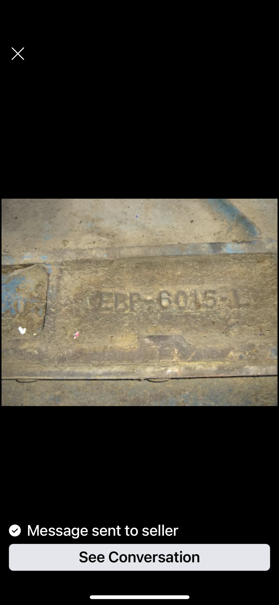

Need help on identifying this engine. Came out of a forklift that had no id info to determine make or year.

That appears to be an older Ford six, probably a 223, possibly a 215. Unlikely a 262.
EBP 6015 L is a casting number last used in 1959. The head appears to have the later 8 bolt mounting from '60 to '64. The block casting could have carried over into the '60s, I am not sure.
Discussion of this engine, casting number etc:
https://www.ford-trucks.com/forums/7...-6015-1-a.html
https://www.ford-trucks.com/forums/1...223-block.html
Looks like it's a propane engine.
