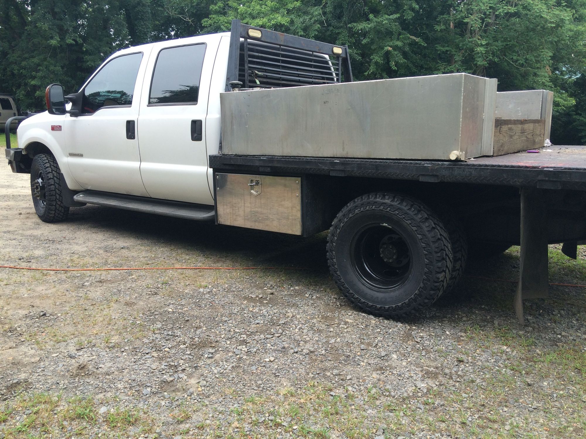

I started with a 110gal tank/toolbox combo. It was well into the back window and made it where I could not see the bed. This really sucked when hooking GN trailers up.
Then I went to a custom 200gal tank in the same place (front of bed). It wasn't as tall, so better visibility, but still left my 9ft bed with just over 6ft of useful space.
Currently, the (2) 100gal tanks are the BEST. I put 'Z' channel on the back of the tanks so I could drop a 'tailgate' between them, so for the first time since I've owned this truck (15 yrs now) I have close to a pickup bed! I can haul a load of mulch or just toss bags of trash in the bed w/o having to strap it down!! I can also strap a refrigerator to headache rack (not possible with front-of-bed tanks). I left 3ft behind tanks because I use my bed as a work table all the time and couldn't give that up.
Great solution! Especially since the bed is so wide. Curious how/where/how much to get the custom tanks?
Local welder/fab shop. $1000/ea several years ago. They are 3/16" alum. My specifications were 'thick enough a fat girl can dance on top of them'. Lol
That price may seem steep, but on day one I filled those tanks to the top with 'free' fuel. 200gals x $3.xx/gal. Even though fuel at the pump is a little less now, I have filled those tanks MANY times since that day and ROI was a long time ago!!
And yes, 8ft wide bed means I have 4.5ft between tanks.
