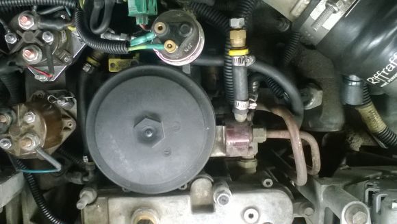

Can see to left/right of pressure sensor
Yup, 4yrs 110k on straight cholesterol diet for the truck, here too... Until I moved closer to daughter than it wasn't needed. Sold the system to a 6.0 dude on clist. Definitely put $$$ in my pocket for these last couple years of running d2.
. I used, still use the post port to feed the front head ports. Using a jic T, and 300# fuel line with pushloks. 1/8npt couplings with 1/4jic male to attach puskloks. I carry a spare set for just in case.
Had about 3k in system(that's with the filtering and centrufusing system at home), but damn, paid off in no time when d2 was 4.00+ gallon...
I entered a truck pull last night. Pulled 221' in the Diesel Work Truck class. Not the best but pretty dang good for an aging platform running on Waste Vegtable Oil.
