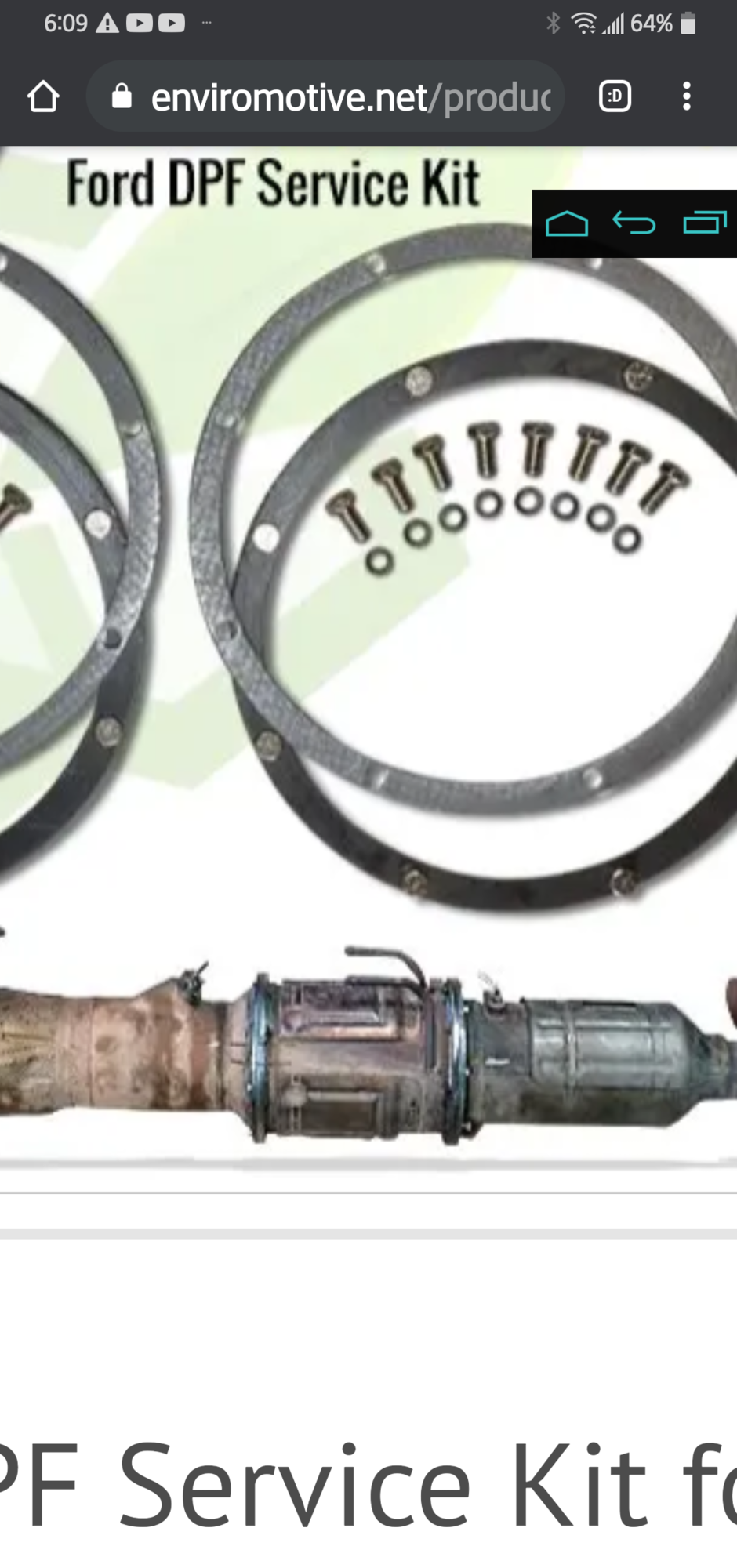

Enviromotive Ford 6.7 DPF service kit
This is the kit I was talking about. Someone else posted it here awhile ago in a different thread. It's made to make the Filter part of the Ford rocketship removable so it can be serviced and/or replaced if need be.
https://enviromotive.net/products/fo...env-sk-f-2002/
