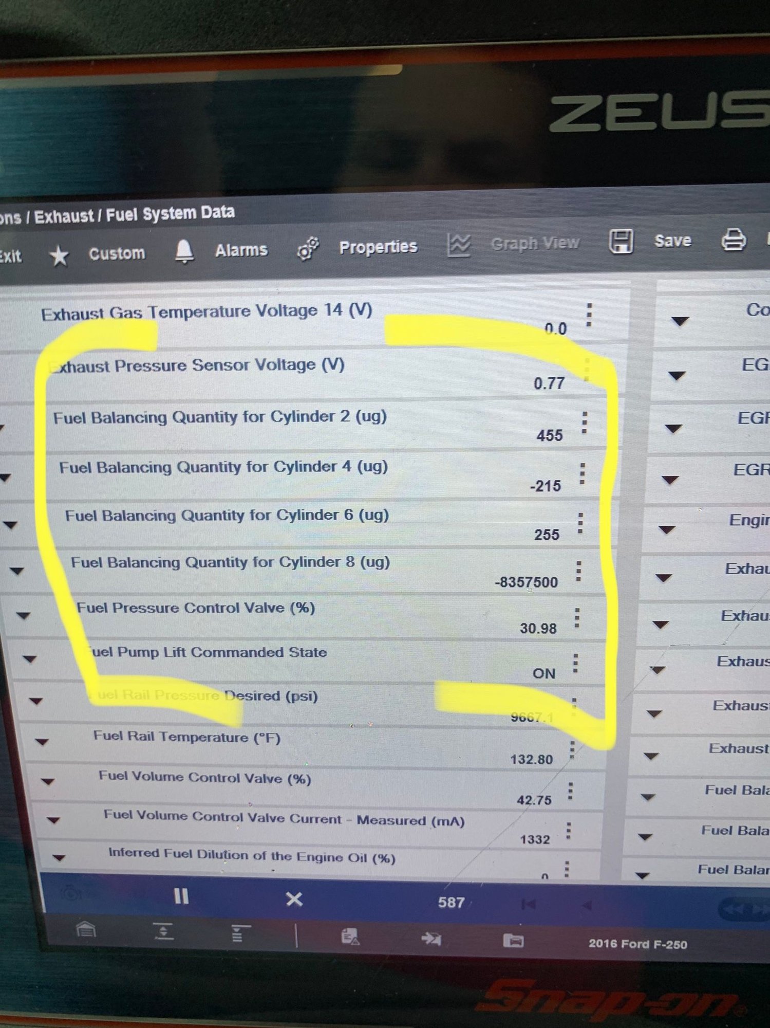

However that gave me a good idea I’m gonna leave the snap on scanner on it and do a little test hit since that’s when I’m having the issue versus looking at it from a idle

This is what it shows on the fuel balancing….for the injectors it’s shows even across the board. Most definitely something going on this cylinder 8

I think it's the cylinder balance pids I was looking at but every other one was in the neg just a hair. I had no idea if it was good, bad or what. Google didn't give much info either and I think I asked on here but I didn't get a reply so I thought most of not anyone looked at that

8 does look funky. Probably time for a replacement. I haven't found acceptable balance rates online either.
