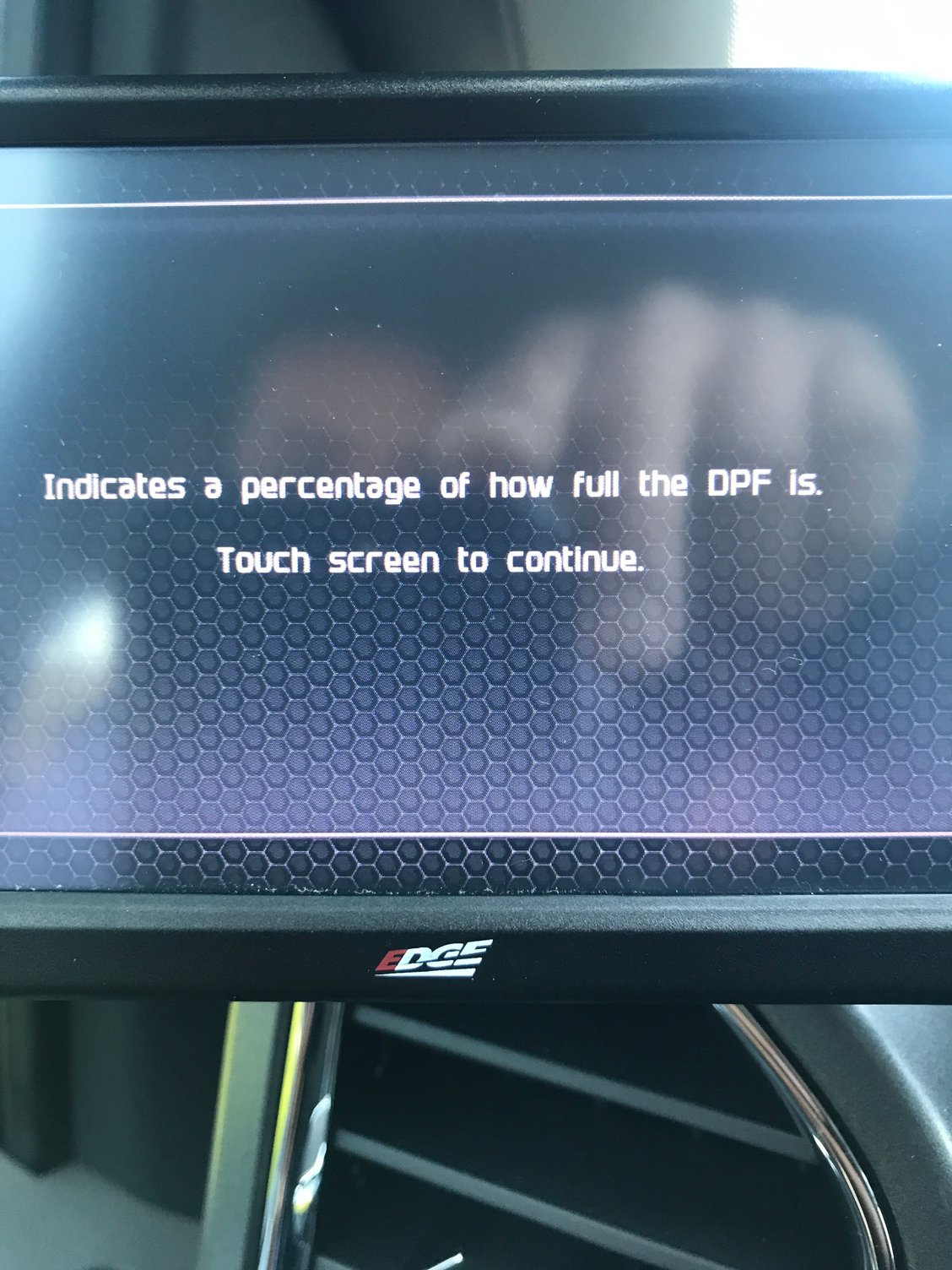

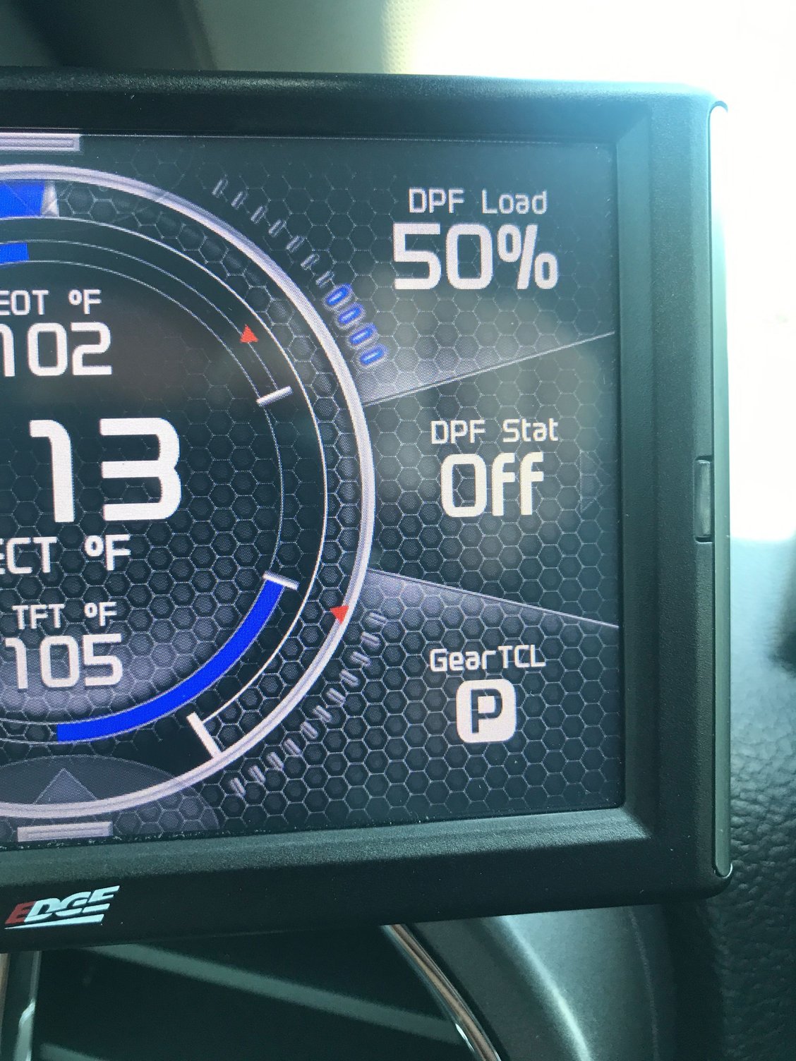

I know this is an old thread. I purchased a 2018 6.7 6 months ago. I've been monitoring regens since February to give me an idea when my truck regens. After Edge released the update to my CTS2 a month or so go I was able to see the DPF%. Up until a couple regens ago, my 6.7 didn't regen until the DPF% hit 100%. The last two regens the DPF% was only around 66% and only a tad over 200 miles between them. I'm just curious if anyone else has seen this behavior?
There's a mandatory 500 mile regen that doesn't care what the dpf % is.
My CTS has DPF Load expressed in %, but it is different than the %DPF Full shown on the dash screen, so you need to be clear about what your are seeing as those two things don't often agree.
Old Jun 4, 2018 | 09:58 AM
  #66
SkiSmuggs's Avatar
SkiSmuggs
Joined: Dec 2015
Posts: 1,040
Likes: 9
Yup, but it still usually doesn't agree with Ford's dash indicator. I've seen the dash say DPF Full, when the CTS DPF Load was only 15%, usually during towing trips.
