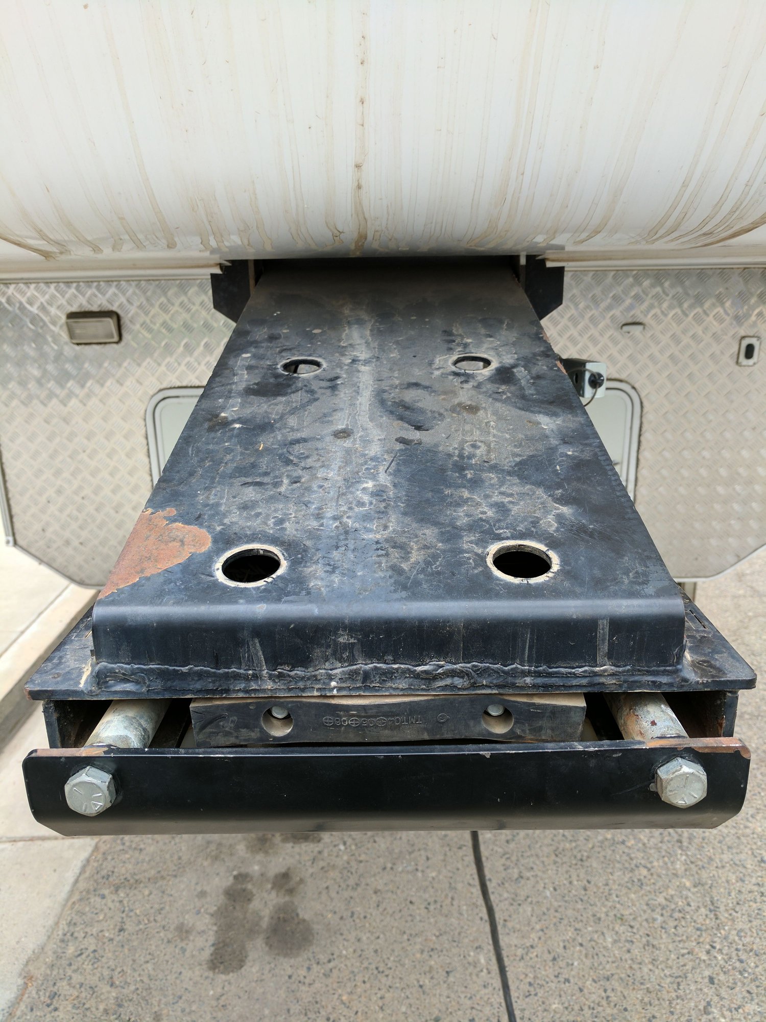

So decided I would check the pinbox today.
If anyone decides to do this, have a helper, the plate is heavy. I have to use a floor jack in the bed to lift and align it.
I wanted to check the Teflon glide pucks as they have surface cracks.
Unfortunately the bolts are rusted and I will probably have to cut them off. I don't have the replacements yet.
Another big tip, Unbolt the rods first, then do the pad bolts under the rubber caps. I did it the other way and it had tension on it.
I'm going to order a new plate, pucks and rubber covers. The pin plate appears to be slightly bent.
Here are a couple of photos.
Keith
P.S.
Sorry its so dirty, just got back.
The paint / powdercoat they use is worthless. When I replace parts and will clean it and repaint it.

I think that's the way the pin plate is (slightly bent) mine is the same way. I'll probably replace those bushings this winter they're looking a little rough also. I'll follow your advise on tear down.

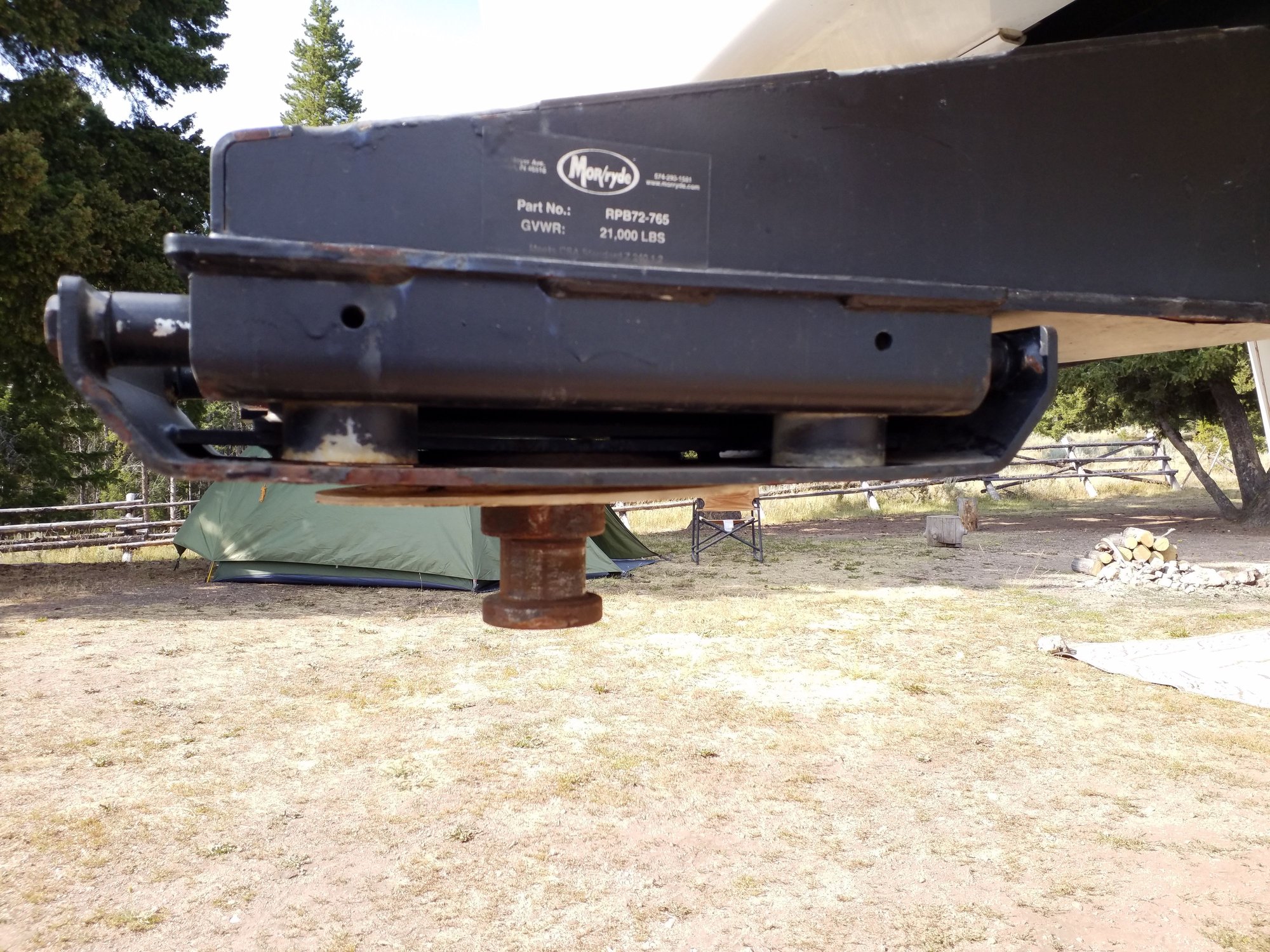

I just put one on my Cyclone this week, how do y'all like them?

My last 5th didn't have one and you could feel the bump/pull in the truck now I feel nothing a good improvement.

Thanks, that's good to hear, never had anything but a fixed pinbox, first pull tomorrow. I'll be putting airbags on my 6.7 soon. I hope the combination really improves the tow.

I think you'll notice the difference and enjoy the feel. Lets us know your experience.
Thanks,
Mine is actually bent side to side.

I've had mine for about 3 or 4 years now and I like it. You get a little rubber band effect, but it takes the place of jerking and jolting so it's a favorable trade-off. I think the plate being slightly bowed is a result of welding in the kingpin during assembly. The relatively thin plate expands and stretches slightly while being welded and the plate gets a bit of a hump in it. I live in a fairly dry, salt free and acid free environment so I don't have any rust/corrosion issues. The only thing I notice is the nylon pucks are a little creaky, but I think a shot of dry lube like silicone should stop that. I think the Mor-ryde is a good product for the money.
That may be a possibility, I just don't ever remember it. I used to have it on a Reese Elite wide head and we would camp in the desert a bunch. It would not surprise me if it flexed out and slightly bent the pin plate.
I agree on the creaky. I will try some lube as well.
i am in a salt free environment as well. I swear they painted over the rusted steel. It's peeling in large flakes. When I redo it, I will most likely use something like POR15, or may just PC it.
