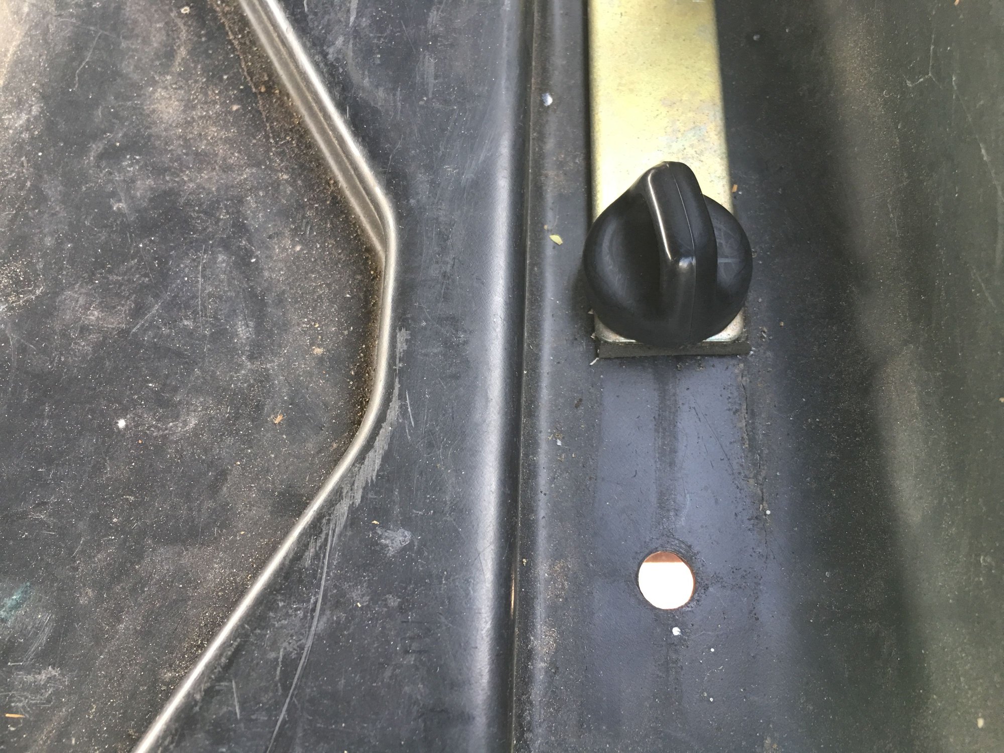

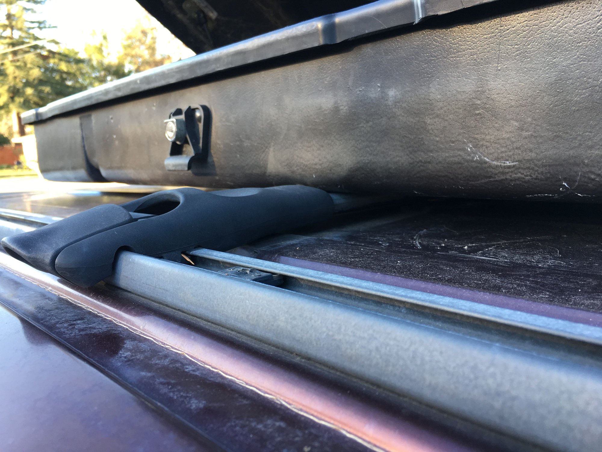

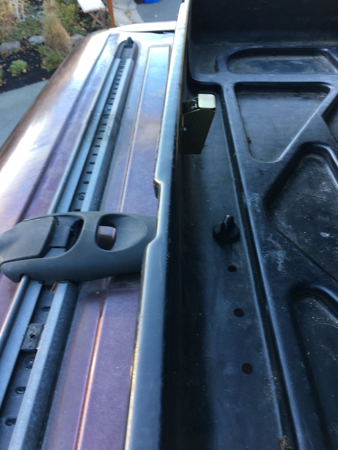

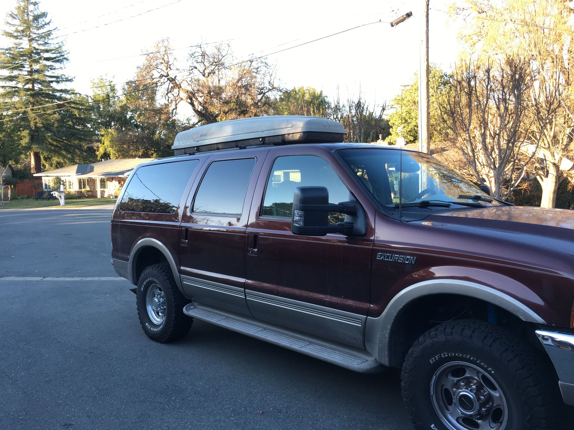

Here’s what I ended up doing with the factory racks. I know many folks justifiably remove them altogether, but my roof is in not-so-great shape anyway, so I decided to keep them on despite some minor rubbing.
I bought a cheap roof box off Craigslist. It already had some factory holes drilled into it for the factory hardware. I then simply removed the skinny cross bars and kept the bigger ones on, and used the skinny bars’ hand bolts to bolt the roof box to the strut nuts that are in the bigger cross bars’ channel.
I added a metal ‘washer’ plate for extra support but I’m not sure it’s necessary. 350 miles later I’ve experienced no problems. Pics:
Nice low profile
Before installing washer plate.
Washer plate.
