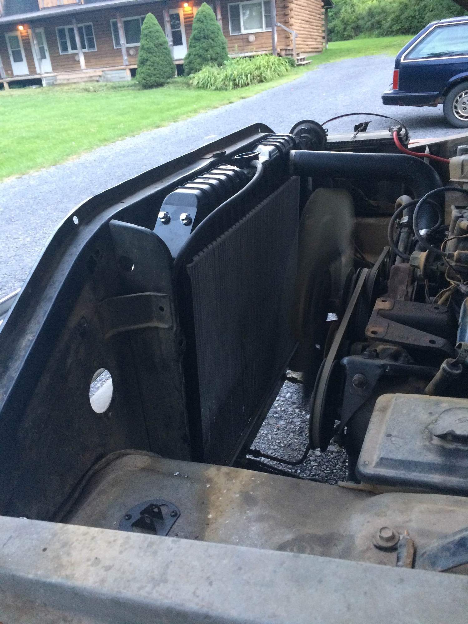

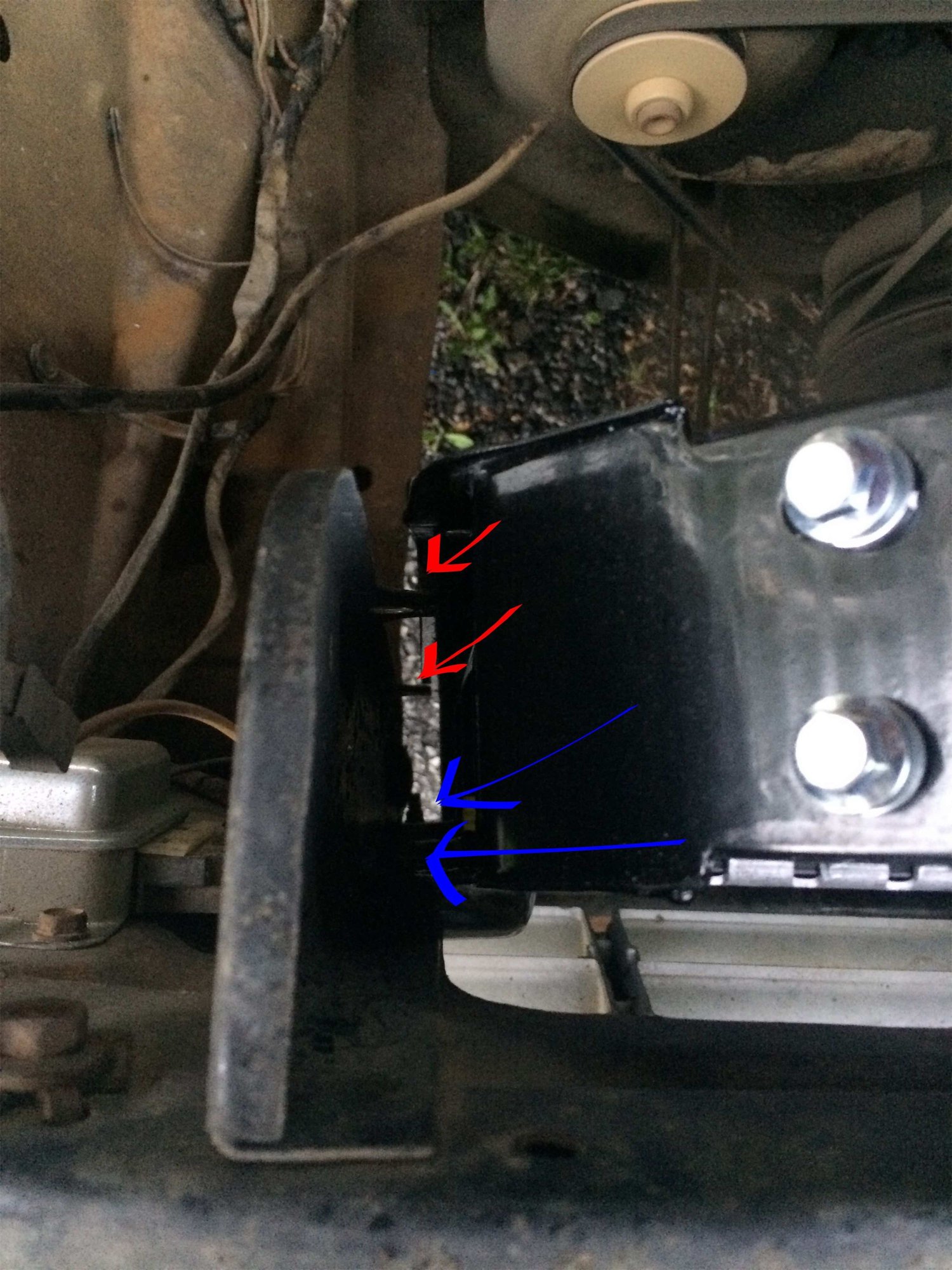

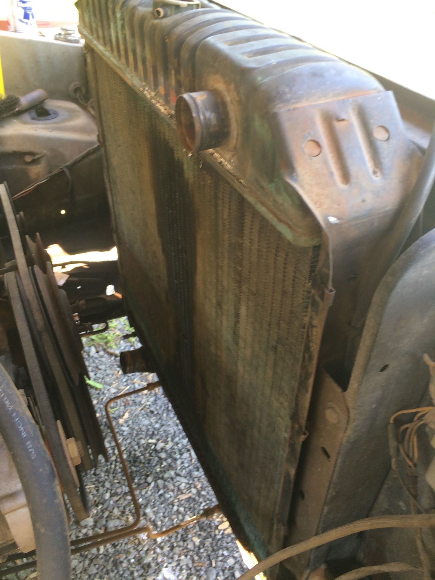

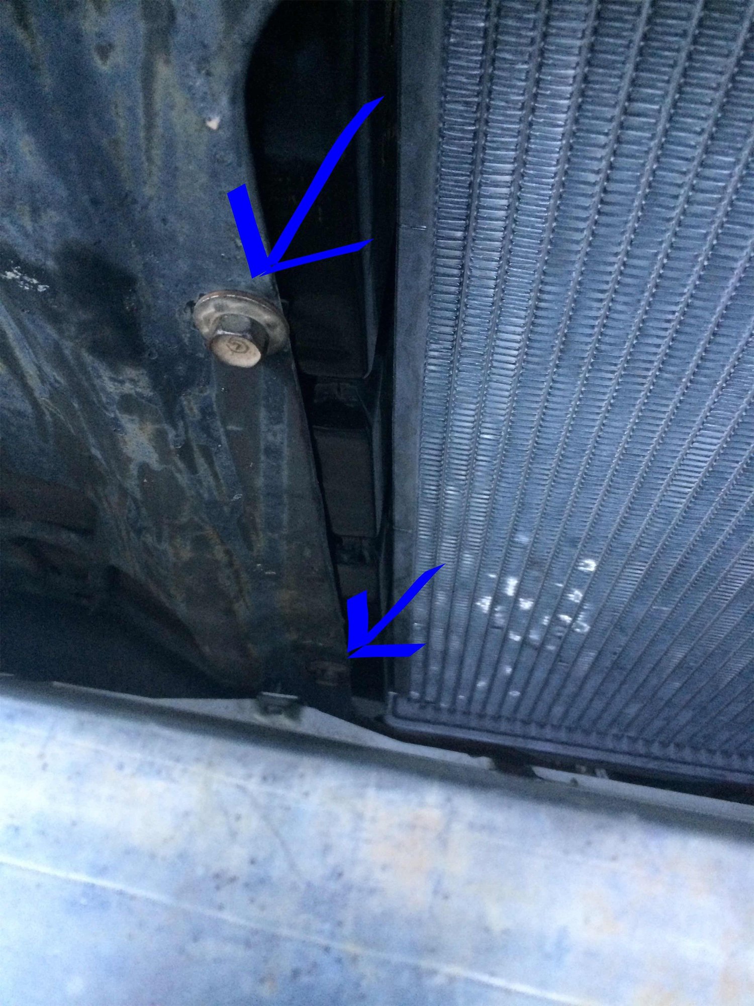

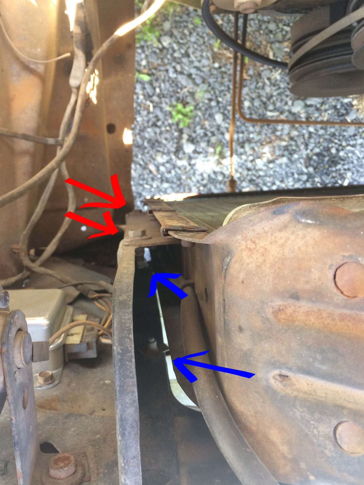

Ok, I swapped for a standard size, and am posting pics for anyone that might try this in the future. I mounted the new radiator to where my AC condenser once was.
Spectra "Premium" C132 radiator will bolt right into the Super cooling radiator support if you dont have the AC condenser installed. I had removed it some time ago. I am not sure if these mounting points exist on models without AC but with supercooling (if that is even a thing).
Got new radiator at AZ for $240: , and dont be fooled by the picture of the brass and copper rad, it is aluminum core with plastic tanks
I snuck the standard size radiator in between the support for the super cooling rad. Its tight but it does just barley clear. Also, my auto trans cooling lines did bolt up, but I had to snag the adaptors from the old rad. And the lines are a little flexed and touching each other, so I should probably put something in between them so they dont rub each other.
I posted some pics below: And be nice about the new radiator fins, if you look at those aluminum fins wrong they bend >..< . This whole job would be exponentially easier with a buddy (and a six pack) to hold the radiator in place while you throw the bolts in.

Showing old supercooling radiator mounting from top looking toward back of truck. You can see the super cooling rad mounting bolts (red), and the mounting bolts for the ac condenser (blue) where the new standard size radiator will bolt up to.
showing old supercooling rad mounting (ignore my feeble attempt to solder the breach in the tank to core, I couldnt see that the tubes right below it were corroded out.)

New rad mounted showing old super cooling mounting points (red) and new rad mounted where AC condenser was.
from front of truck showing new rad mounted to condenser mount positions.
