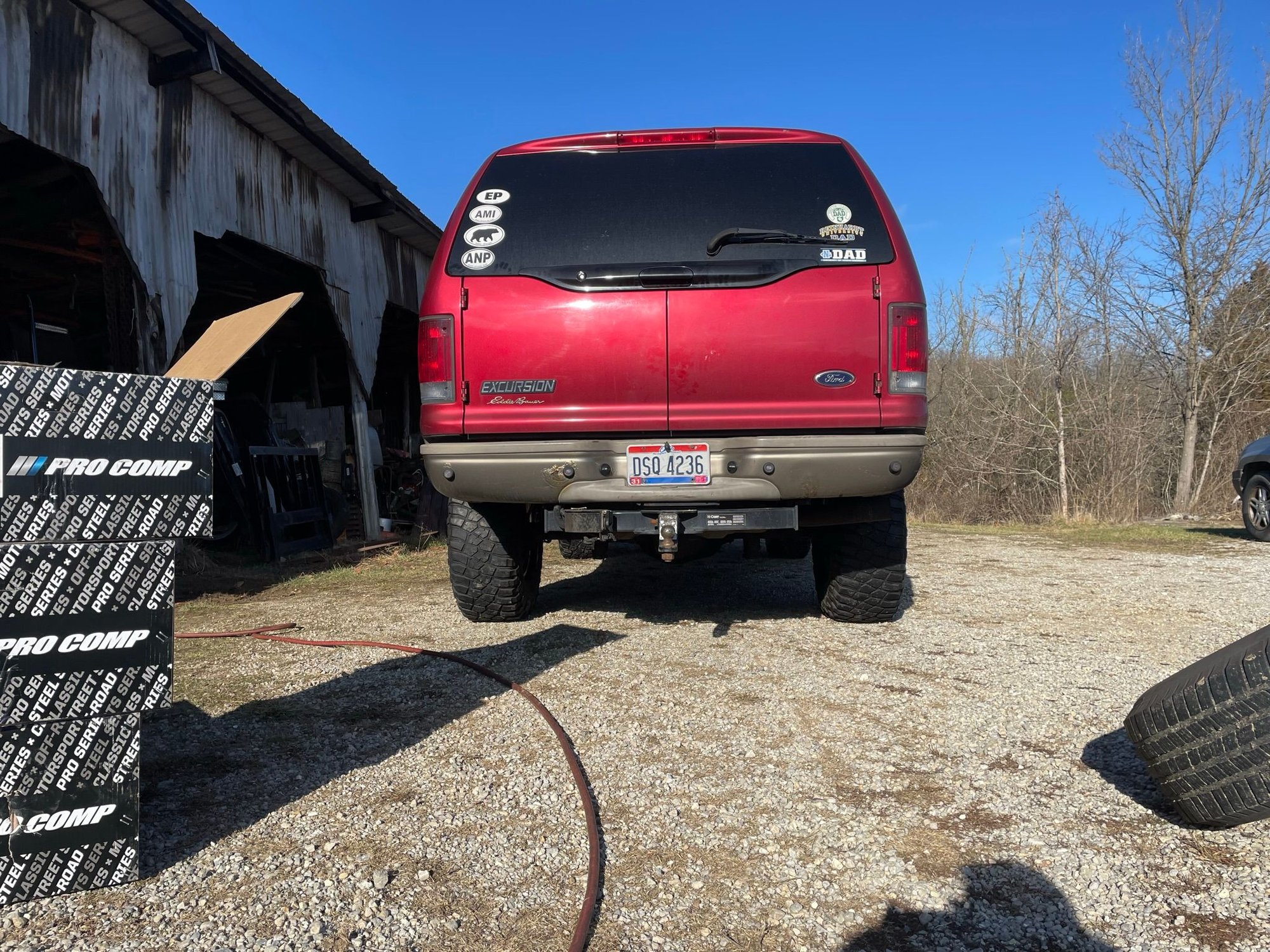

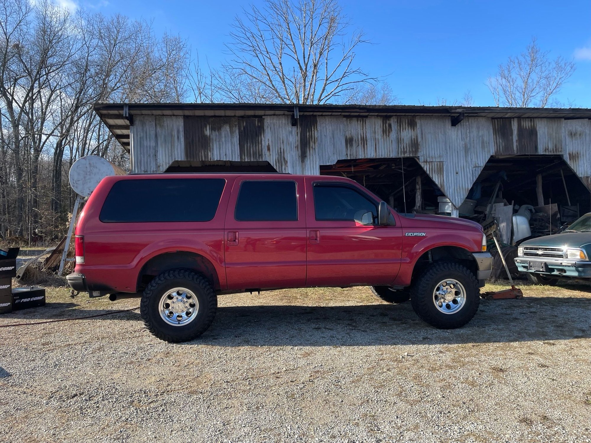

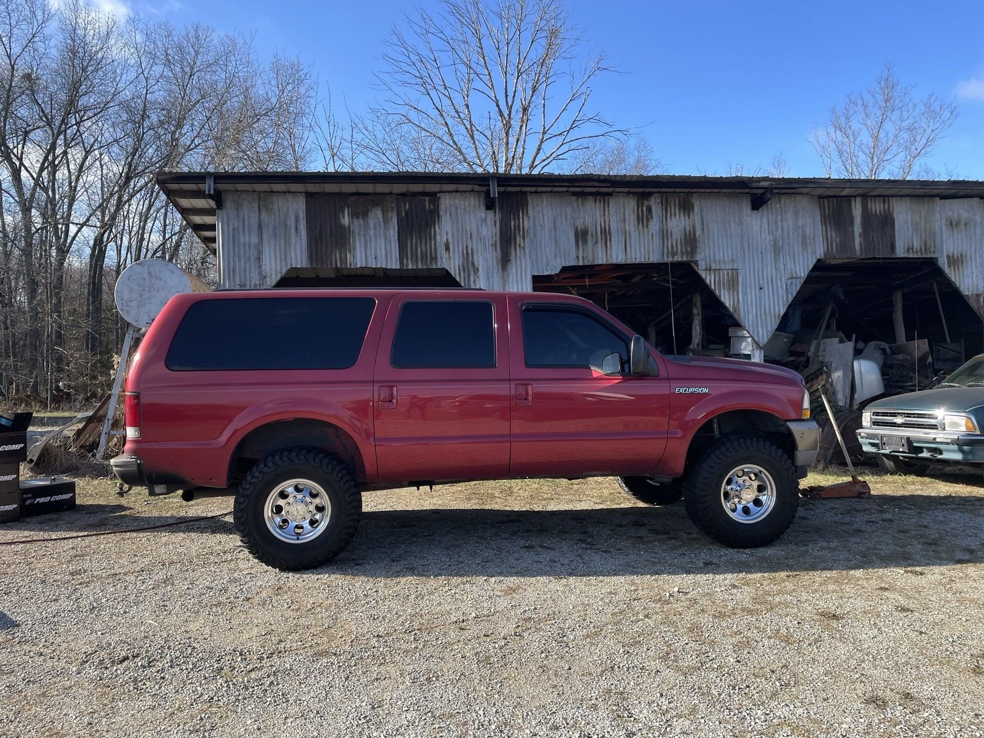

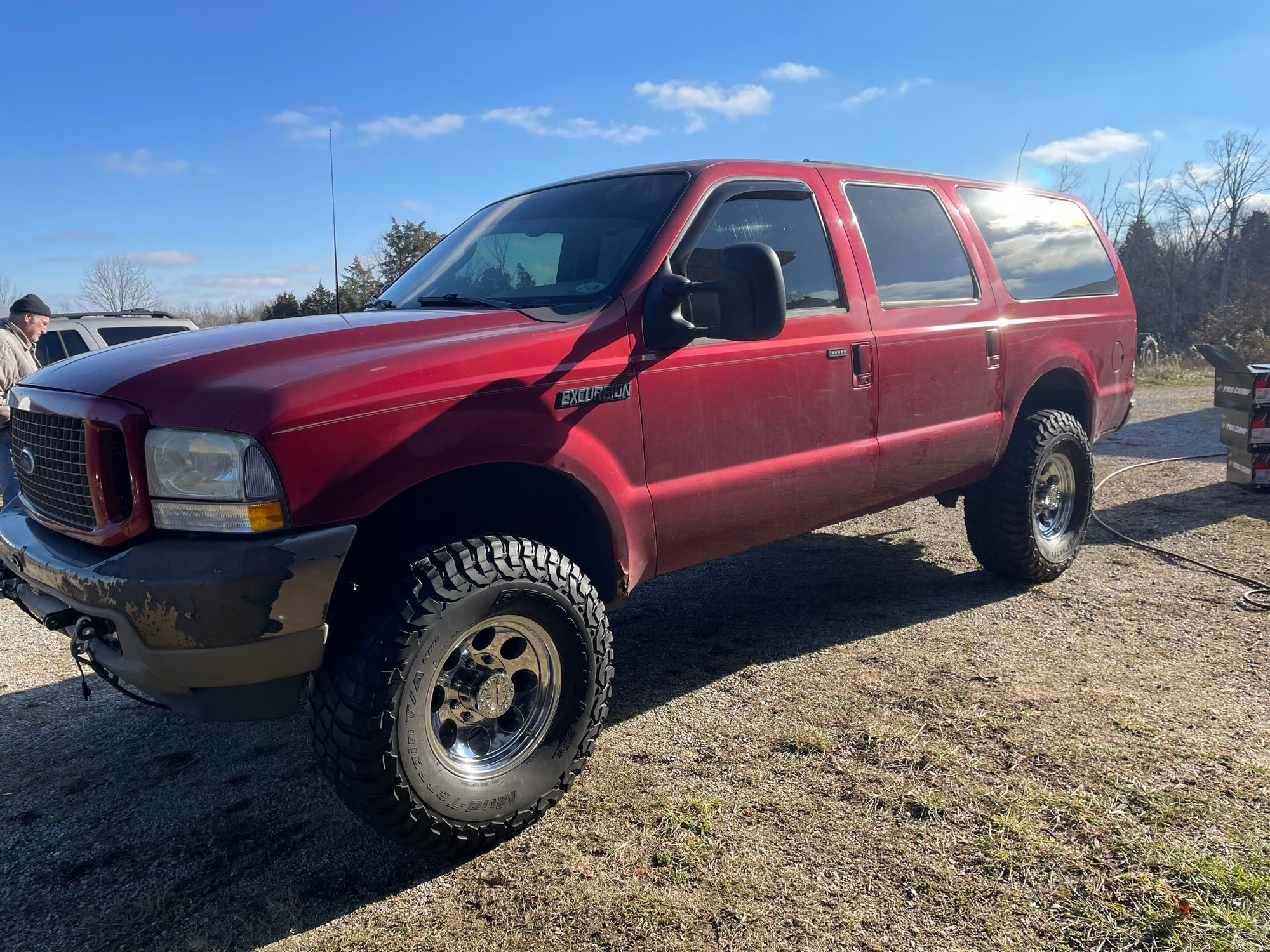

Dove into the deep end…finally. And couldn’t be happier. 37x13.5r17. They are a bit wide and I do have to be careful when turning so I don’t get into the springs. A little trim off the bumper and pulled the liner back. I don’t care much for the zip ties, so I may try and come up with something a bit different.

Thanks! It's really starting to grow on me! Just a few small rubs this morning turning into/out of driveways. Made the 180 degree turn from the lane to my parking spot at the office with no issues. The tires are a bit noisy, but I can just hear them over engine noise, so not a big deal. Also, I used the balance beads in the tires and at 70mph, she's pretty smooth. I do have a tiny bit of steering wheel shimmy, but again not bad. I have to use Waze for speed right now as the speedo is obviously off. all the way up to about 50mph, it's 5mph off, goes up from there. Turning fewer RPM's at speed.
