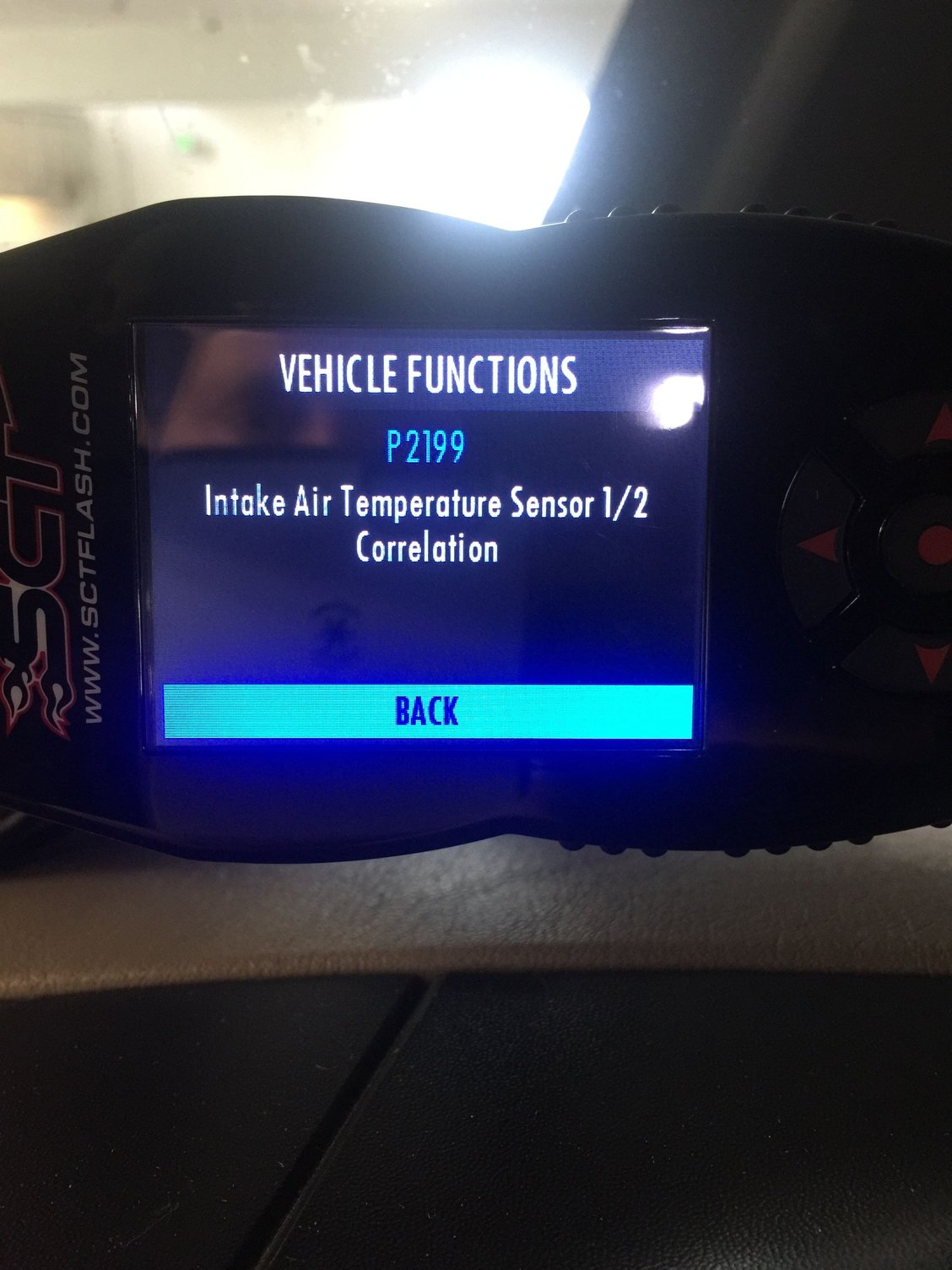

Also this just poped up along with a check engine light

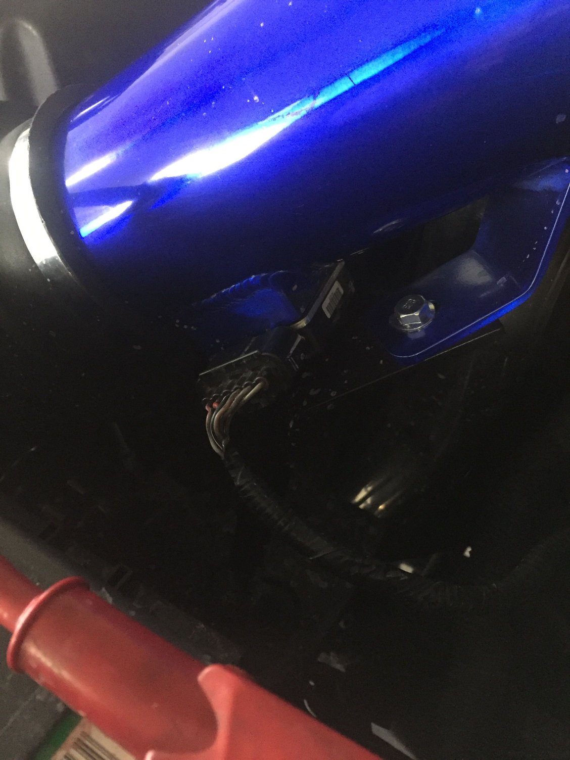

Posts: 39
Would it be this sensor?

P2199 could be the sensor is screwed from coolant exposure.

You can tell it's studded by simply popping the hood, which we know you can do since you took a pic of a blue tube.
I would also be sure it's not a crack in the degas bottle, or warped cap surface on the degas...it's not unheard of.
Like Jack said, try a cap first but look for leaks elsewhere, I'm betting like Jack is that the coolant trashed or messed up the IA sensor or the IA2 sensor located on the intake. The IA sensor is part of the MAF IIRC

Im going to get a new cap and a IAT sensor and hope that fixes the problem.

IAT sensor might fix the code-but will not fix a puking issue
