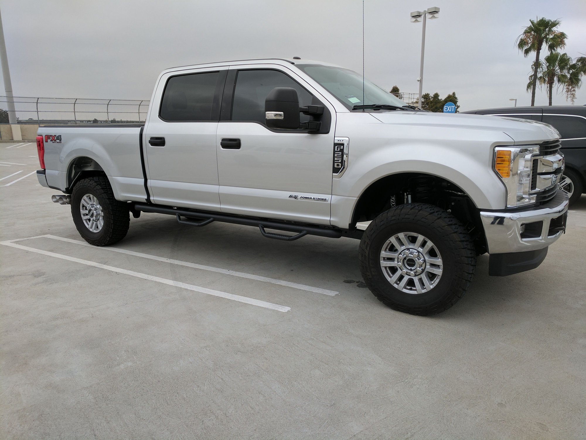

2.5" level on mine, rides and most importantly steers perfectly. Loving it.

The truck looks great! I am really starting to like the look of the factory wheels with these lifts. Which kit did you go with and what size tires are you running?

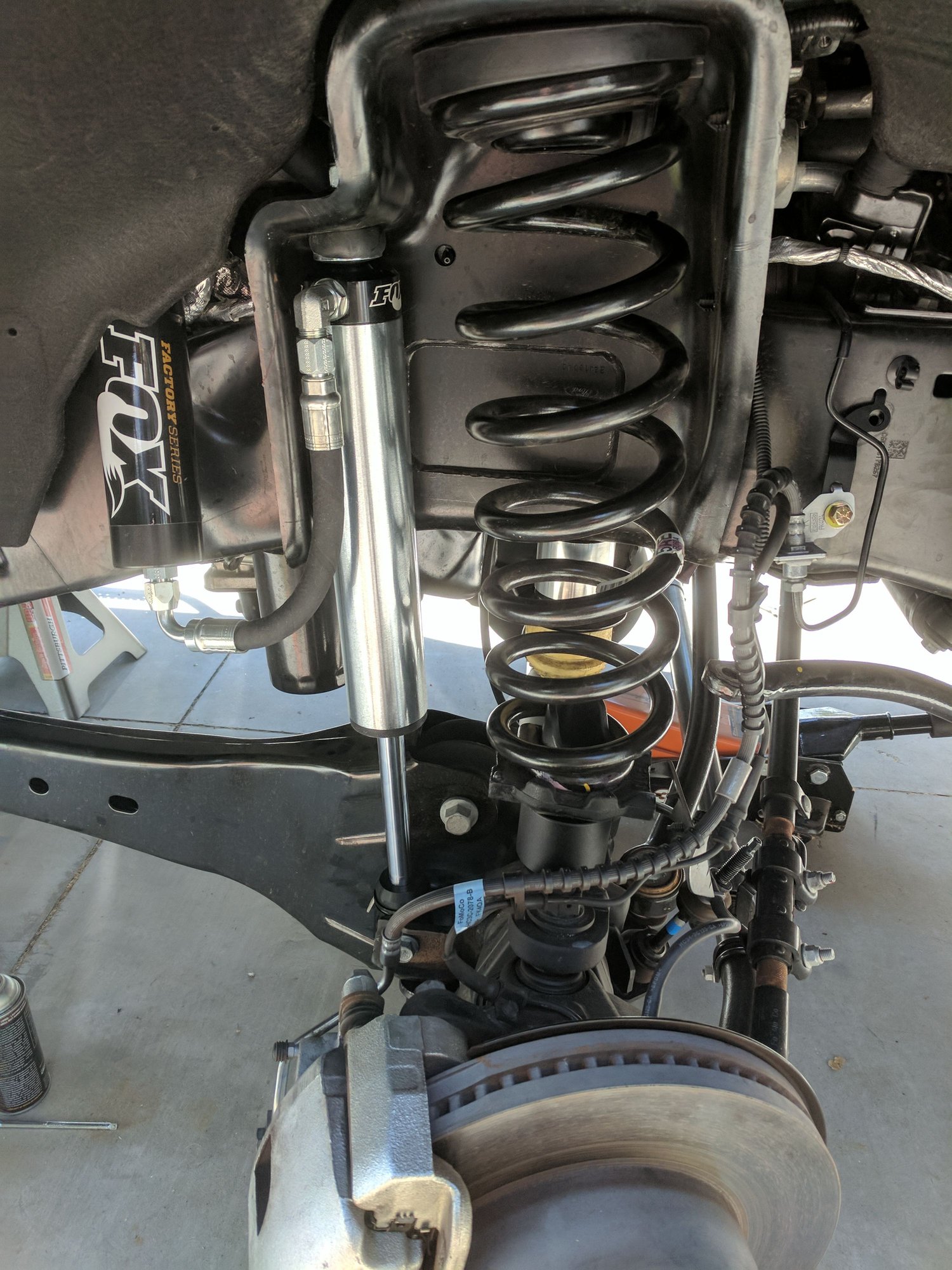

Thanks, it rides like an absolute dream off-road. I kind of cobbled together my own lift. I wanted Carli but they only sell Kings in a 2.5 series shock and I prefer the harder/stronger shafts on the Fox shocks. So I got Carli bump drops, sway bar brackets, caster cams and a RL track bar bracket. Then i bought Fox 2.5s and 2.0s with compression adjusters and had them valved for my truck. Right now the front is lifted with a MotoFab spacer. Waiting on some custom triple rate eibach springs to replace the spacer. So... Definitely not a kit lift lol.
Oh, and tires are 35x12.50R18 General Grabbers. Bought them from Discount tire.com for $850 installed. They fit stock with no rubbing.
