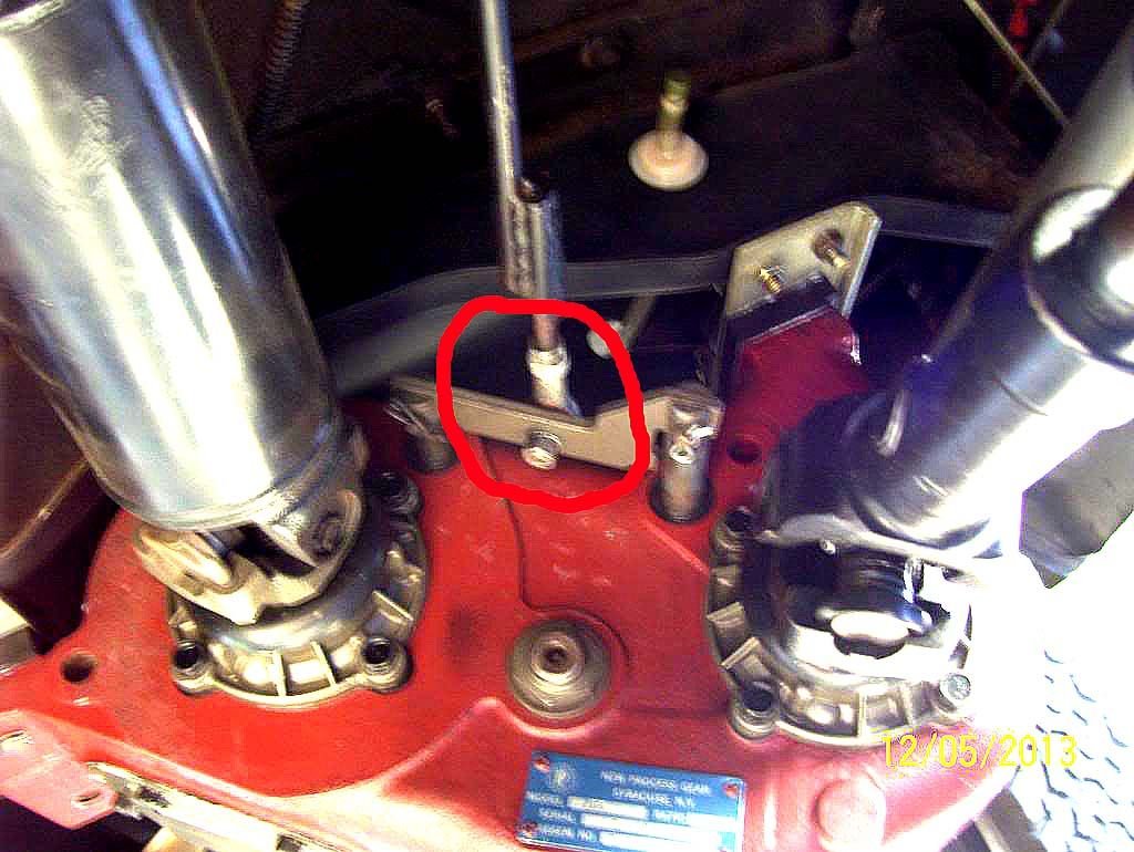

If you've install a 205 T-case you'll need a different cable at the T case.

I am not sure which transfer case it has. It is actually a F350 crew cab 4x4 ordered new by the railroad in Montana. I was told the dealership sent it to Marmon-Herrington for the 4wd conversion. I listed it as a F250 4x4 because the F350 wasn't offered in 4wd until 1979 by Ford. I assumed the transfer case used would have been the transfer case for a 67 F250 4x4.

MH probably used a Dana 24 divorced case just like Ford did, but double check just to make sure that it is not a NP 205 which is different. Never assume things with Fords and especially conversions such as this. If it a NP 205 case, then you might be able to use a 68-74 Econolpne cable which is 104" and the right end at the transfer case.

What is a sure way to identify which transfer case I have? Is there a data plate on the transfer case? It is a divorced case.

The np 24 has a data plate in the side of it.
Where as the np 205 has it on front should be blue like pictured.
