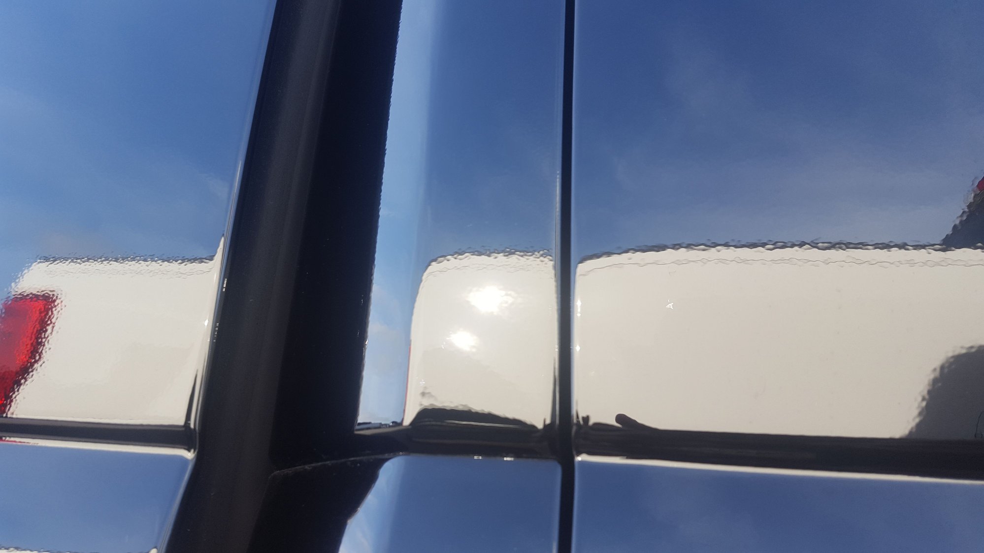

As a painter of 24 years. I would never allow that to leave my shop looking like that. There are a couple reasons it may look that bad in comparison to others the same color.
It was mentioned that a good detailer could possibly fix this. That is true. They would have to wet sand and buff it. The problem is that it is a gamble with factory paint. I have seen some pretty thin factory clear coats. Hell I've seen factory silvers that you can see through. Anyway. Just know that if a detailer does wet sand and buff it. There is no garuntee that there is enough clear on the truck to accomplish this. Some detailer will use a mill guage to judge the thickness. However that only measures the total thickness of the paint, Not just the clear coat

Originally Posted by reseehc_99
I was poking around the dealer lot yesterday and saw this very thing. With the straight line cut off it must have been intentional. I also noticed a fair amount of orange peel on the sides of the truck. Here are some cell phone pictures. This truck is shadow black and the truck in the reflection is oxford white.
Looks like it was done that way for chips and the ability to absorb and hide rock damage.
We used to spray texture then the top coat for the same effect back in the day.
Ford used paint like this for years. Even my 93 notchback is similar.
Yep, that's chip guard. I believe it's slightly soft--which absorbs and deflects damage from rocks, whereas more-brittle paint simply flakes off on inpact. I believe the orange peel effect is a way of hiding the dent created by a rock.

Polishing alone does not level paint (remove all that texture) you can't do that without wet sanding. So unless the 3stage polish you're referring too includes wet sanding as the first step, polishing will not make much improvement.
Exactly.
If my new truck has orange peel, and it probably does, I am going to leave it alone. I am not about to take off material for that show car look.
As a side note, that "show car finish" in a darker color is going to show scratches and wear far more than the orange peel.
