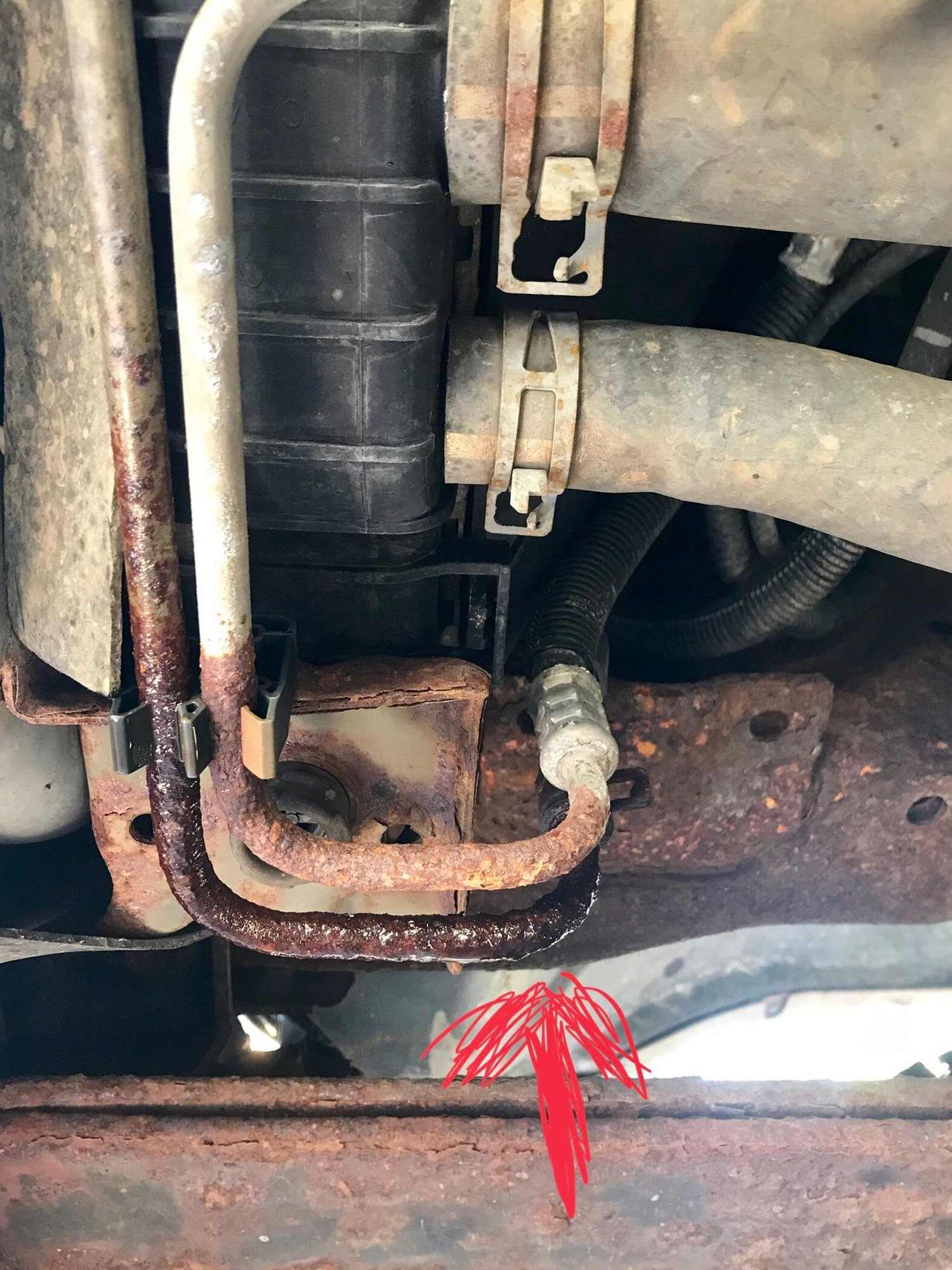

Well it happened. Looks like one of the trans cooler lines is leaking. I went ahead and ordered all three pieces from RockAuto to be safe as the rest of the hard line doesnt look great either. I forsee an ATF shower in my future lol.

Impressive amount of rust there. Hope you're checking brake lines too.
Brake lines look ok, When It comes time to do them, I'll just grab some pre bent lines and tackle it all then.
Finished the job today. All in all not the worst 3 hours I've spent under this thing, RockAuto had good prices on all the lines, I also replaced the spring clamps on the rubber line with regular hose clamps. Should be good for another 100k hopefully.

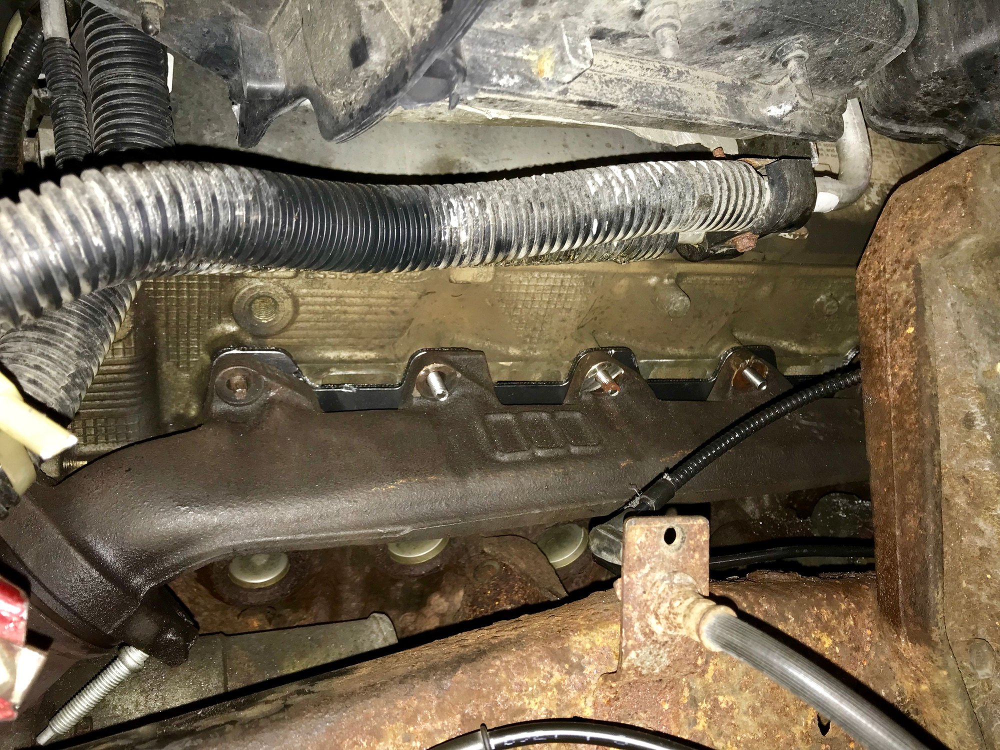

Exhaust manifold studs are halfway done. The passenger side only had 2 studs holding the manifold in place! Rest were either rotted off into the head or simply rusted to hell.
A combo of welding/drilling got them, Also had to lift the motor up off the mounts in order to get a right angle drill in there. I am super thankful that I decided not to tackle this work myself,. It would have taken me weeks on my days off to finish.
The left side still remains but it only has 2 missing studs all the way at the back so it should be an easier time.
eBay stainless hardware and RemFlex gaskets are pretty nice.
Some bad photos below:
Poorly focused snap of welding onto the front two studs:
Manifold was in surprisingly good shape:
Drilled stud carnage:
Going back together:
Sounds 1/2 quieter now...
