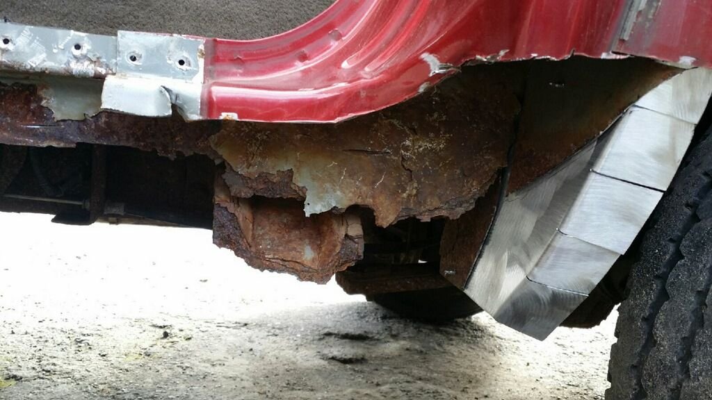

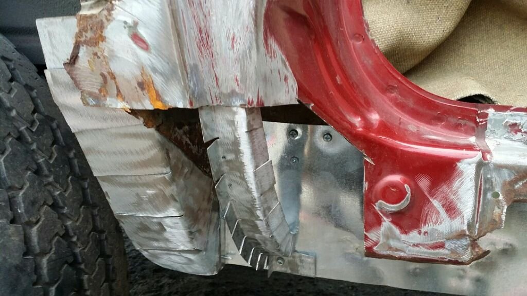

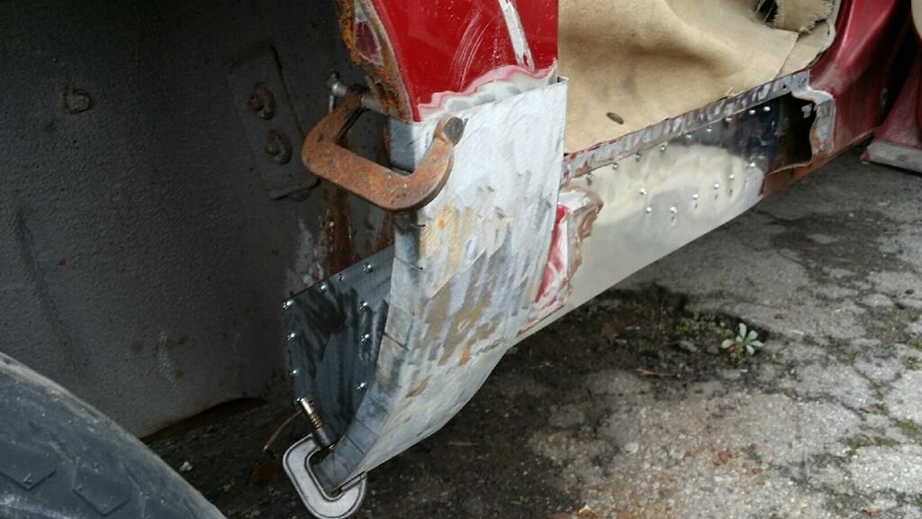

Started taking off the running boards and sizing up the level of work to be done. Funny enough the rocker panels/inner rockers/supports are all fine from the back doors forward, even the rocker seam is good... Go figure. Will be making a patch panel for the dogleg area behind the doors and probably welding in angle iron to the inner rocker panel for running board mounts. Since the old boards are rusted to hell, I picked up some black tubular Smittybilt nerf bars to put on.

Have been working on this truck slowly with a buddy(mostly him since I don't have time) and its slowly coming along. Some photos of the right side below. Still need to finish the left side + body work + paint and lambast the whole underside with some undercoating/seam sealer. A lot of work but she's getting there. Hopefully will be ready just in time for the snow to hit...
Photos are a little out of order but you guys get the idea.

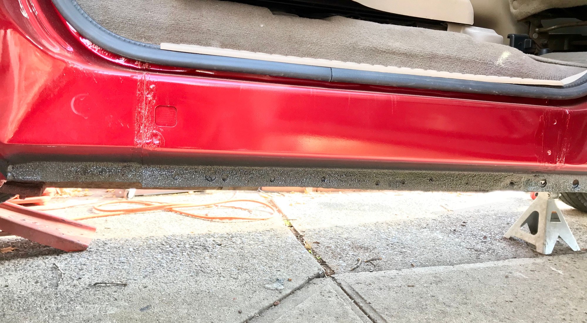

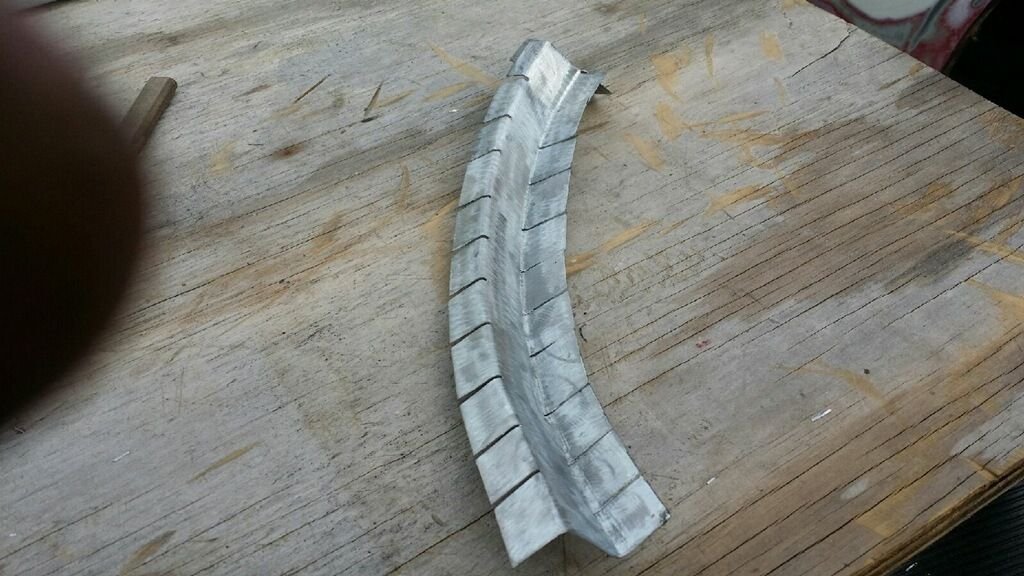

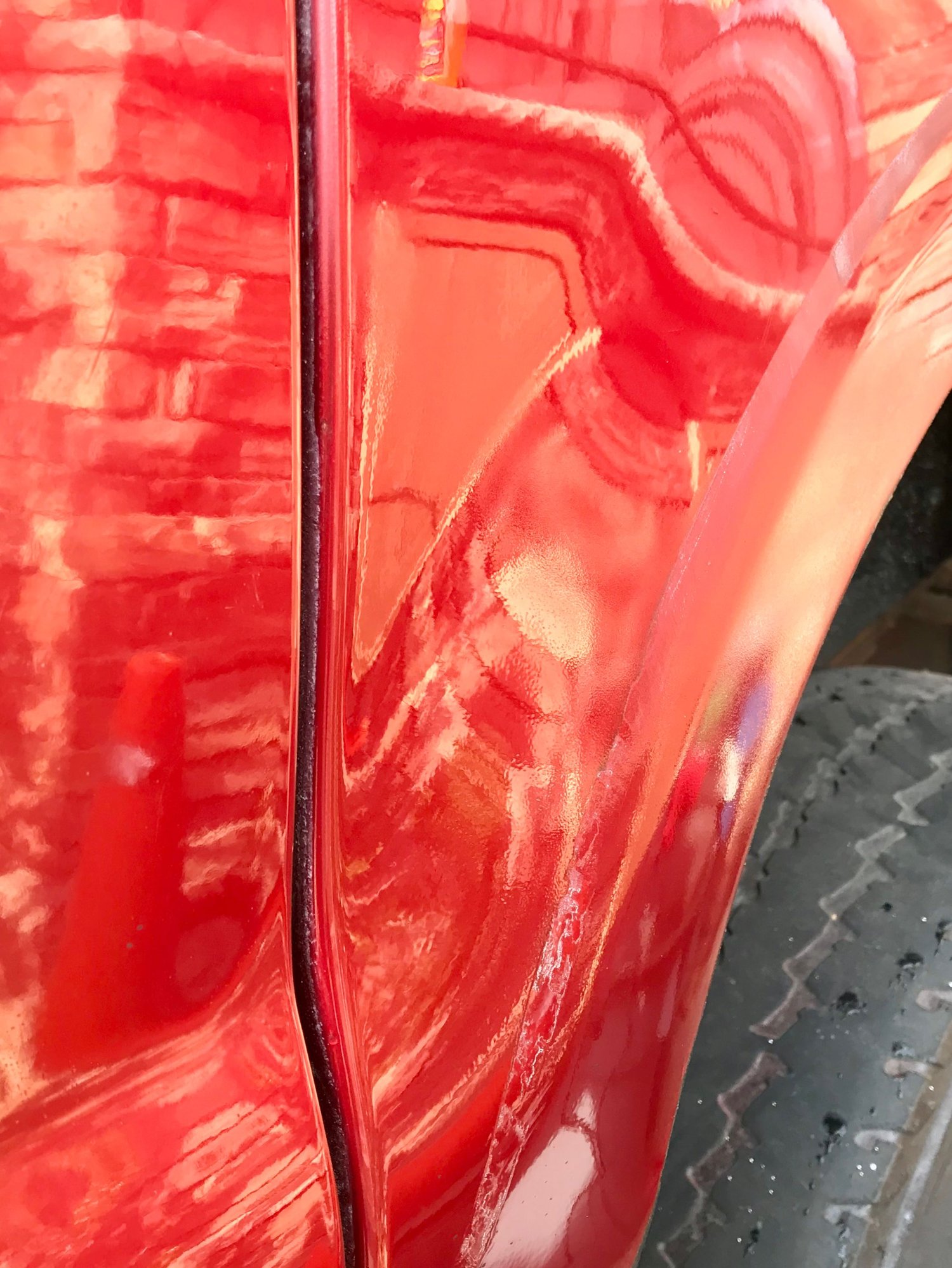

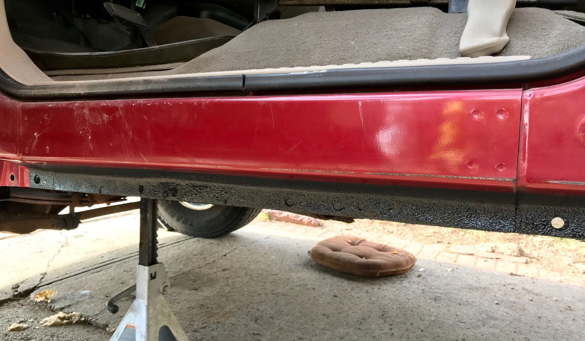

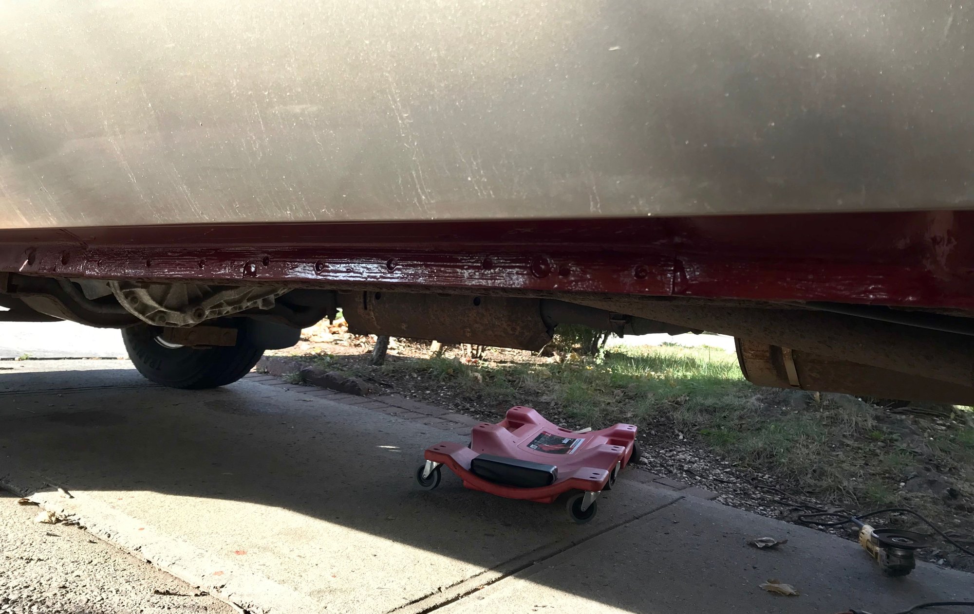

Did a lot today. Flap disc/wire wheel/wire brush/scraped the rockers and repair section under the truck. Applied some rust converter, then blasted some Raptor UPOL on the affected areas and wheel wells to pretty them up a bit. Also polished out the color blend on the left side of the truck. The right quarter will need to be wetsanded and cut/buff'd another day. Then I moved on to mounting the cladding, made sure to use all new hardware. Had some challenges as the newly built doglegs are not quite the same EXACT shape as the originals but I made it work. Still missing the left inner rear fender liner and the SUPER DUPER rare OEM FoMoCo mudflap, as they were victimized by an exploding General months ago.
Also redid the axle vent tubes since they were brittle and rotted, nice to have caught them just in time.
Made a laundry list of the exhaust parts I need to order, why do I always get an Ex with a blown/rotted pipe between the cat and the muffler??? Lucky I guess.
Did some more light work that I'm forgetting now, anyhow, on to the photos...
Rockers before bed liner:
After some cleaning/sanding:
In progress:
Got most of the heavy scale off, this was pre Rust converter treatment:
Gave the rear arch some love too:
Post Raptor UPOL application, LOVE this stuff!
Wheelarch looking nice and BLACK!
Weird "in progress shot" of polishing/sanding the blend area on the dog leg:
Cladding installed, had to REALLY work to get the 3M tape to stick on there.
Also did the drivers door while I had the chemicals handy.
That's enough for one day!
