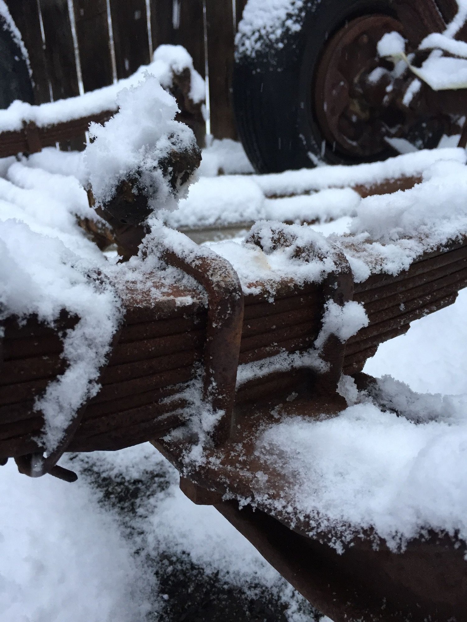

I at first thought that maybe there was a wedge under the spring pack. Now I am not sure what an axle wedge is. And then I couldn't see much since it is snowing again.

I just looked again in my operators manual and there is a castor wedge. It doesn't have much of an angle. I can see a slight angle in the bottom piece in the spring pack that I have pictured. I will measure the difference in front and back and the length.
