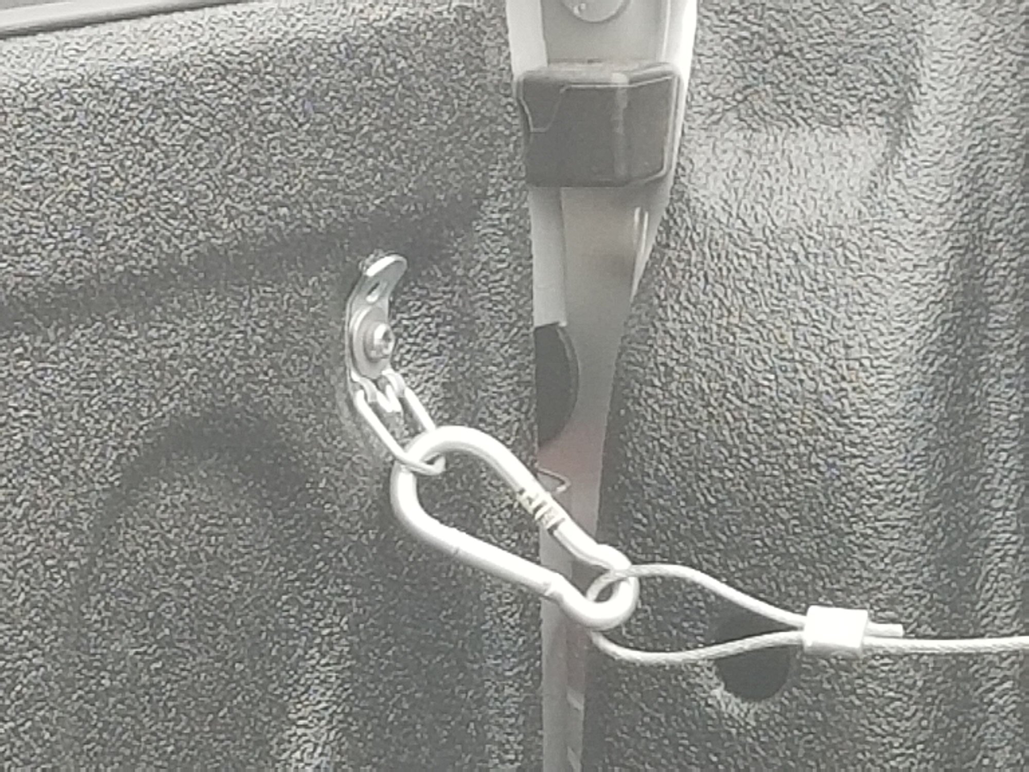

My tailgate has not opened by itself.. But just in case
