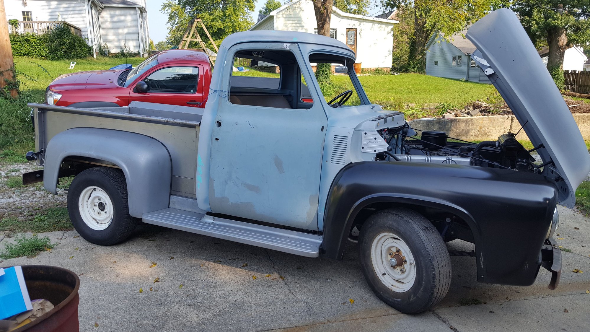

I messed around with the original hinges for days trying to get the hood to lay flush. I finally gave up and got a tilt kit. I used the No Limit Engineering tilt kit that I picked up from Midwest Early Ford out of Ohio. It is on page 62 of their catalog.
http://midwestearlyford.com/CatalogP...%20Catalog.pdf
It only took me a couple hours to do and was very simple. Mid Fifty has a Video in their instructions that helped a lot. I can provide more pics if needed.

The po had installed A front tilled hood on the truck. However, the back corners did not fit right. One was touching the fender and the other had a three-quarter inch gap. I had to fabricate little braces so that I can adjust the corner fitment. Good luck, Jag

Mine had no fit issues after I got the front side properly adjusted.
