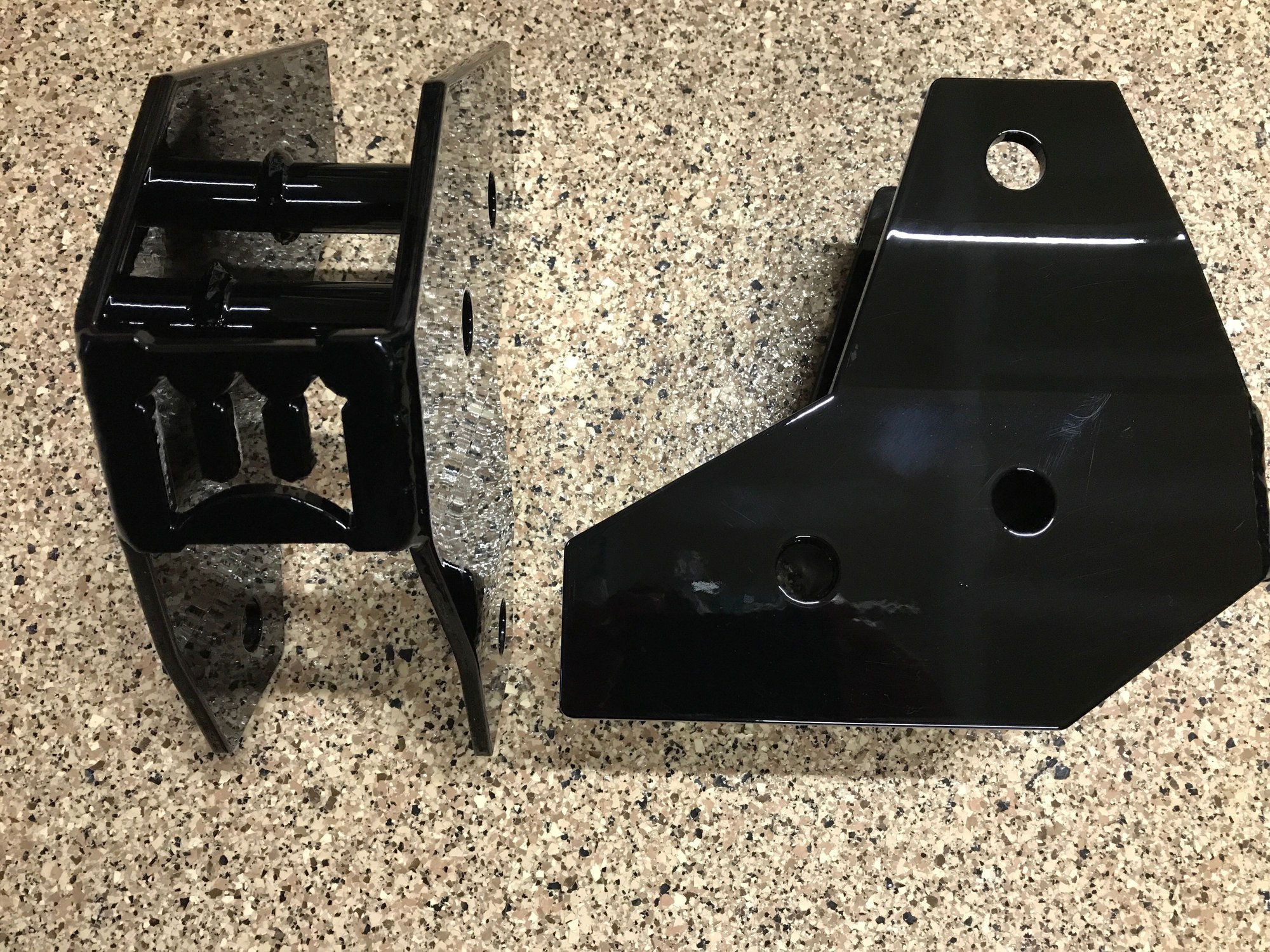

Hopefully I have the solution to my problem. Just got the drop brackets back from powder coat and it's set up for the truck to go in Tuesday AM for the install and alignment.
I forgot how nice of a finish powder coating is.

Those look great. Just out of curiosity.... why powder coat them?

They came raw. Figured I'd try to keep the rust at bay as long as I could and you can actually see them when they're installed.
